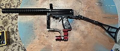

    IMG_4832.jpg The main reason is the max flo setup is big and most common available ones are low pressure version. They do make a high pressure version tho. Shockers run at a low pressure (sub 200 psi) so regs like palmers stabilizer needs internals changed to work correctly at the lower pressure range.

      So a lot of bottom line maxflo s actually had the bottle screw onto it. The red version shown above was uncommon and a later version/option from what I recall.
      They're also a bit heavy, tall, and bulky.

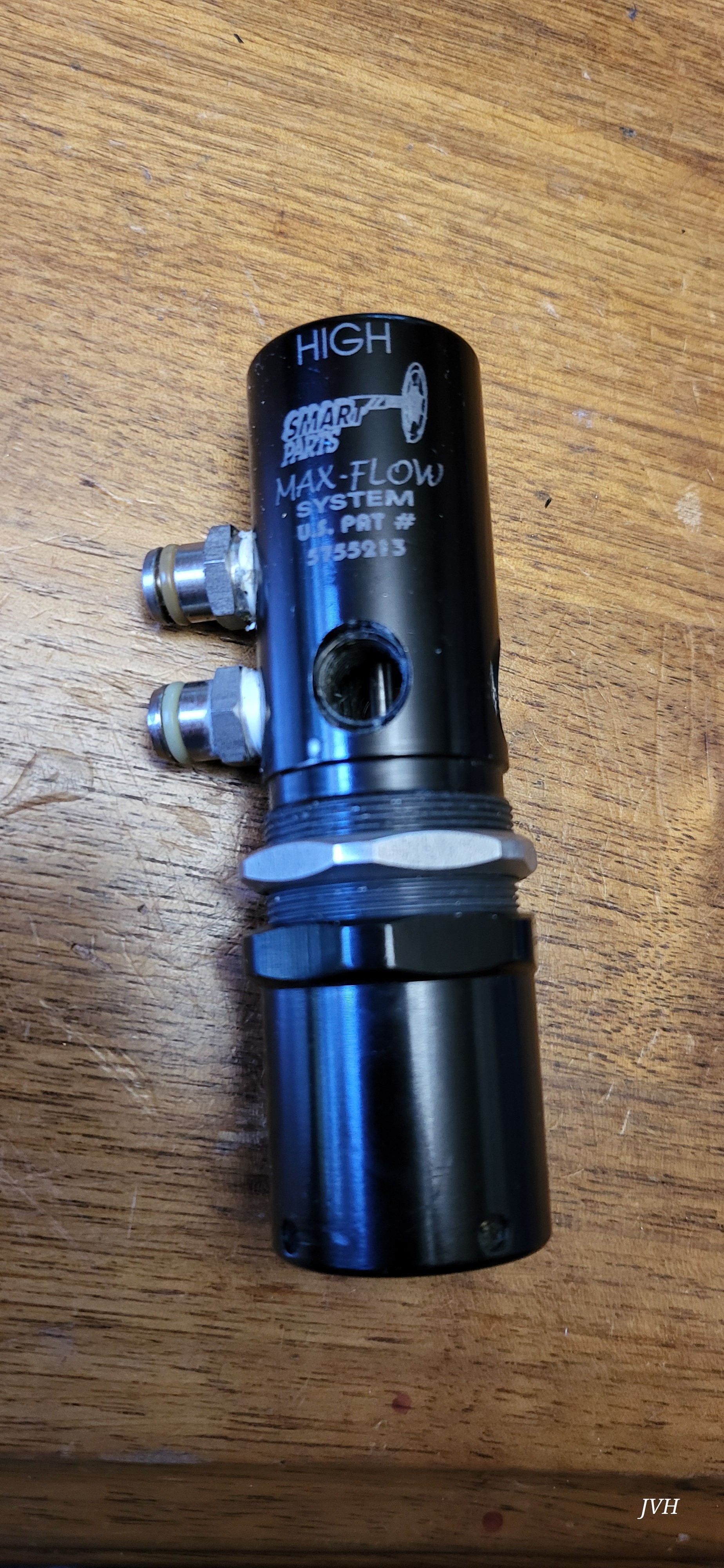

            How can I tell if a reg is a high pressure unit?
            There was a discussion on this in another thread, oddly. Here's my best stab at it.
            Originally posted by Jordan
            I dug through my MaxFlo stash and found my HP Maxie and another like yours, marked 4500. Both have the HP piston, so it's likely yours is the HP version.
            Here's my pictures... first one is the labeled HP version, second picture shows the difference between HP and LP pistons. There are a couple other differences, like springs, but piston diameter is the quickest/easiest way to check what you have.
            HP = small piston. LP = large piston

              Also, not a fullproof way because someone could have switched gauges for some silly reason, but the Gen 2 and Gen 3 HP MaxFlo's have factory pressure gauges that go up to 1100-1200psi. The low pressure MaxFlo's have factory gauges that only go up to, I believe, 600psi.
