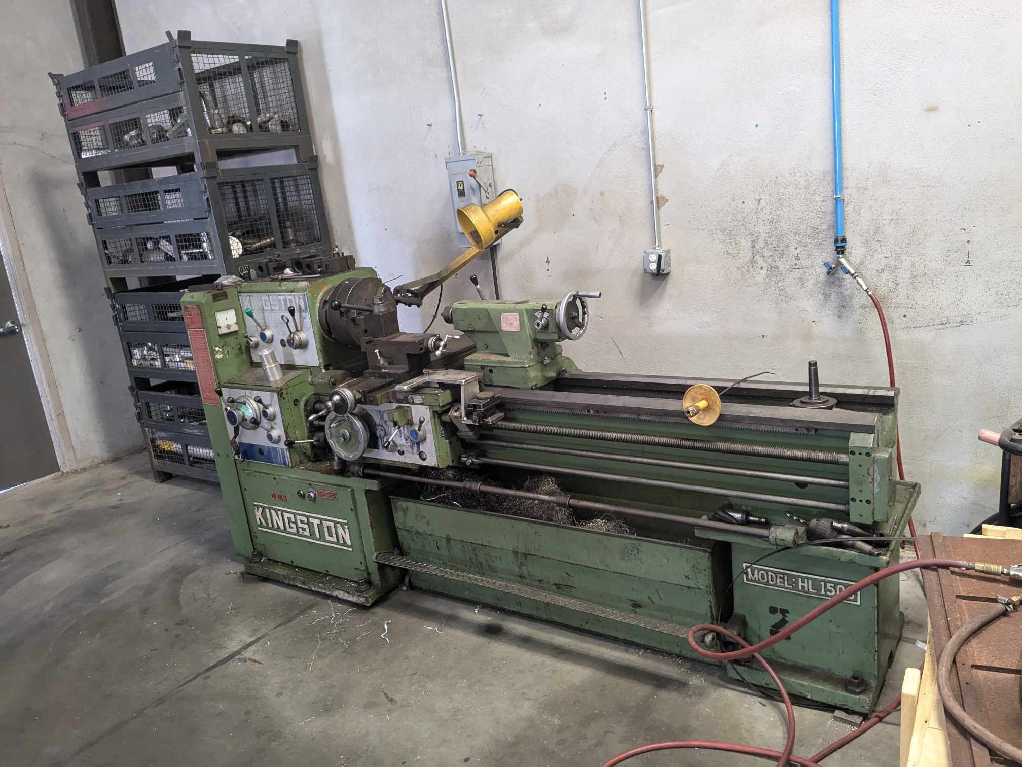

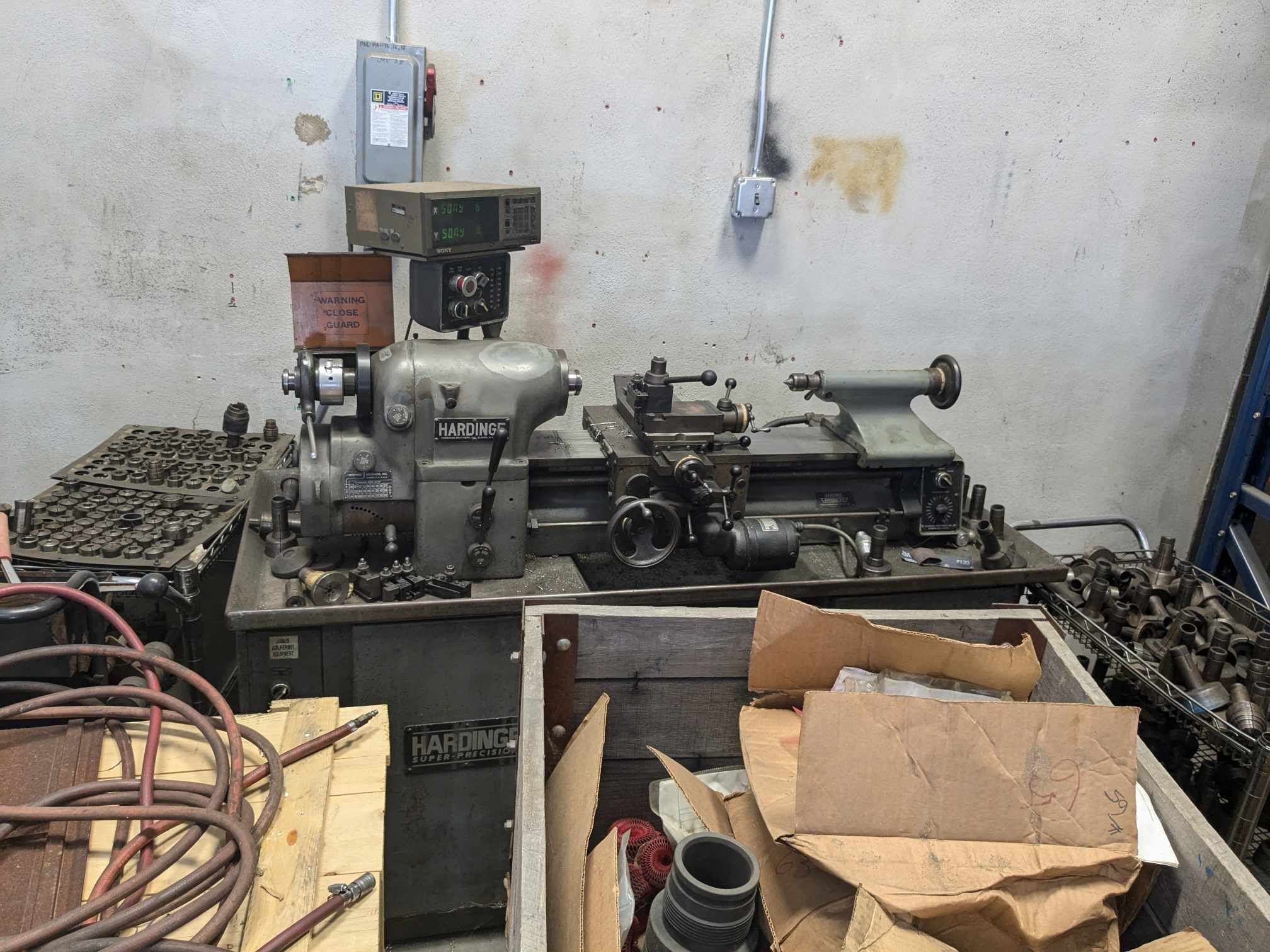

    I recently watched a vid of a guy demonstrating the process. Its pretty damn simple if you have the equipment.
    Our shop has a couple manual lathes that rarely ever get used. Maybe afew times a year for a rework job.
    Think I will pick up a couple barrels locally and try it out for myself.
    If it turns out good maybe ill just leave the machine setup and possibly randomly run barrels and sell them. Probably wouldnt want to take orders due to liability if I mess something up like the finish.
    Just need to get the tooling and some freak inserts.
    I assume going XL will be the better option but might be dependent on barrel type too.
    Im sure there are some variables I need to figure out. Even if i dont sell them i can always just run some for myself and friends.
    Anyone ever do this before?

    Click image for larger version  Name:	462545632_879282317671755_1519698454951313507_n.jpg Views:	0 Size:	268.8 KB ID:	606296 Click image for larger version  Name:	462547821_1580109876213456_3248952623029067868_n.jpg Views:	0 Size:	299.8 KB ID:	606297

    There are a few of us who do it here. If you have some basic manual lathe skills its pretty easy. Holding concentricity on a freak XL bore is way more tricky than a normal freak. Start slow and you'll learn along the way.
    I'd recommend hitting the barrel will a boring bar before using a reamer. The reamer is doing a little too much work in that video. Rule of thumb for reamers is 2% of the dia. 18.8mm = 0.740 reamer so 2% of that is 15 thou. He is cutting about 3.5x that amount. The reamer wont last that long and surface finish will suffer a bit. Granted its only a $20 reamer so send it. No harm no foul. It gets the job done.
    It is a lot of fun so get some junk barrels and turn away.

      Yeah, i will be having our engineer who is a really good machinist help me along the way.
      Hes a really smart guy so he will probably give me advice similar to what you just explained.
      This will be something fun i can mess around with while im also rebuilding my Autocockers.
      And yeah i figured the XL would be more a pita. Ill stick with standard.
      Thanks

        I have a manual lathe, like your second one, in my shop. I need to horse more crap barrels and figure out how to do this.
