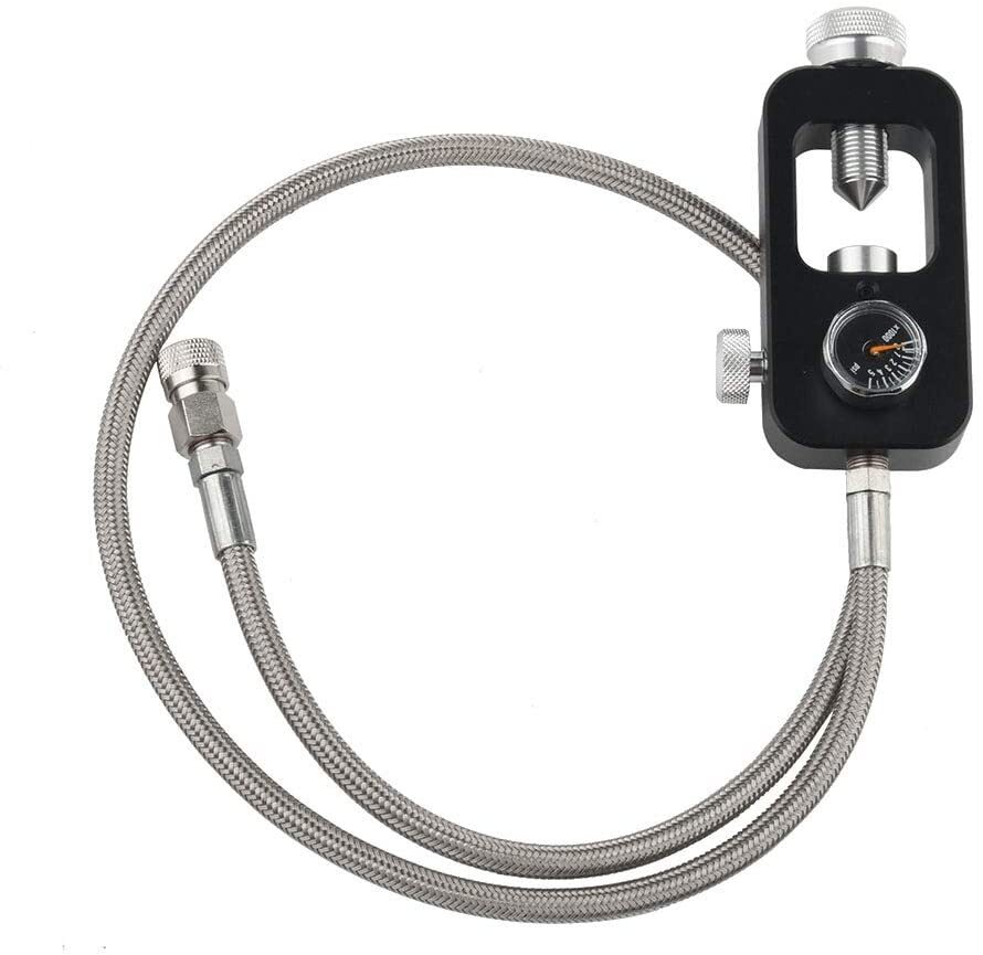

            Should I get this too?
            • Grendel
              • 1980
              • Lexington, SC
              Are you planning on filling Scuba bottles? If so you will need something like this but if not I'd say no.
