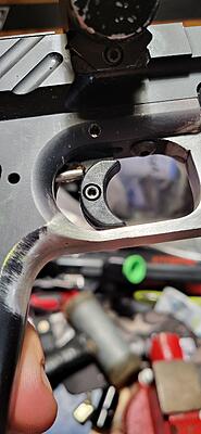

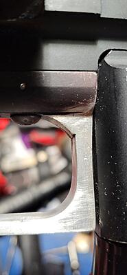

    • 3394
    I did a trigger guard. I used 4000 series filler as it's all we had, but it'll be 2x small patches as I cut nice fillets for my buddy who did the burning. I was told those spots will just anodize black no mayter what you trym I haven't attempted to anodize it yet, but I just figured I'd request an acid wash or something to hide the defects once it happens.
    It'll likely go to KMDPB to anodize lol.
