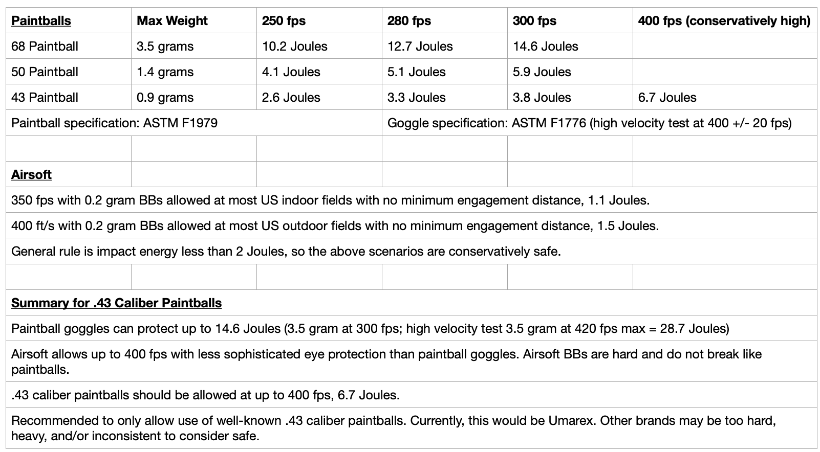

    Thoughts on these? See the picture for some thoughts I jotted down. Intended to be notes and talking points. I want to make sure .43 caliber paintballs are safe, so please prove me wrong if that's the case. I think I've seen a couple videos where the first few shots are in the 380 fps range.

    The .43 caliber paintball pistols are designed primarily for Law Enforcement training. The T4E line is designed for this specifically. "T" Training "4" For "E" Experience. Their markers are exact copies of common pistols used for LE. They are used in live fire training, and are therefore designed to be non-lethal. Yes, the 43 cal paint breaks on contact. That said, they fire well above 300 fps and are not velocity adjustable. I do not recommend them for game play. The Kingman KT Chaser and Eraser are the only 43 cal paintball markers that are designed to shoot at or below 300 fps and could possibly be used in game play. Given the availability of 50 and 68 cal paint and pistol options, I would recommend against the 43s for regular game play.
    As for your energy chart, although being correct in your calculations, reality is a different beast. Insurance companies and field personnel can't be bothered by math. They need a simple set number that is the benchmark, 280 fps for all projectiles. No further thinking involved.

      Circling back to this. Got permission to use .43 caliber paintball pistols at a local field. The owner checked with the insurance company. Sounds like things have changed. They do go by a joule limit now, provided you're wearing a paintball mask. The joule limit is obviously well under the ASTM limit, but it allows for a bit more than a 68 cal paintball at 300 fps.
      My guess is the much lower joule limits are still in effect for airsoft since the eye protection is less regulated.

            A problem that Smart Parts ran into, when they tried to push smaller calibers as the greatest thing in paintball.... was that the range was terrible at 300fps. They pushed to have the limit raised, but pretty much every insurance company has 300 or less hard coded into the limit. That was a big factor in smaller calibers being left as a niche "soft impact" game

              I found things got squirrelly much above 265fps with .50 cal, so even with a higher FPS, it wouldn't be accurate. Apparently, insurance companies are coming around to joule limits, given proper ASTM face protection, instead of fps limit.
