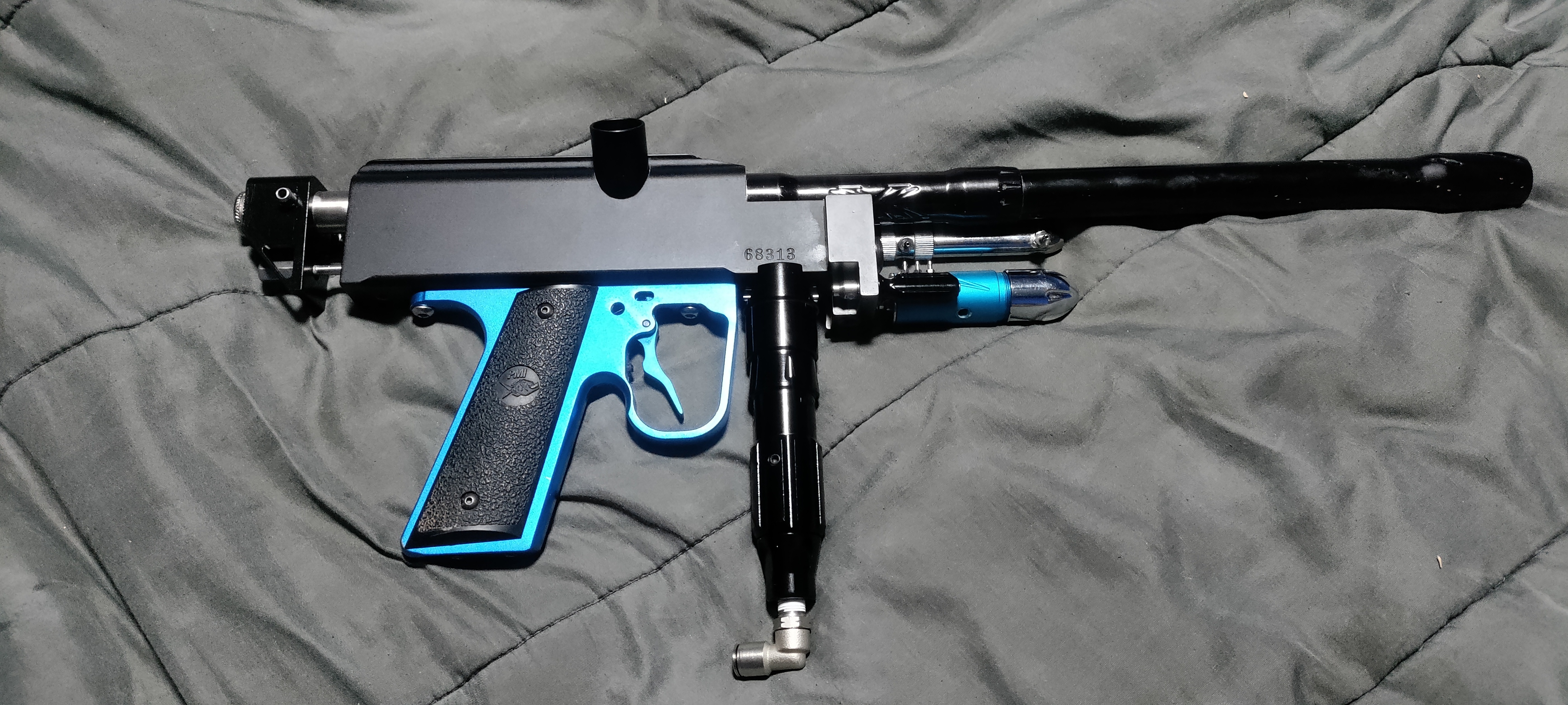

    trying to find one part lead to me pulling everything out of the parts bin then asking myself the question "do i have enough parts to build another gun?" no i dont 2 rods short and no ASA's that fit but this is what all the random stuff i had laying around built

    That ram and lpr look to be psychobalistics, if they work they work but keep in mind that they will probably fail or leak already they were cheap Chinese dye knock offs, if there's internals in it yeah that looks like everything besides the pump arm, 3 way rod, and an asa

      its psycho, came on another gun I had they worked fine but the psycho 3way was the problem

    Another thing I thought about is if that bolt works with that back block, they have pre2k and 2k+, both will fit either back block but the 2k+ bolt will be to short to work and you won't reach velocity or it may not even shoot a ball at all

      its a 2k+ bolt and 2k+ back block. i have a pre 2k bolt that wouldn't fit that block

    Frame is psychobalistics as well
    Order 2 parts and have a spare/sellable cocker. Nice parts bin

      Always fun to find enough parts to build another marker. Even if it's just missing some pneumatic and pump arm you have all the main parts. Used stock LPR and ram are not expensive.
