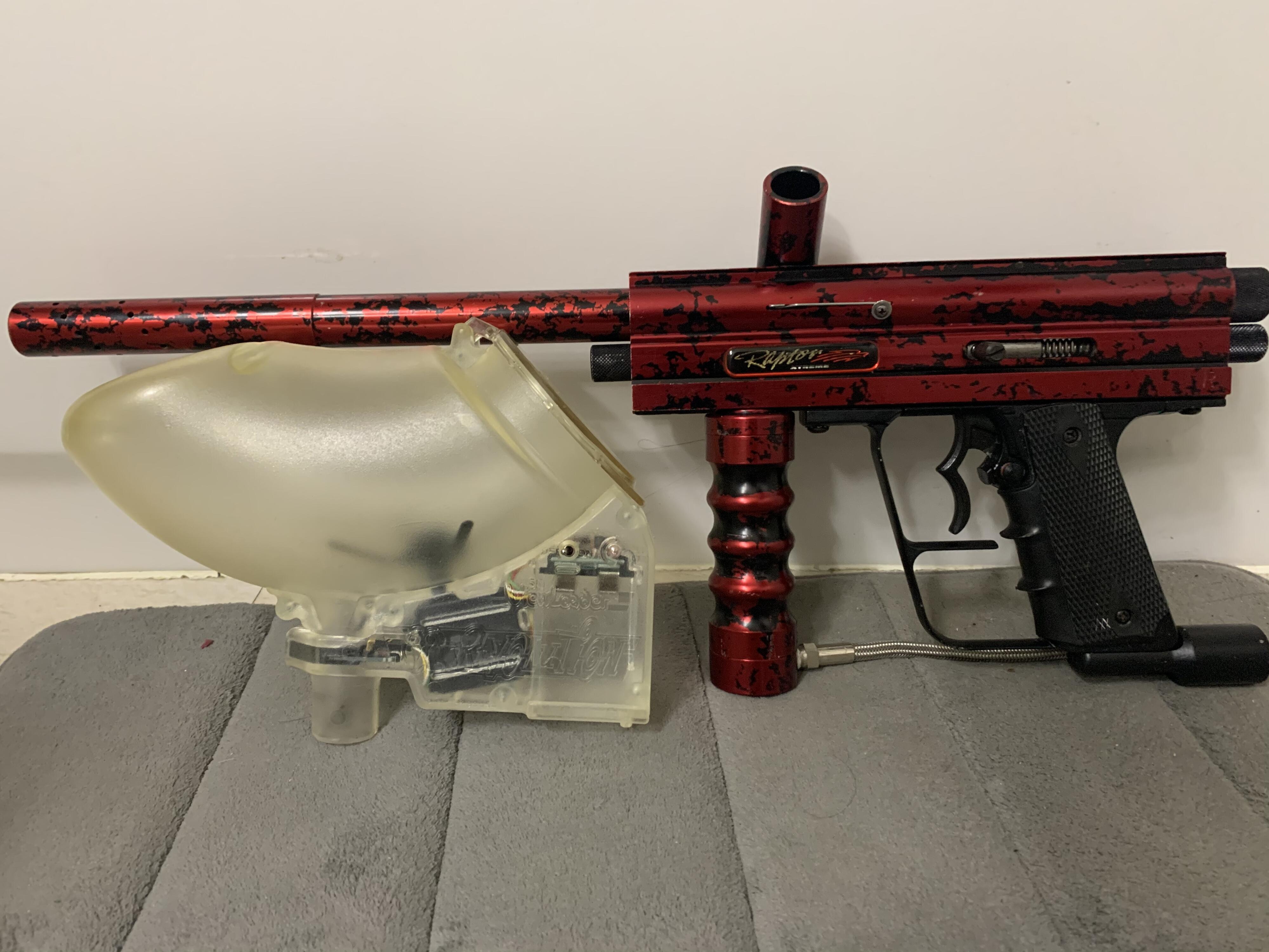

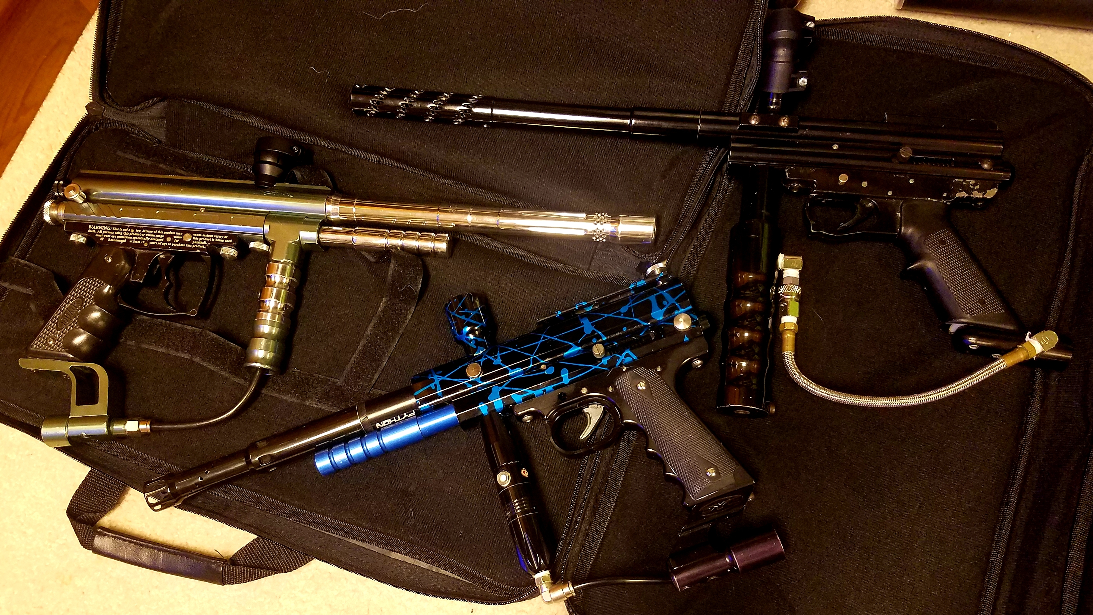

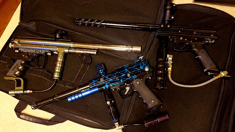

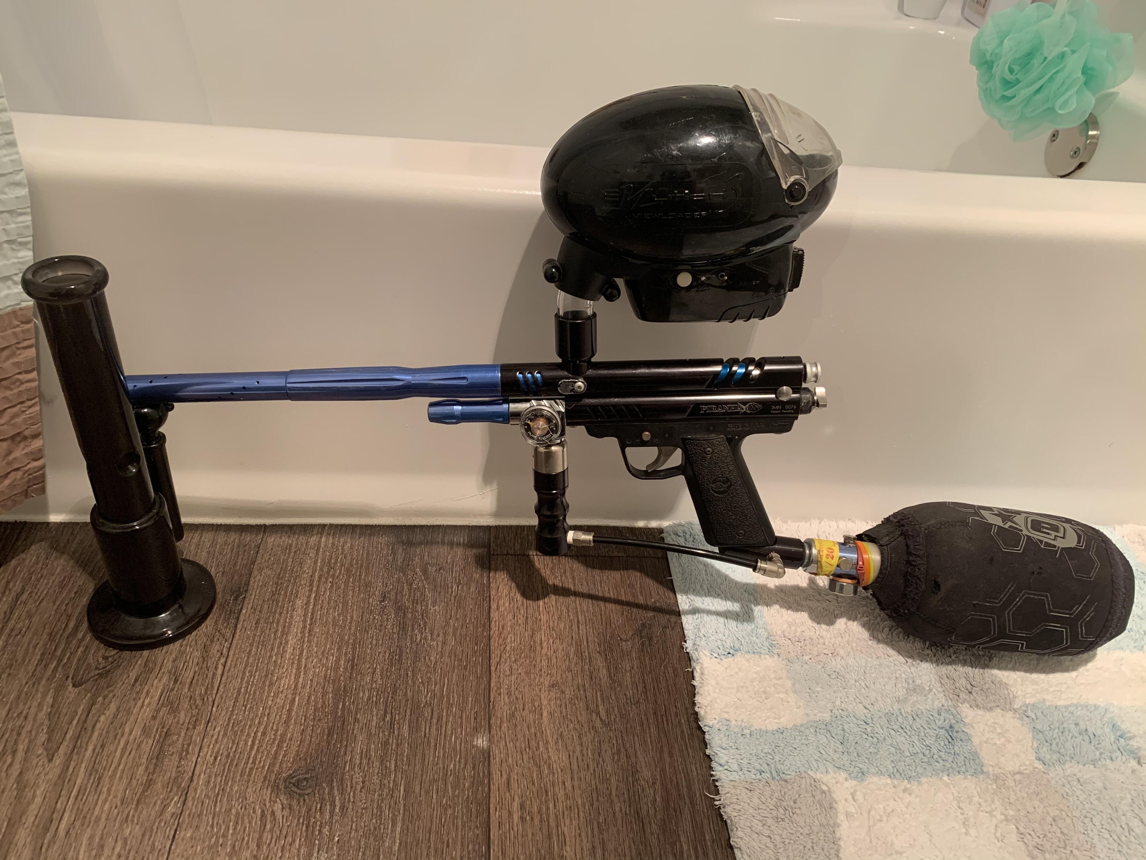

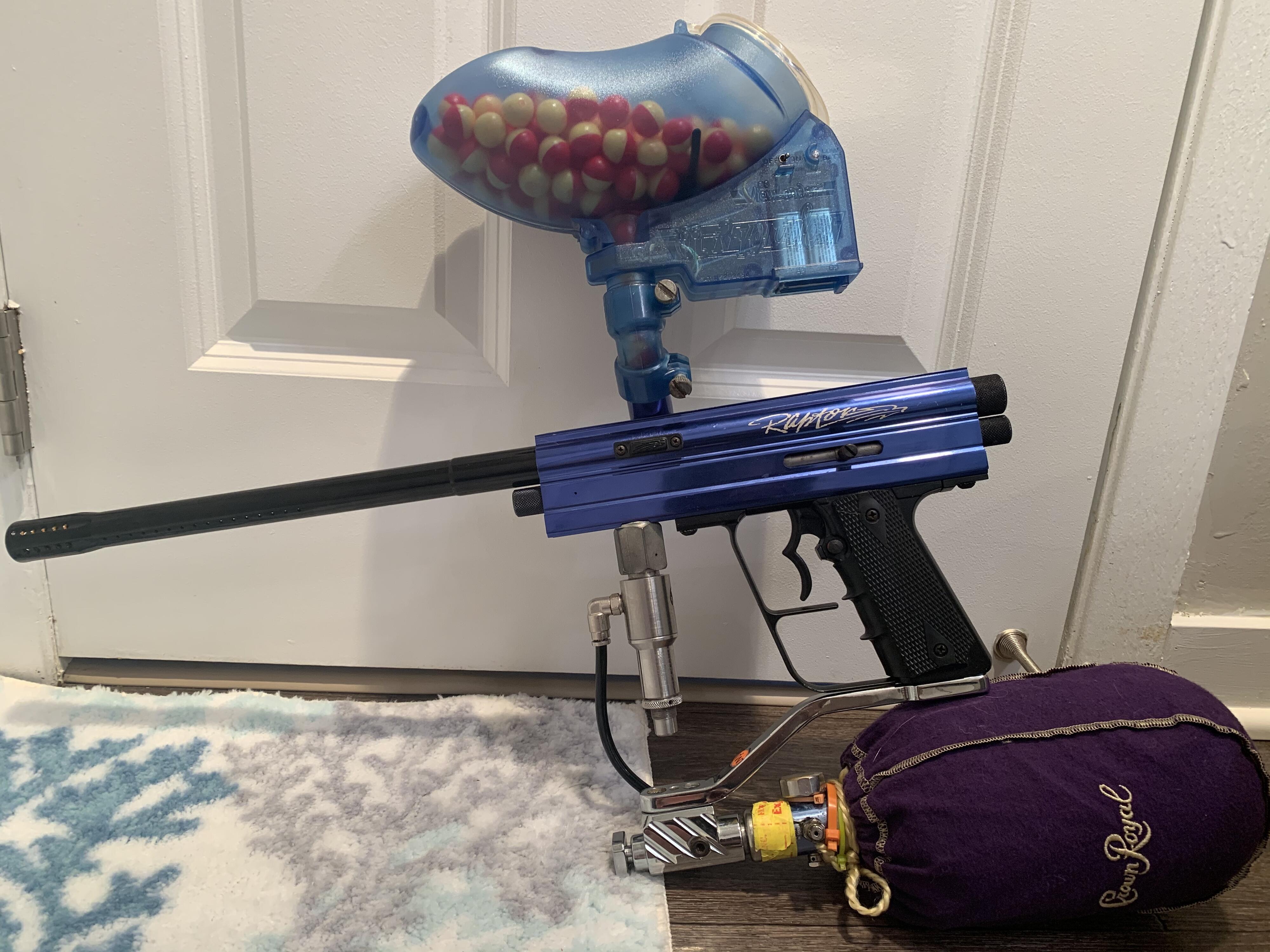

              I like my raptors
              kevin qmto and i still own that piranha, never let me or who i loan it out to at the field down
