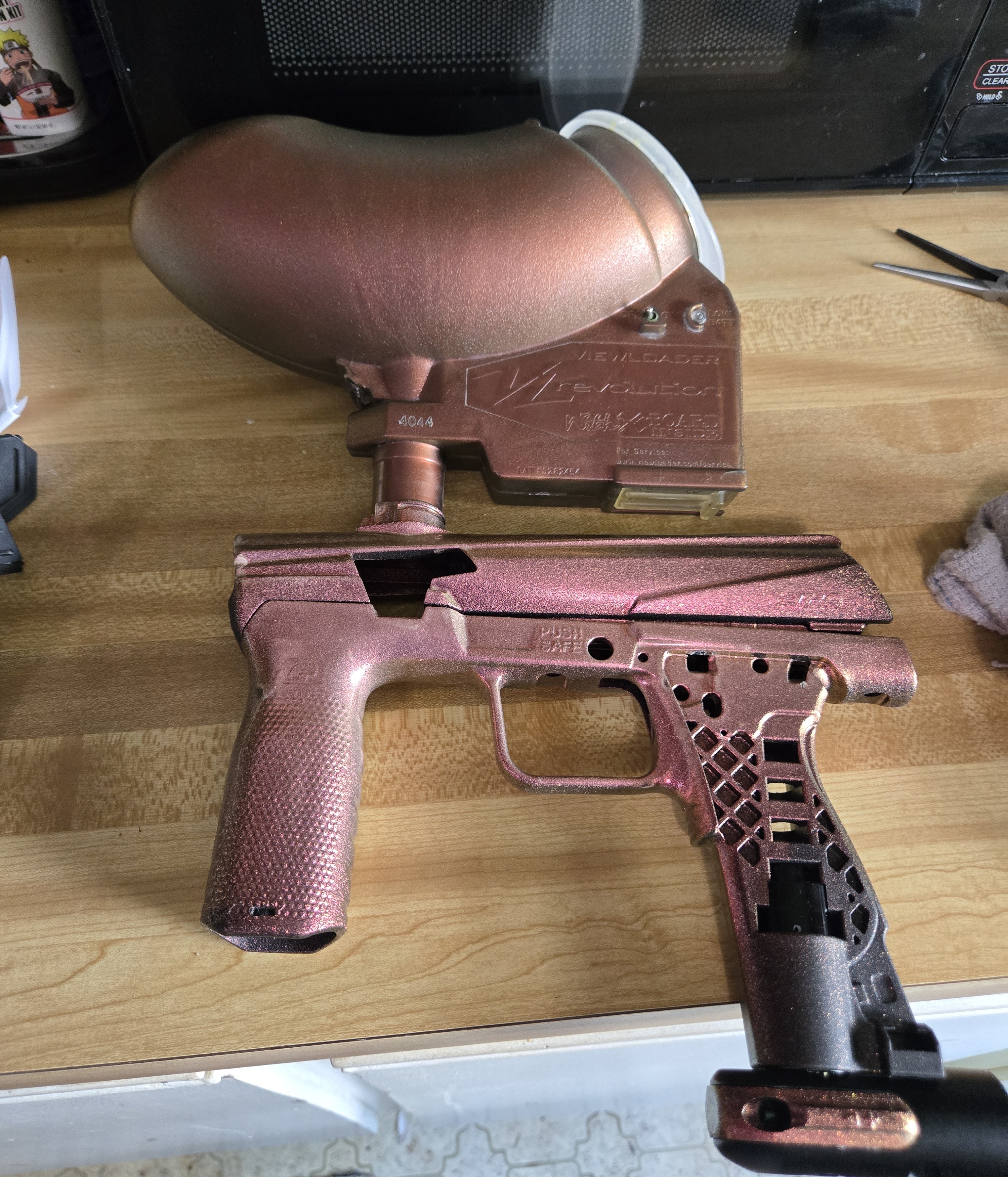

    Painted my Emek to match my Viewloader Revolution. "If ya squint, it's mint"
    Rustoleum Colorshift Pink Champagne, not bad for in a can. I screwed myself at the end of the can, I didnt realize I was spraying more coat than paint, so it washed out white in some areas. Will sand it with 2000 and recoat later.

    I've used the blue green version of that a lot, and it's turned out really well. Here's some tips
    Use a dark primer, this paint really doesn't work if you put it on a lighter color.
    Multiple light coats are essential, build it up
    Use a clear top coat when done, I use Rust-Oleum crystal clear Enamle and it works well

      Trbo323 how long should it cure before the enamel coat? I've never had luck top coating, it always spiders or wrinkles.
      Feedback!: https://www.mcarterbrown.com/forum/b...rough-feedback
        • 6253
        15, 20 minutes
        Again. Light coats are key
        And then I let it sit for at least 24 hours before handling it
