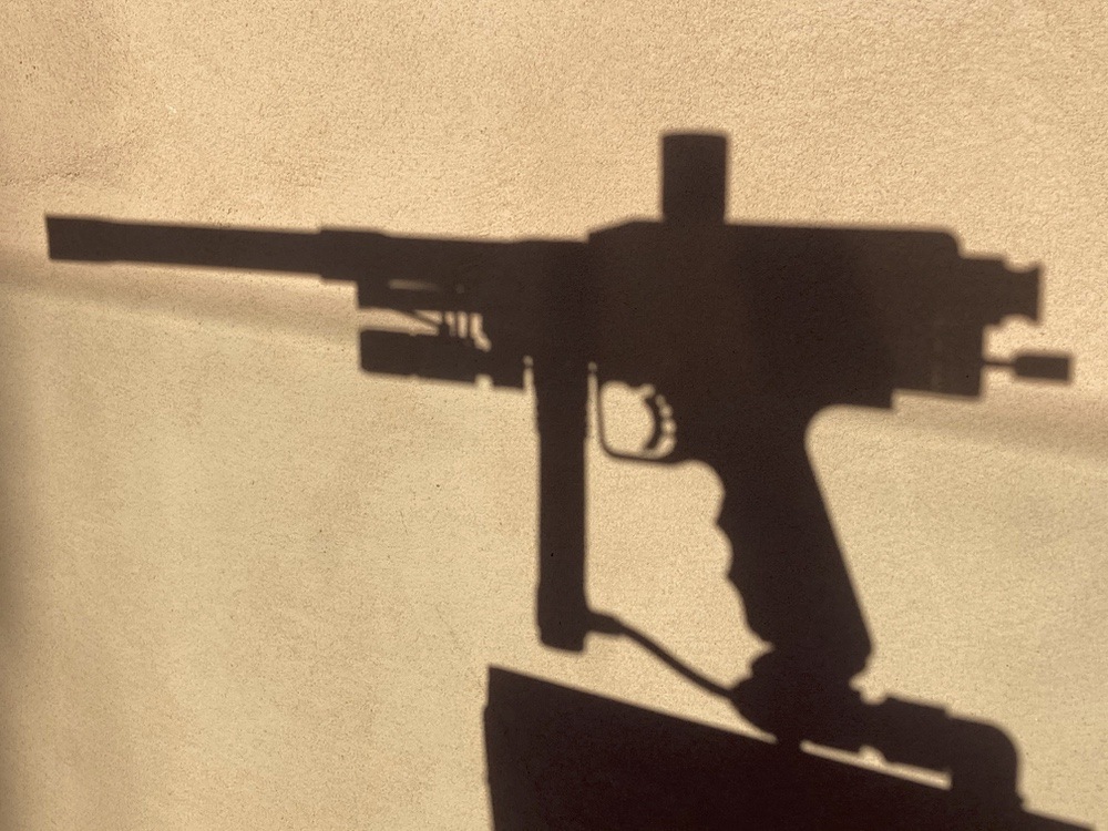

A fun holiday game of Guess the Parts!
  • latches109
    Always Sciencing
    • 2111
    CONTRATS TO Worr13 for winning a Dye DF-20 3-way! Picture on post #12
    Contest over, but stay tuned for the next episode!
    Fairly simple: Guess all the parts on this Marker. The winner will get a silly little prize!
    yes, some are blind guesses 😎
    Rules:
    1. One entry
    2. No edits: one shot one kill!
    3. Most correct parts listed will wins
    4. I'll choose a winner by Christmass
    Have fun!

    Hint# I have not posted a picture of this marker before.

      Going to try... not going to win =P
      Dye barrel
      98 cocker body
      CP rail
      CP on/off
      AKA sidewinder
      hogue grips
      palmer ram
      Mac Dev LPR (sonic lpr?)
      Shocktec trigger plate?
      Benchmark trigger frame
      super fly bolt
      • bellicose
        • 406
        Dye stainless two piece barrel
        STO body
        Shocktech drop
        Dye airport
        AKA sidewinder
        Dye grips
        Sto ram
        DFF-20 lpr
        Besales(eclipse?) frame
        Sto bolt
        • nobbie333
          MCB Member for life
          • 456
          • Kansas City, Missouri
          Dye barrel
          Sto body
          Aka sidewinder
          cam drive asa
          meteor frame
          dye lpr
          palmer ram
          shocktech trigger plate
          shocktech bolt

            -“Invisitail” beaver tail
            -vl revolution with a clear shell
            -custom fabricated bottom tube internals, milled from a single piece of vibranium, springs included
            -”the shelf” in-line tank system, 2989 cu.in. With Thor’s Farts brand compressed air
            -macroline guy macro line
            -microline gal front block hoses
            Feedback: https://www.mcarterbrown.com/forum/b...ytrav-feedback
            Looking for splashy mag parts.
            • flyweightnate
              • 1854
              • Dallas, TX
              I'm gonna say 98 STO, Inception 45 frame, Micro Max-Flo LPR, Clippard ram, Sidewinder, Cam drive ASA, Bomb, Boomstick.
              • WORR13
                • 369
                2k1 vert feed body
                shocktech trigger frame
                aka med sidewinder
                kapp v asa
                dye ultralite
                dye lpr (new style)
                brass ram (newer style)
                wgp bolt
                ccm back block
                wgp cocking rod
                bob long asa
                sto 3way
                hogue grips

                  7 entries all great answers, was a close game, but Worr13 squeaks this one out for the win! Great call out on the med sidewinder and the ultralite barrel. Honorable mention for bellicose calling out the DFF-20 lpr first!
                  Standings:
                  Ford - 4 correct
                  Bellicose - 2 correct
                  nobbie333 - 5 correct
                  Sharkeytrav - +1000 points for Thors farts
                  Flyweightnate - 4 correct
                  Worr13 - 6 correct
                  This was a random build to test out Dye's new LPR and 3way. the LPR is great, really nice recharge when the gauge was hooked up. The 3way was easy to time, and seems like a nice alternative to a shocktech, or inception 3ways. Next day out I am going to do a side by side test with this marker of the 3 main options I typically use for builds.
                  Answers:
                  98 cocker body -47107
                  Meteor Front block
                  Meteor banjo bolt
                  CCM s5 back block
                  Belsales Delrin Evo bolt + pin
                  Meteor Slide frame
                  Meteor Trigger plate
                  Chrome trigger shoe
                  Hoge grips
                  Bob long Cam drive asa
                  Bob Long rain
                  Meteor vasa
                  AKA medium sidewinder
                  Dye LPR DF-20
                  Dye 3way DF-20
                  Freeflow ram
                  Dye UL barrel
                  CCM lower tube
                  Freeflow cocking rod
                  Freeflow pump arm + timing rod
                  video of marker(select 1080p/720p quality from settings): https://www.dropbox.com/s/5pwtihjbzm..._0512.mov?dl=0

                          coulda sworn that looked like a 2k front block screw in the shadow
                          • latches109
                            latches109 commented
                            meteor -pre2k spec
                          • WORR13
                            WORR13 commented
                            yeah i know, im just sayin it looked deceiving in the shadow
