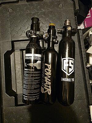

                Yes I grabbed a Pow Air 15ci tank. Its been charged at 4k for 2 weeks now, no issues so far. Will be testing it out soon. It is very short even compared to a 15/45 CF tank.

                  I'm not 100% convinced it is a 15ci. Look at it next to a 13/3 and a 15/45.

                    Open it up and fill it with water… funny thing about volume is even a tiny change in diameter makes a huge change in volume.. plus with steel you can have a thinner wall thickness
                    Alexndl commented
                    Most likely wall thickness. Aluminum yield strength is a lot lower than steel. But it will be slightly lighter than steel for the same strength
