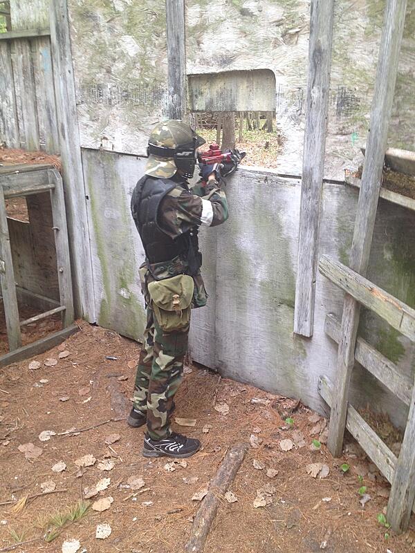

                This is an old picture as my son who is now 20 and still playing and this was when he was 10. Baseball hat backwards is the way to go in my opinion. He never had an issue.

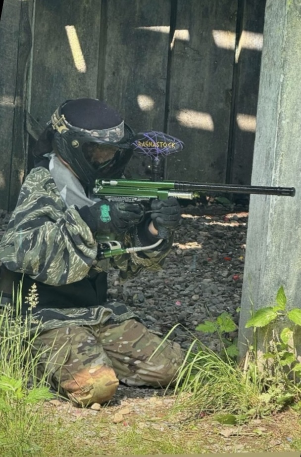

                  • 1997
                  And still does is 10 years later
