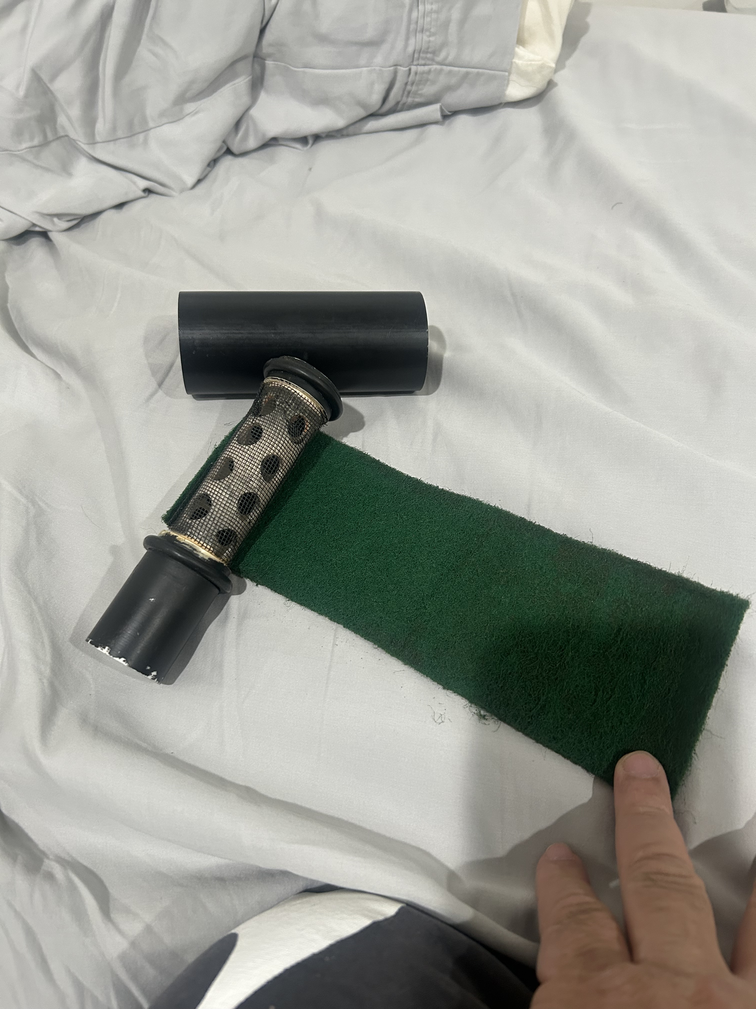

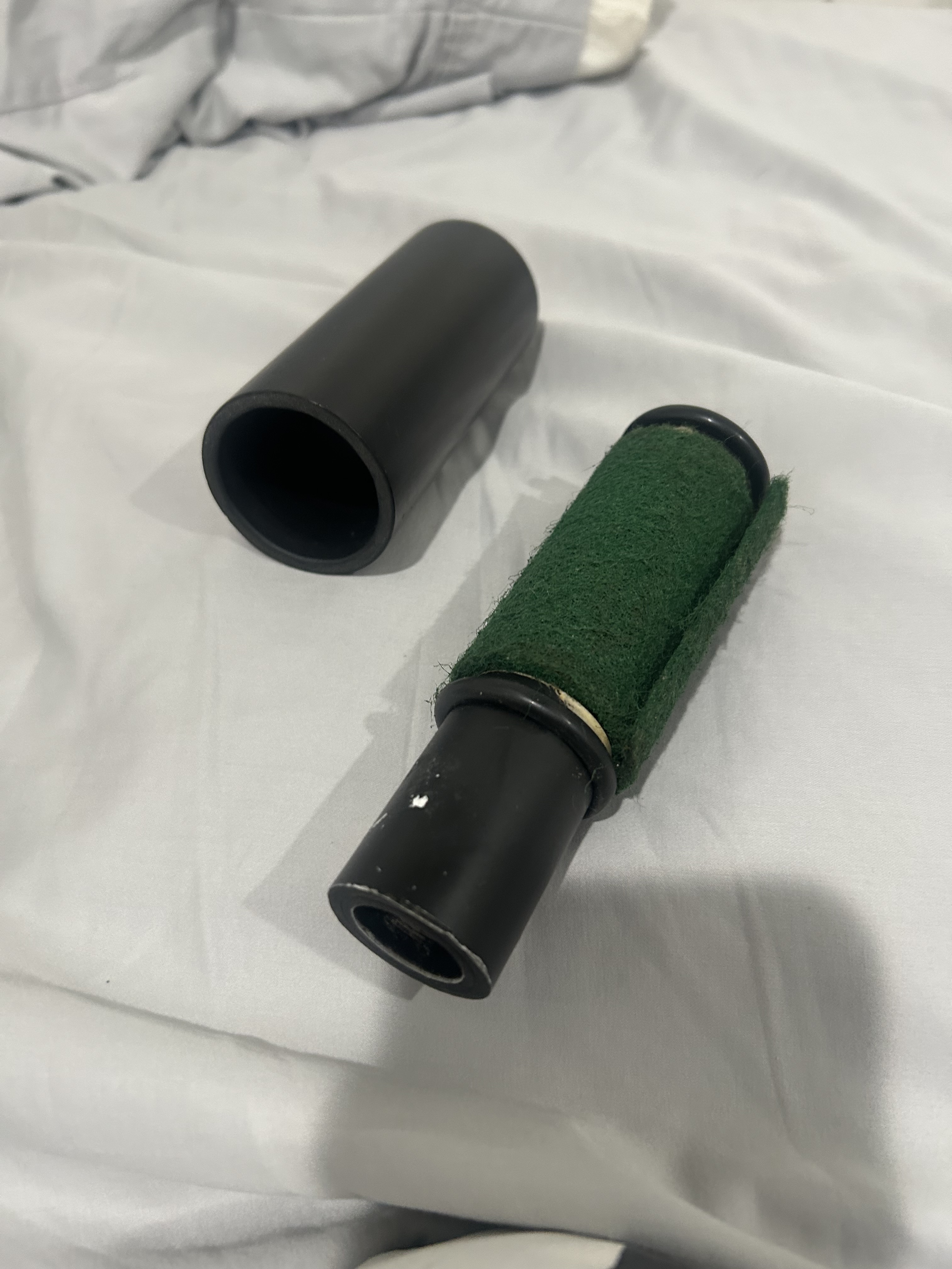

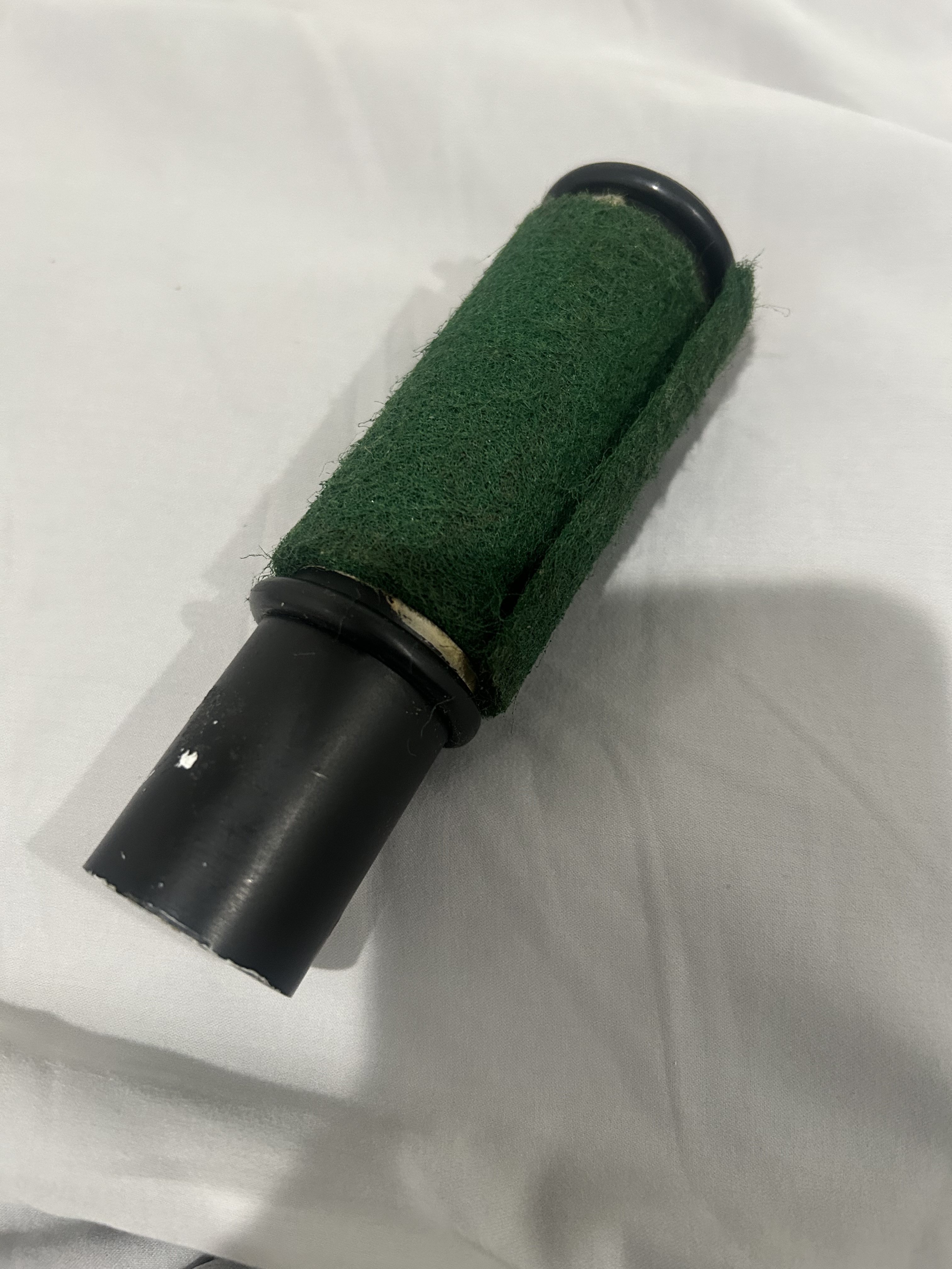

          this material is approximately 3/8th thick and since the 90’s it’s scotch brite and it’s brings the bark of a barrel down to a whisper
