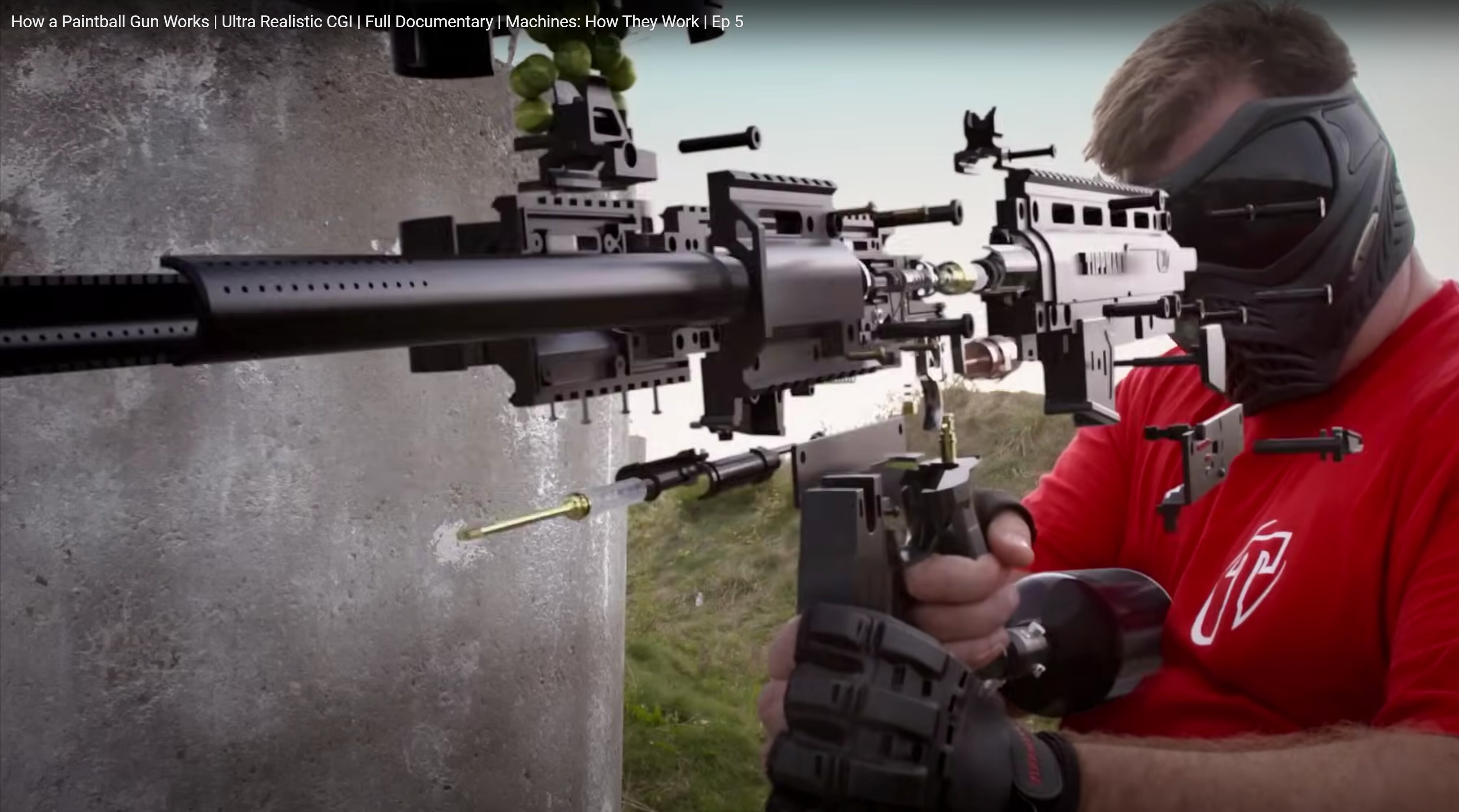

    To clarify- the actual video is NOT AI garbage.
