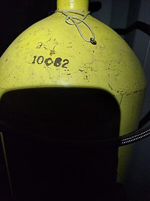

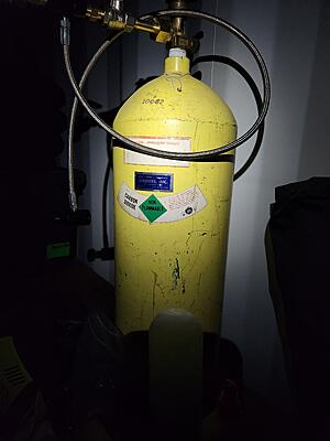

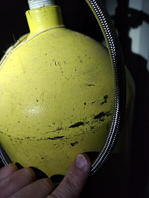

          Post a picture of the tank

            This thing is ooooold. Not at old as the 100# propane tank i got from a neighbor with a 1948 date stamp.

              Pretty sure it doesn't have a siphon tube. I'll probably make a cradle to hold it upside down till it's used up and then trade it in for a proper one.
