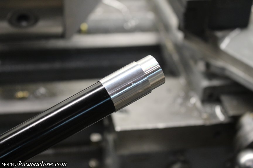

    An idea I'd been playing with for a while was a simple adapter. The back half sliding into the body like a regular SL barrel, but the fatter Phantom-threaded section outside the front, and in the space where it wouldn't interfere with the pump even all the way back.
    Problem there is you have an inch-long gap between the bolt and the barrel. I could have made them like the "sizers" I did for the Trracers, but what I wanted was for the bolt to chamber the ball directly into the insert itself.

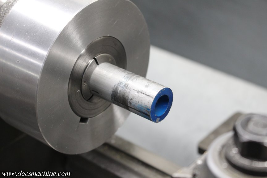

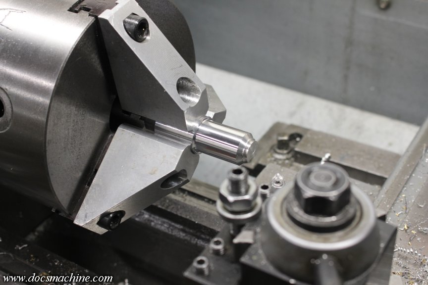

    I had an SL here of my own I was willing to sacrifice on the altar of the Pump Gods, so I found a chunk of heavy tubing in my scrap bin...

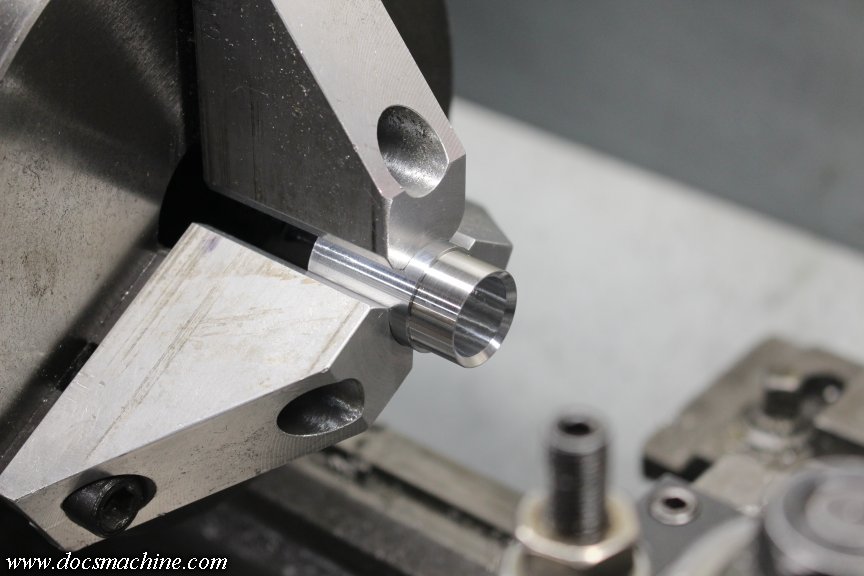

    And measuring on the fly, turned it into the first probable design for an insert.
    The threads were a little tricky- a short throw of stub ACME turned to an internal shoulder, using a hand-ground cutter- but I got an acceptable fit.

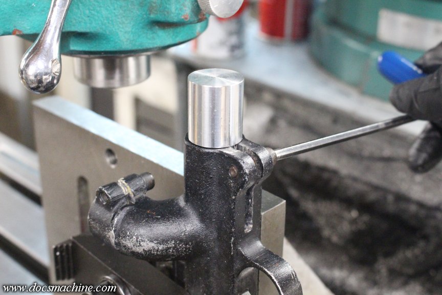

    Then, thinking slightly ahead, I turned a stepped plug, that fits the body in place of the barrel. Thanks to the turned-in-place soft jaws, the two diameters were less than half a thou concentric with each other.
    That fits in the body like so...

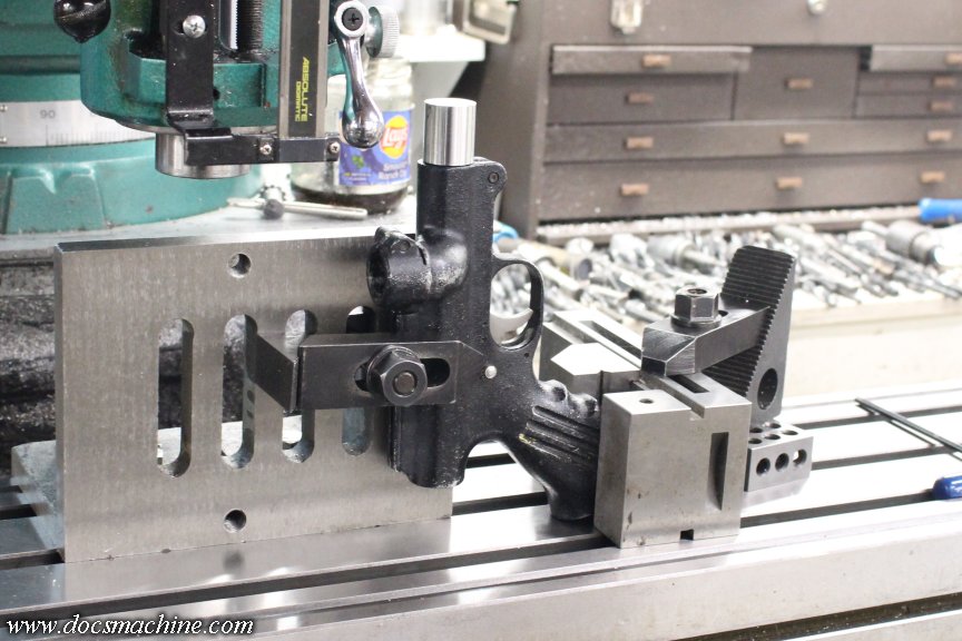

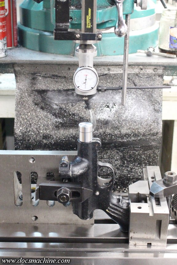

    And the whole cobbled fixture monstrosity looked like this:
    Considering there's pretty much no flat, smooth and level surfaces anywhere on these bodies... well, that was the best I could do. Believe it or not, it was referencing off the cast nameplate on the side.
    The plug gave me a reference surface for a coax indicator. I got that dialed to within less than half a thou of the original bore, and zeroed the DRO.

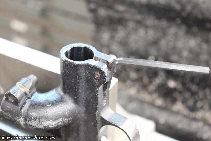

    Remove the plug, then re-snug the clamp bolt on a 3/16" hex wrench, so the 'ears' of the clamping portion are supported against the cutting forces (mild as they are.)

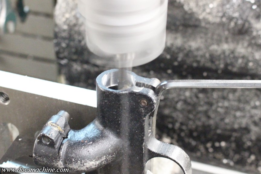

    Set up the boring head, whisper a small prayer to the machine gods, and ream that puppy out.

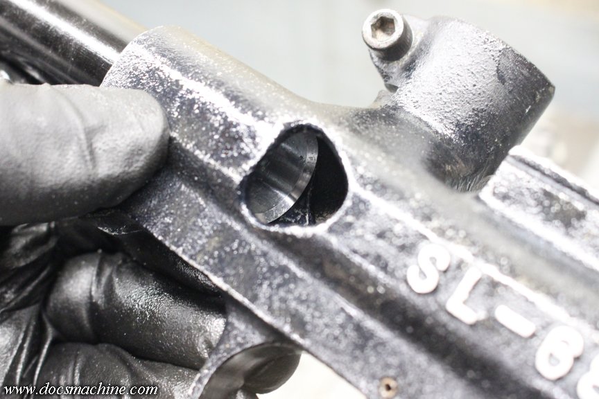

    Bore the hole to .002 over the size of the insert and give 'er a try.

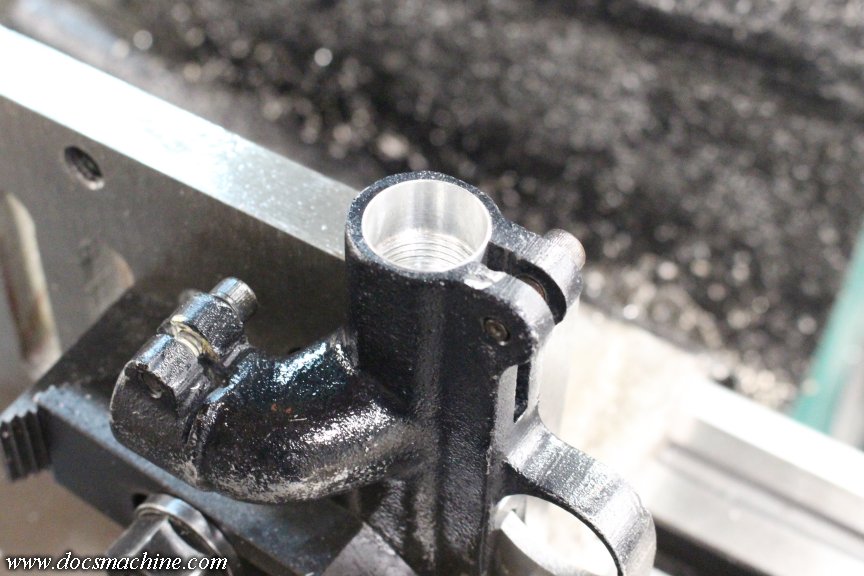

    The insert is now the new barrel breech, and properly positioned...
    And internally, the geometry is set so that when the bolt is fully closed, the ball is just inside the bore of the insert, so an underbore can hold the ball in place, as it should be.

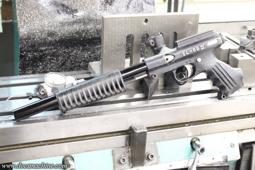

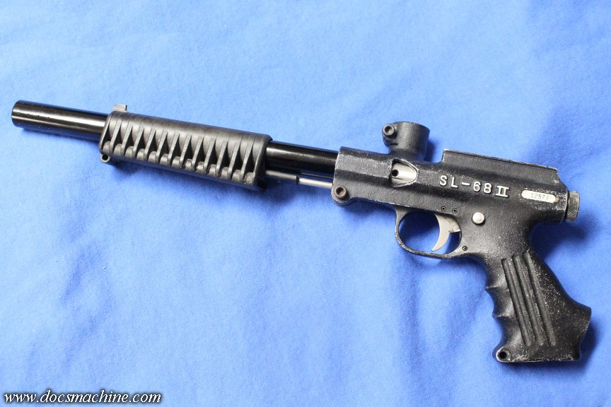

    And once it's all cleaned, oiled and reassembled, the mod is practically invisible.
    And, from a distance, unless you look close and see the Phantom muzzle ports, the whole gun looks bone stock.

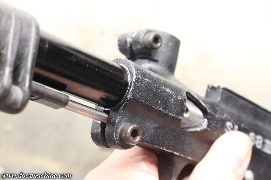

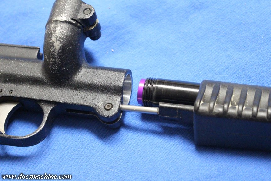

    In use, the barrel simply unscrews like a Phantom (natch ) and as a bonus, once the barrel is out, the bolt and pump are still captured, making it easier for a quick clean on the field.
    But, when it comes time to remove the bolt to clean the chamber, just loosen the original clamping bolt, slide the whole barrel and adapter out, and the pump and bolt come out just like usual.
