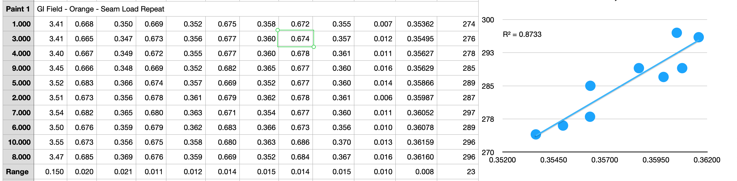

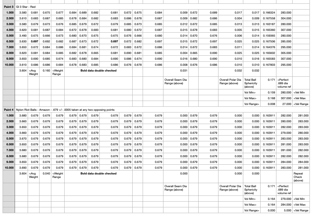

    All testing below was done with an Etha 3M with a CP 14" .693 Advantage barrel, which measured .694 at breach and .693 at muzzle.

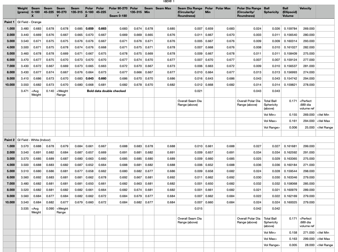

    All that said, I've recently heard that the air blast will deform a paintball some to make a seal in the barrel. This seems feasible, to some extent, so I wanted to see the effect of weight, diameter, and volume on velocity. At the same time, the charts will show diameter variation, which, I think, backs up my view on barrel kits. The first two screenshots below show all the measurements taken to test this on 3 different paints. It also shows a control group with very consistent (weight and diameter) Nylon riot balls. They're meant to be eye charts, as the testing didn't prove much. Not shown (even more eye charts), I sorted by weight, seam min dia, seam max dia, polar min dia, polar max dia, ball sphericity, and ball/ellipsoid volume to see if there was any relationship to velocity. I found none.
    I've alway thought velocity is most dependent on how each ball loads - the surface area presented to the air blast and how it interacts with the ID of the barrel. For this test, I had to carefully load each ball to get the seam diameter (which is typically larger than the polar axis diameter) perpendicular to the axis of the barrel to the best of my ability. It was tedious, and I'm sure it still wasn't perfect. I had each ball forward against the detents (not against the bolt) just for the sake of consistency, and to limit, however little, how much the ball would roll as the bolt pushed it into the barrel. I had to carefully line the gun up with the chrono, so the ball didn't shift in the breach as I moved the marker. I should have started with this. It was less work, and begins to show a correlation. See screenshot 3 below. Some of the shots that don't correlate may be excusable due to other factors, weight or the repeatability of the marker (as demonstrated with the nylon balls), for example. I understand average surface area has to go out to 3 decimal places for most shots, and up to 5 between two shots, to sort by average seam surface area, but the data is what it is.
    I will try to repeat the test a couple more times to see if the correlation peeking its head continues.
    I welcome constructive criticism and thoughts.

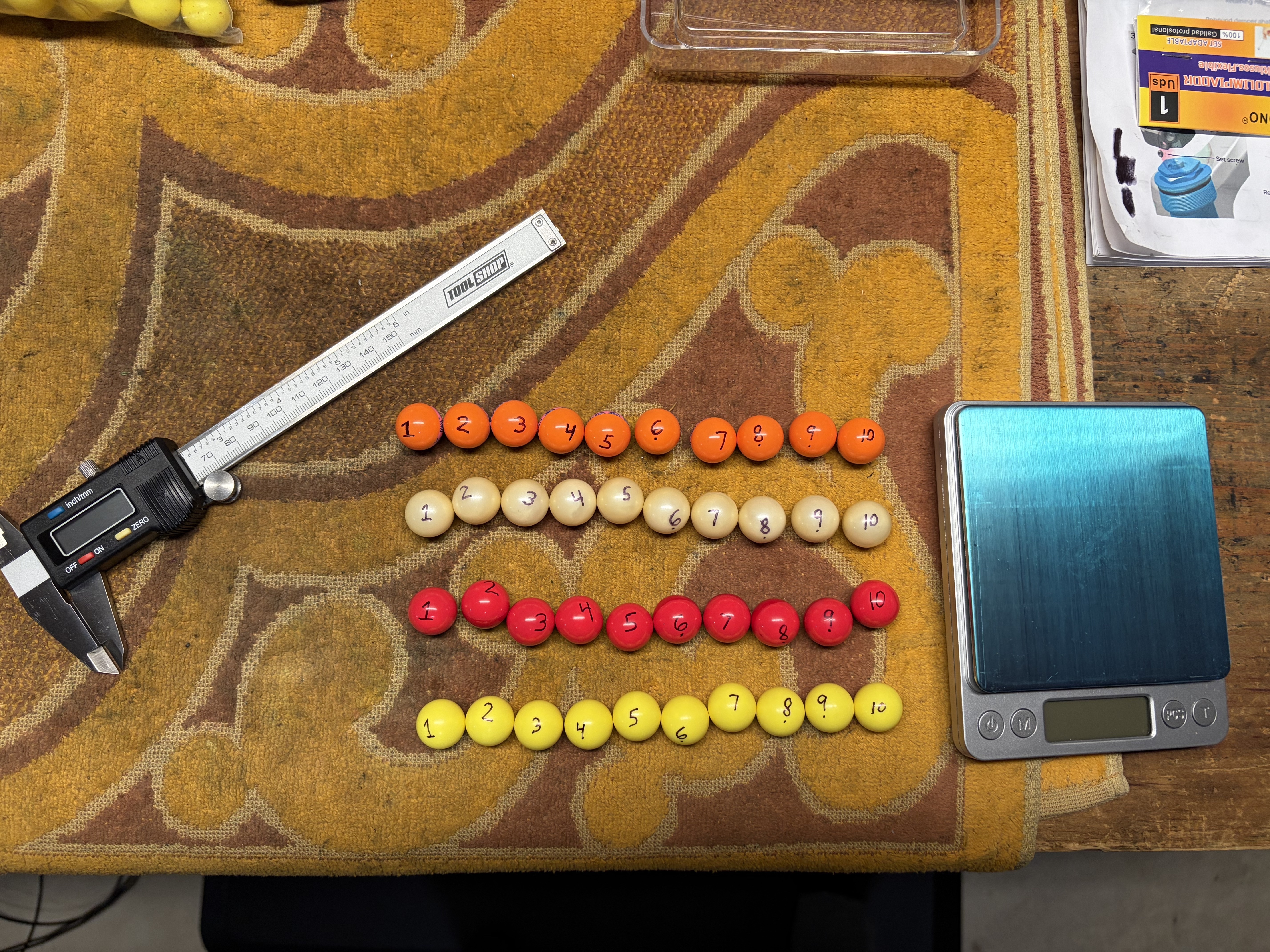

    I forgot to include this picture in the first post - a sharpie, calipers, a scale, and lots of measuring. The numbers helped me orient the ball for all the different diameter measurements. Obviously, I had to do another set of 10 for the second data set.

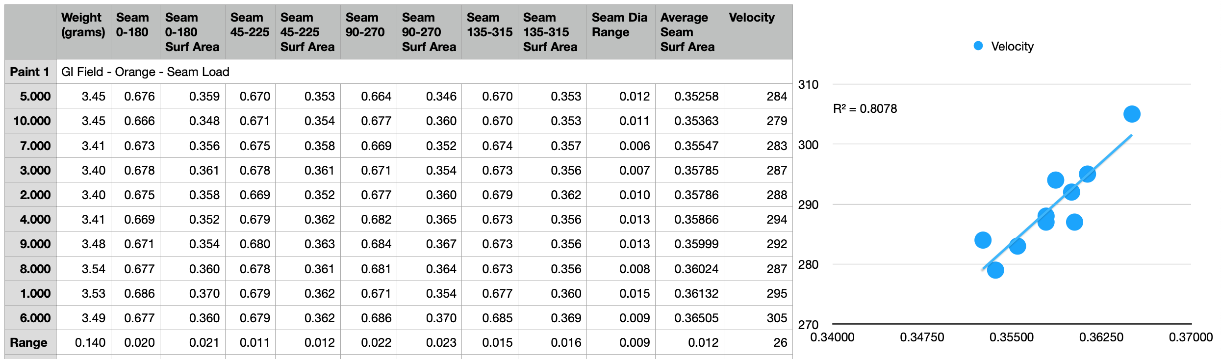

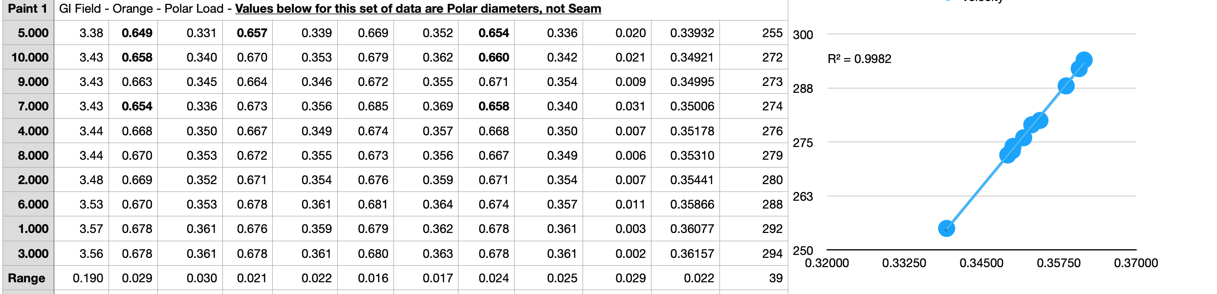

        Screenshot 1: Initial seam oriented load data. The ball was meticulously loaded with the seam perpendicular to the barrel axis. This showed pretty good correlation of average surface area to velocity.
        Screenshot 2: Repeat of seam orientation load data - even better correlation of average surface area to velocity.
        Screenshot 3: Oriented load data based on polar diameter instead of seam. The ball was loaded with the polar axis perpendicular to the axis of the barrel. This resulted in great correlation.

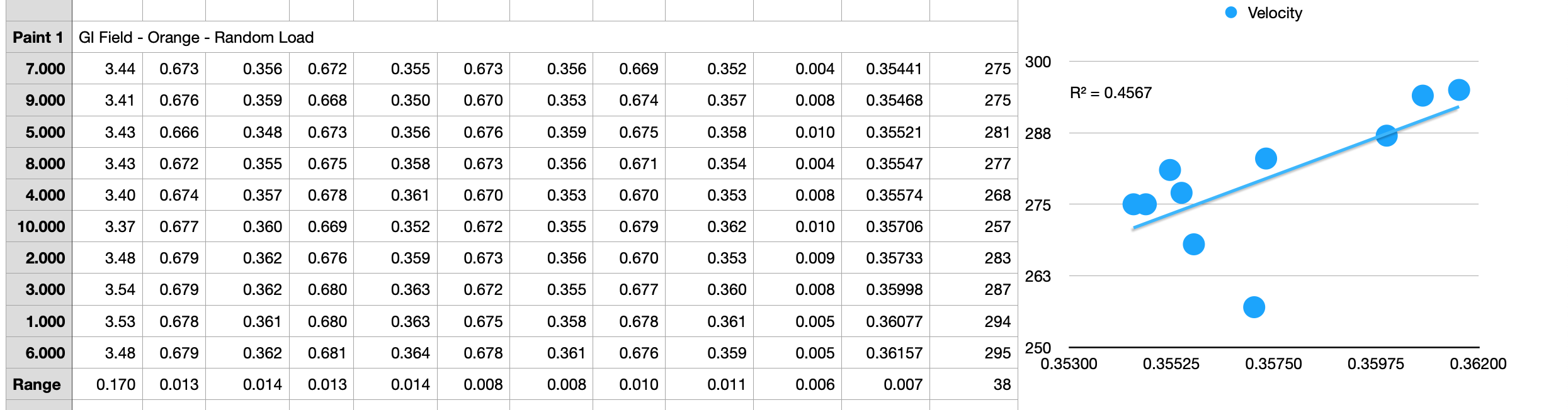

        Screenshot 4: Back to seam orientation but randomly loaded to see if correlation went away. I observed the randomly loaded ball just to see if they loaded in different orientations, but I didn't manipulate the loaded ball in any way. The correlation disappears.
        I'm not a stats guy, so if I'm doing something stupid, let me know.
        I also edited the first two screenshots (4 sets of data) in the original post. I messed up the volume calculation, but it doesn't change the lack of correlation.
        Edit:

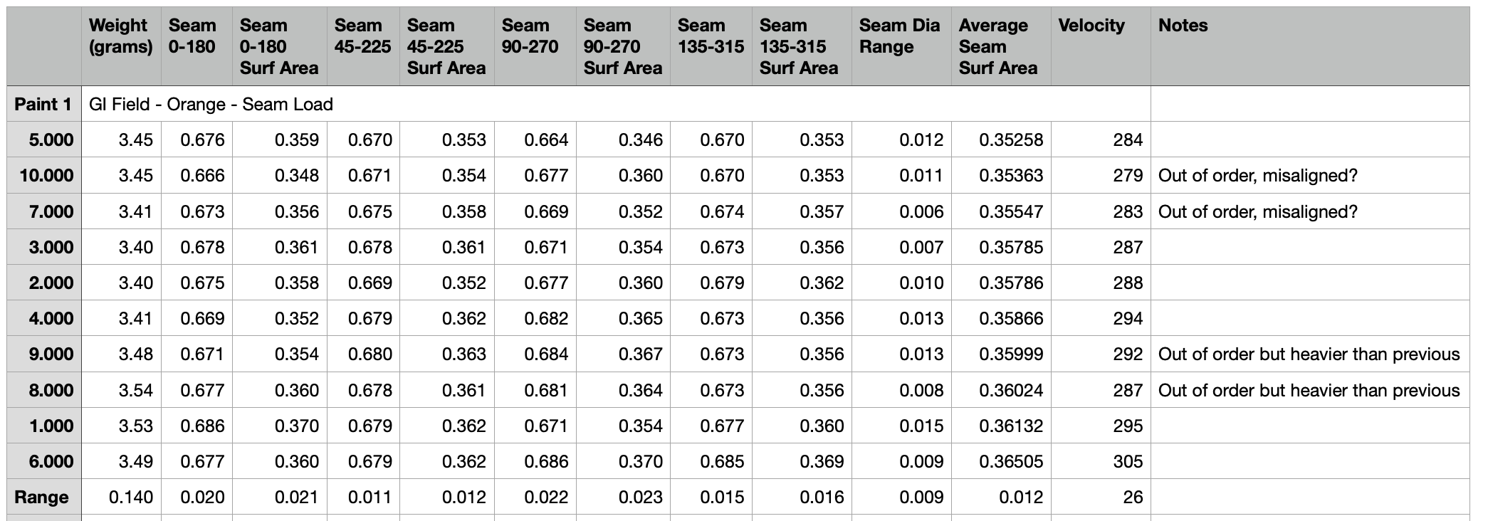

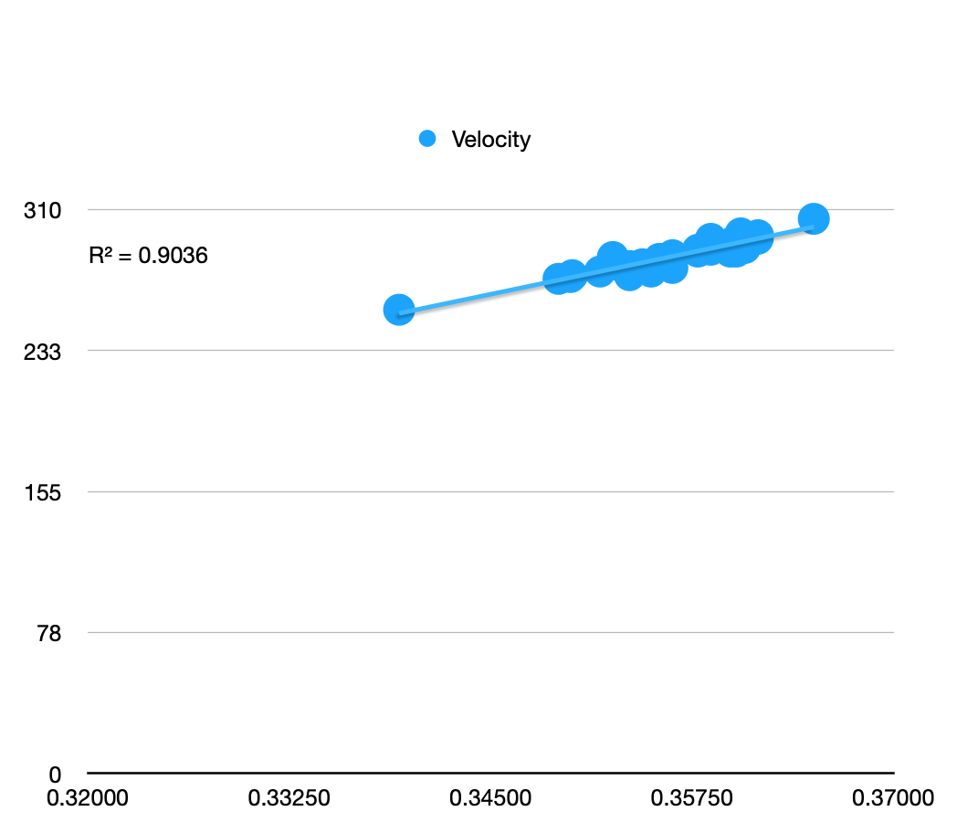

        1. Screenshot 5: Chart of all 30 balls loaded in a controlled manner.
        2. Should I be using a 2nd order polynomial for the trendline and R2 value, since the x-axis is Pi x radius2 to correlate against the y-axis velocity value?
