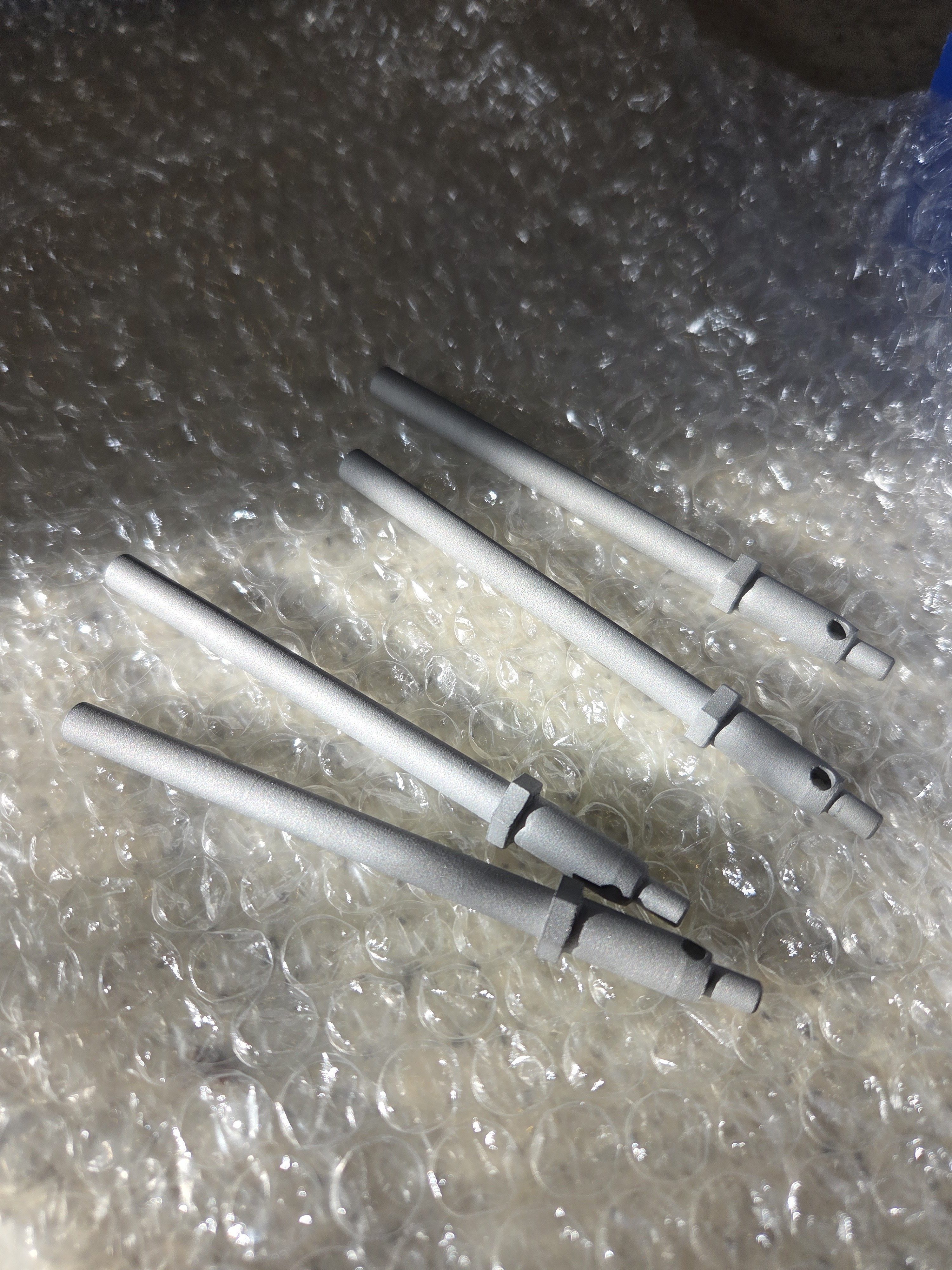

    3d printed 316 ss power tubes for a razorback 2
    the need some finishing to be usable but I'm pretty happy with what they are so far. The tolerances aren't bad at all so far.

    Nice! You have the really really good 3D printer.
    • dukie
      • 131
      Oh it's not mine. I order them from jlc after I measured them up. I just thought the results were pretty cool and wanted to share.

        SLS or one where you wick in filler?
        • dukie
          • 131
          SLM

            What was the price of you don't mind sharing? Was it pretty close to what the initial estimate was?
            • dukie
              • 131
              they give you a quote when you upload your files. they were ~8 USD each plus 5 shipping for 4 of them. Cheap enough that I could run the experiment to see if they would work for me. Better than buying a used PT for nearly the same price that has the same problem as the one I have. weak interface at the stem that tends to crack at the ports. I can break 4 and still win

                  It totally worked! I have no idea how both the nearly 35 or old cup seal and puncture seal held but they did.

                    Where did you have them printed?
                    • dukie
                      • 131
                      https://jlc3dp.com/help/article/how-...4aAnlzEALw_wcB
                      They needed the bore drilled out to size. Walls as req were too thin for printing or concerns for them.
