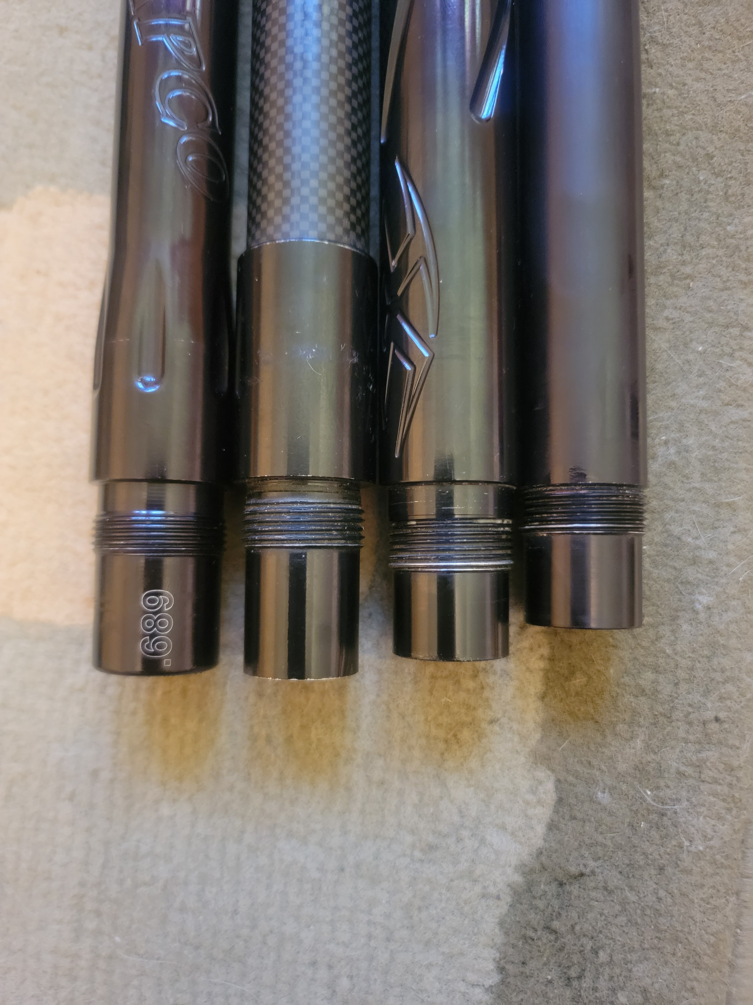

    I can't figure out the threads of this Empire barrel. From left to right:

    Looking at this guide, it seems like the BE Cobra/King Cobra barrel thread, though I could easily be completely wrong
    edit: I am now considering the absurdity of Empire making a barrel for something that specific. It looks visually similar to the A5 threads (aside from the extra material above the threads) so maybe try testing it in an A5 threaded marker if you have one laying around
    edit 2: yeah I have no idea what that is

      Thanks for the link, I did a search because I figured there would be such a thing but came up empty handed.
    • 4381
    Its also a5 just with a larger outer diameter the cut back goes into the barrel nut.
    Empire didn't make cobra barrels.

      Nobody made Cobra barrels. When the Cobras were still being made, I'm not sure the very concept of an aftermarket barrel had even yet been thought of.

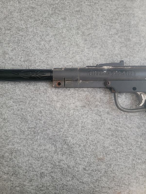

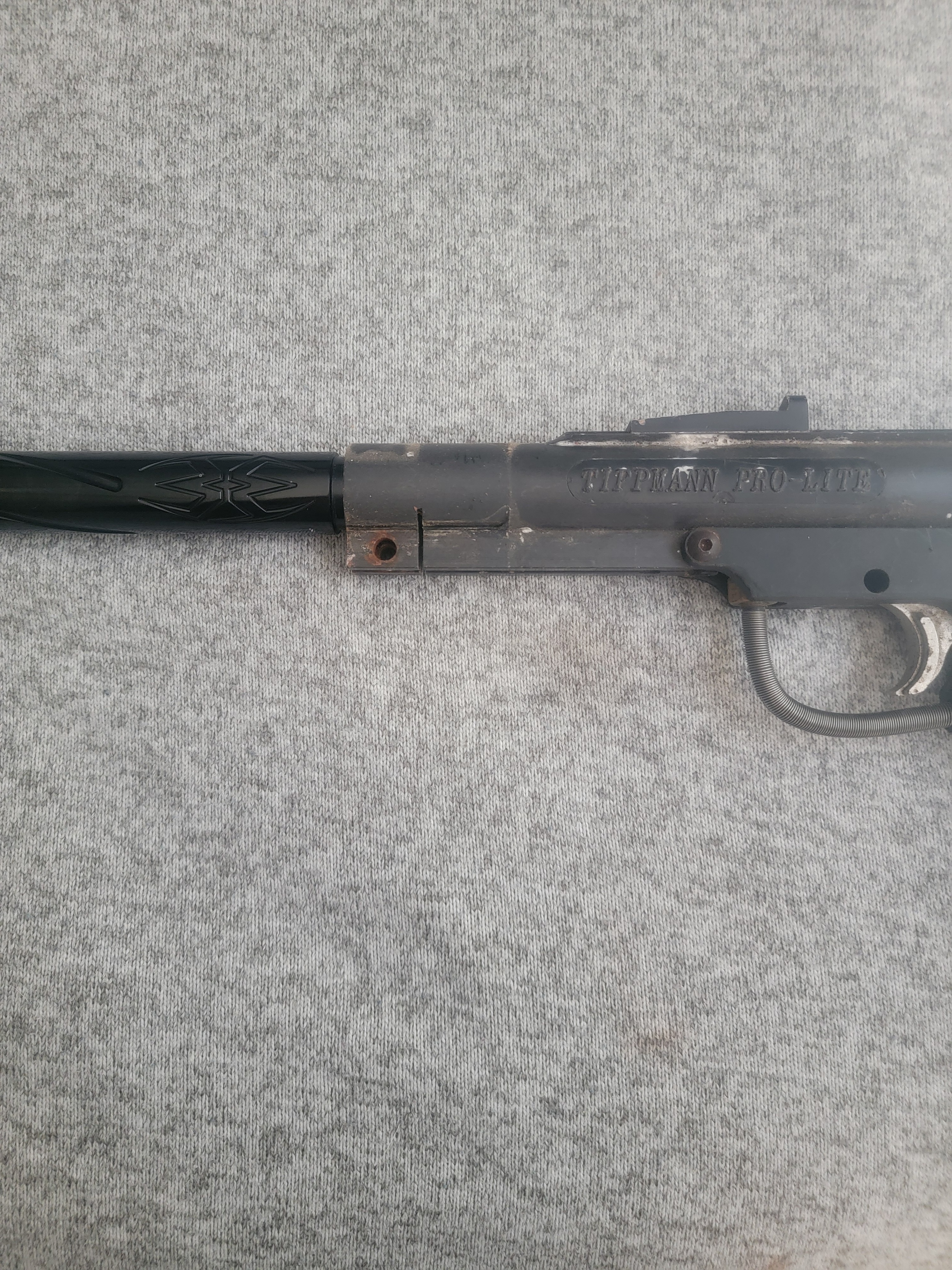

    Ecapnation Thank you sir, you are correct. I managed to get the rusty screw off my Pro-Lite shroud to confirm.
