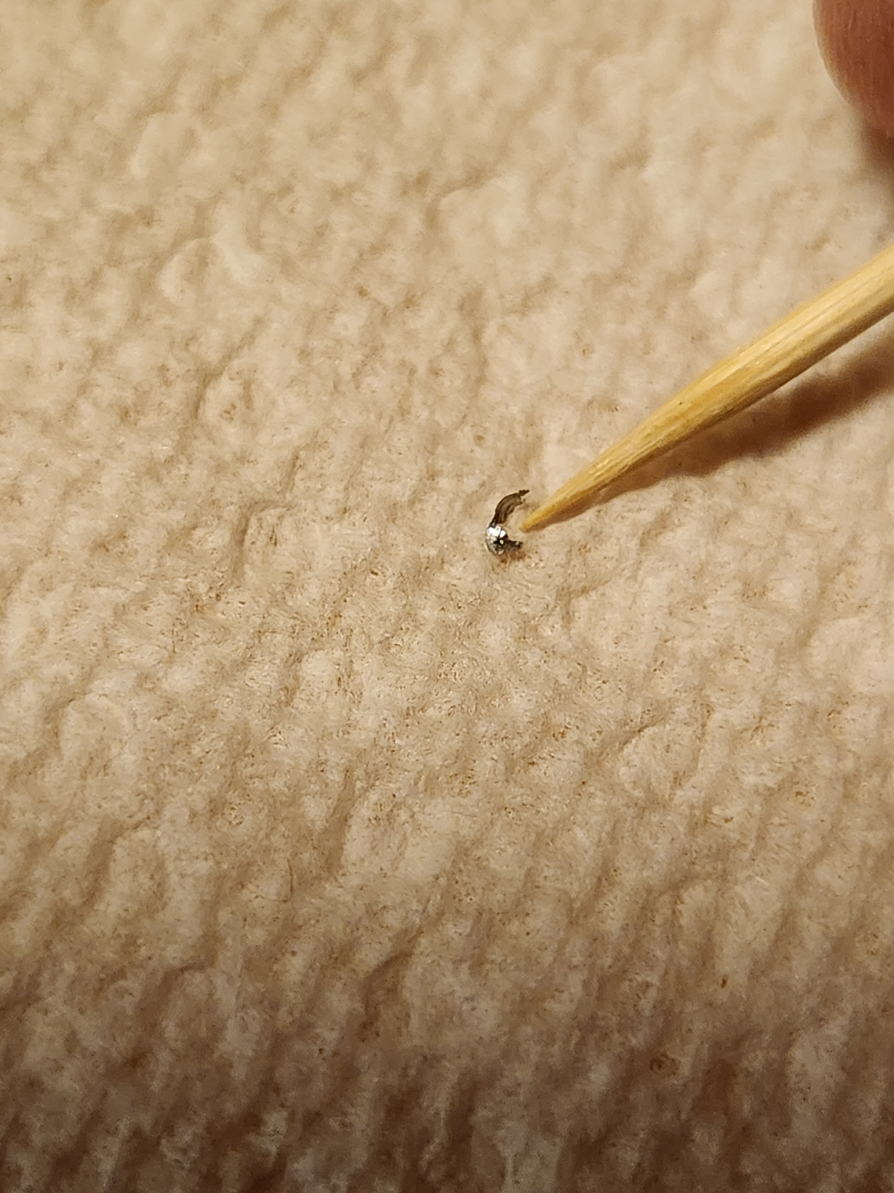

    I fished this out of a brand new CP on/off I was just about to put the fitting onto. Probably wouldn't have done good things to the the RT valve that was downstream of it. What have you guys found upon inspection of new parts?

    Oh crap, glad you found that before using it. I've usually encountered broken things and the odd misplaced part but nothing like this so far. Yep, inspect then inspect again
