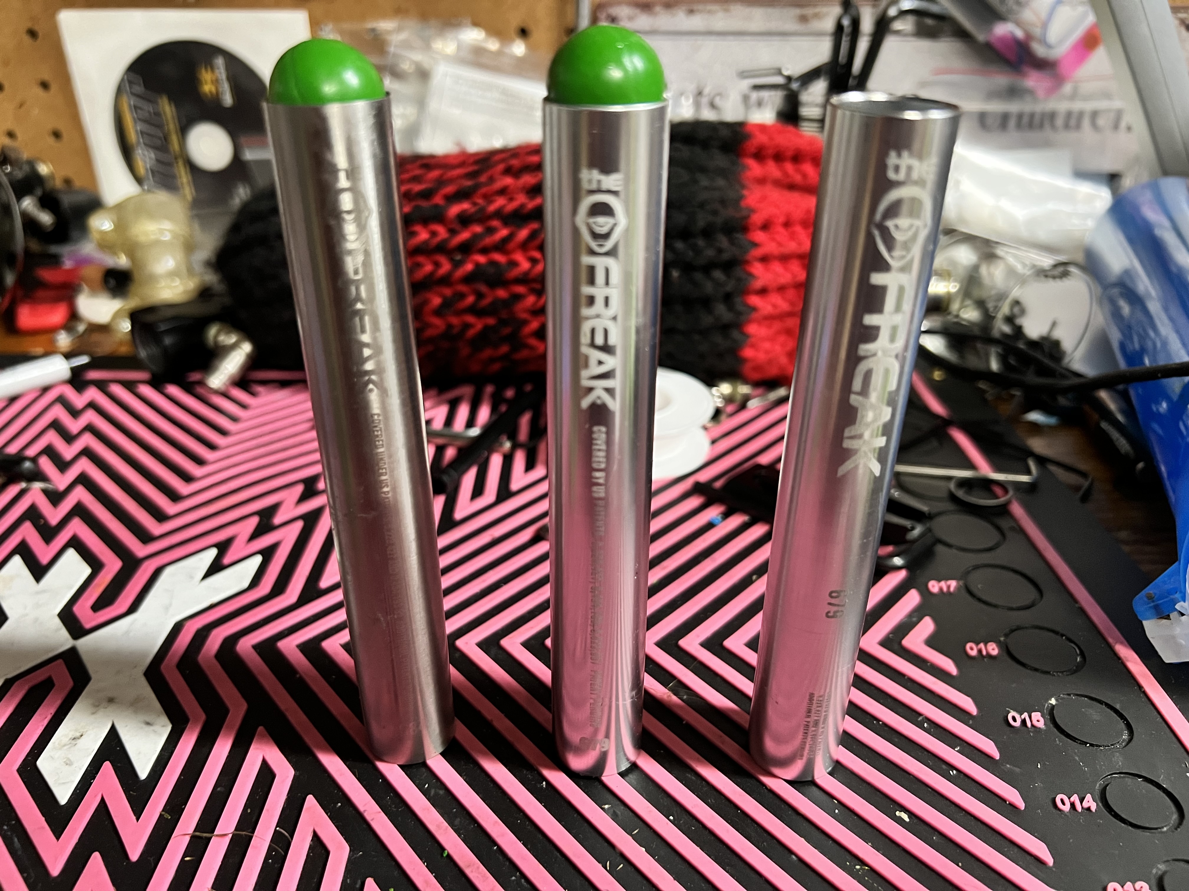

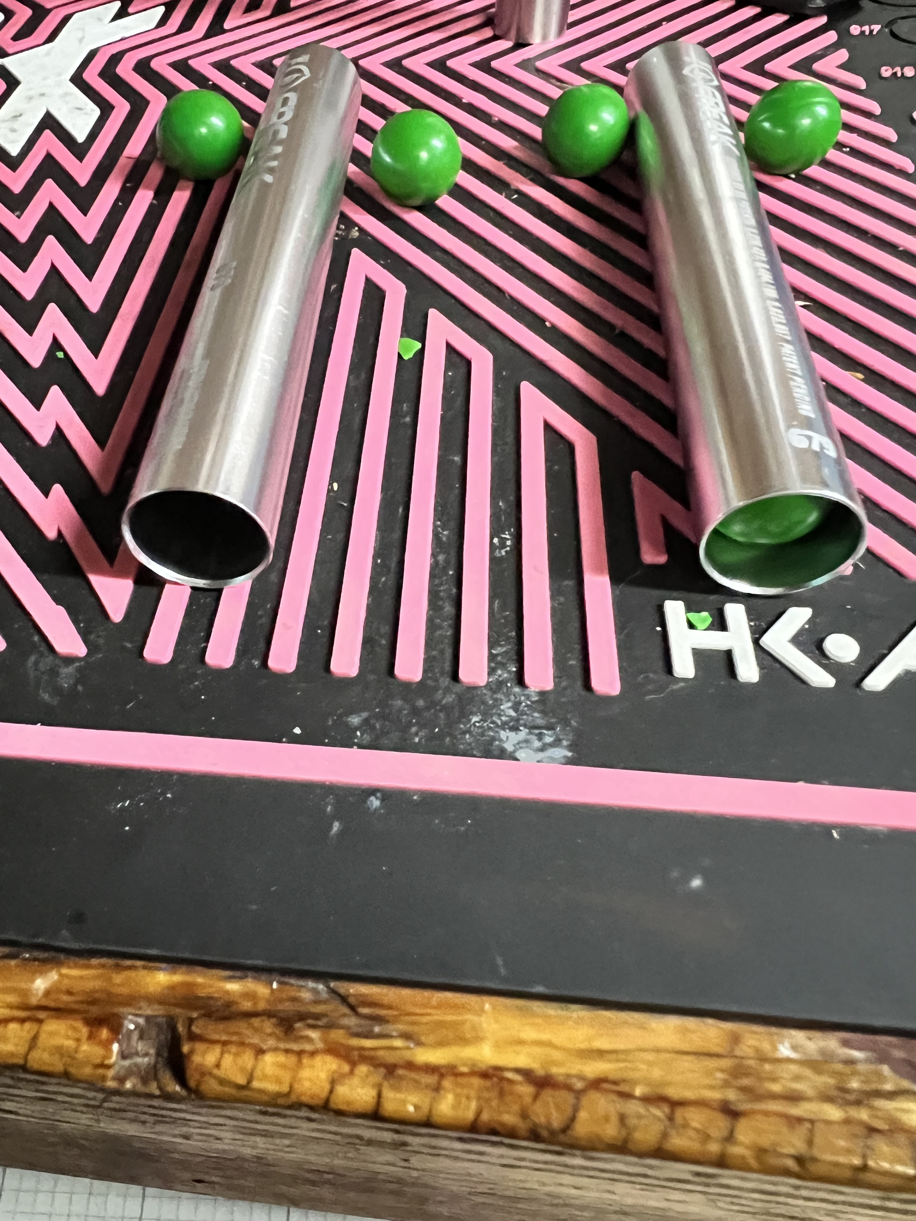

          Please join me as I play with my balls!
          These green “balls” are my field paint. The first bore is 0.684, the next two are both 0.679s. (Going left to right). As you can see, the paint varies significantly. The ball in the bore of the left started at the top of the tube and slowly slid down. The other two aren’t moving, even if I press down on the ball.
            Cdn_Cuda commented
            Due to the lack of roundness of the ball, I took the smaller ball out of the last insert and rotated it and the ball would no longer fit in the bore even while pressing down.

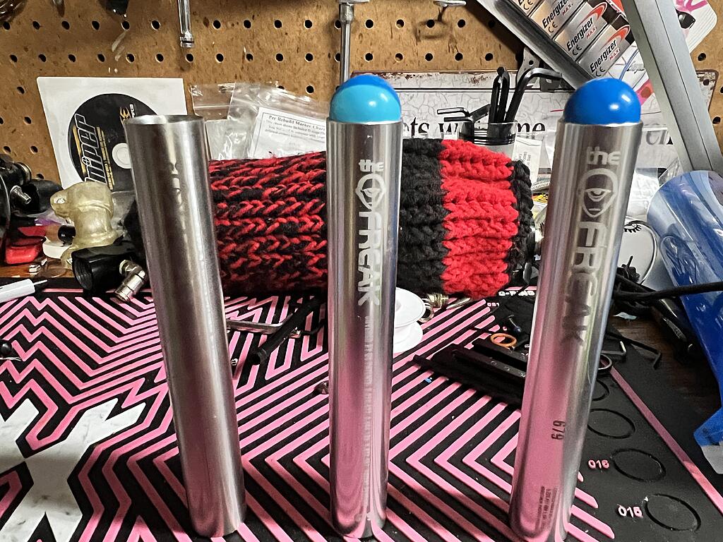

          IMG_6408.jpg I also have some Canadian Tire paint I bought recently that is surprising not too bad. The paint is much more uniform and performs how it ought to.
          The paint dropped down the larger bore, as one would expect.

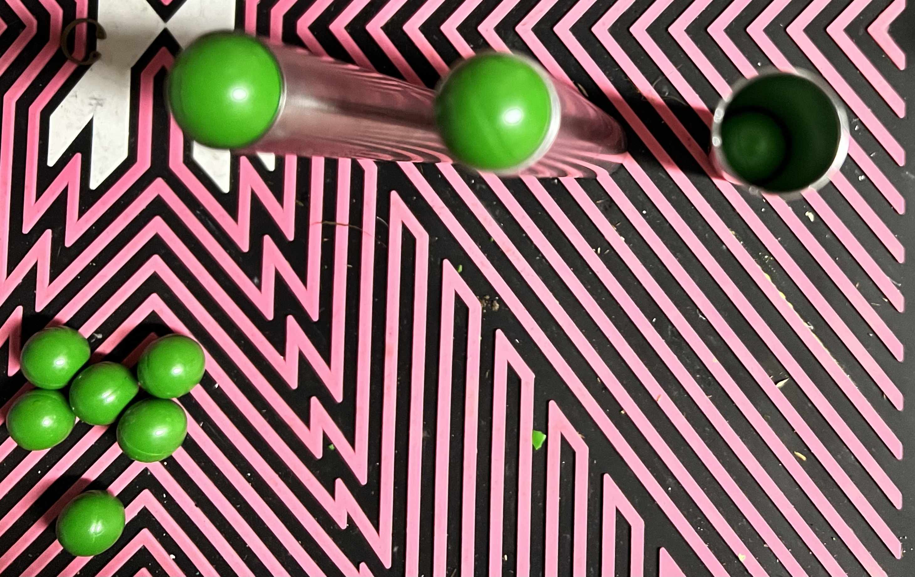

            So circling back to the field paint, I grabbed a random handful of balls to do a blow test. In both cases I could blow 2 balls through the 0.679 backs, but the third ball in both cases jammed and would not blow through.
            The same test with the 0.684 back had the same result. Out of three balls, one got stuck. Swapping to an Empire 0.685 back all balls would blow throw and some balls just dropped straight through.

            And for further proof of just how crappy the filed paint is, I grabbed a 0.687 stainless insert and if the ball went through on the wrong angle I could not blow it through the insert, but is rotated another way, it would easy blow through. This is using the same 8 paintballs to maintain some measure of consistency…. Or in this case consistent inconsistency.
            And in the case of my Nova N1, it ran an 0.679 insert the entire day and my buddy using had no complaints all day. I did try to blow through my sample rounds but could only get one or two balls through the control bore.
