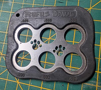

          I have one of these, and according to my Amazon calipers they're spot on. I always wondered with where today's 3D printers are at, if someone could somehow combine a BallSack with some sort of sorting ramp that would have plates of these stacked largest to smallest bore. Maybe 688, 686, 684, etc? The hopper driven Balls Dropper?
