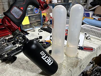

    I have a 13/3k and a 26/4.5k here at home. I’ll fill them both up and run a test.
    My M3+ is setup for 300fps.

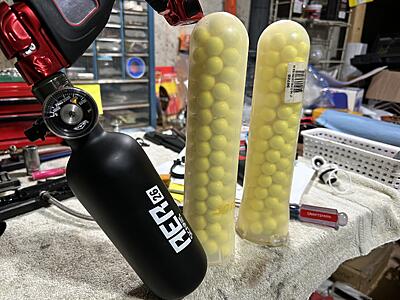

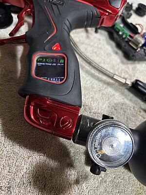

        M3+ one shot per sec
        Two pods
        26ci/4,500psi with a Hill EVO-310
        Riot Balls with a .684 insert
        300fps
        Ended with the gauge showing 1,800ps. Who knows what it really is.

              Ran a 3rd pod through. The gauge indicates nearly empty and the chrono showed one last ball at 298fps. The shot counter between the second and third pod only counts 130rds. So, 130x3 for a 26ci/4,500psi?

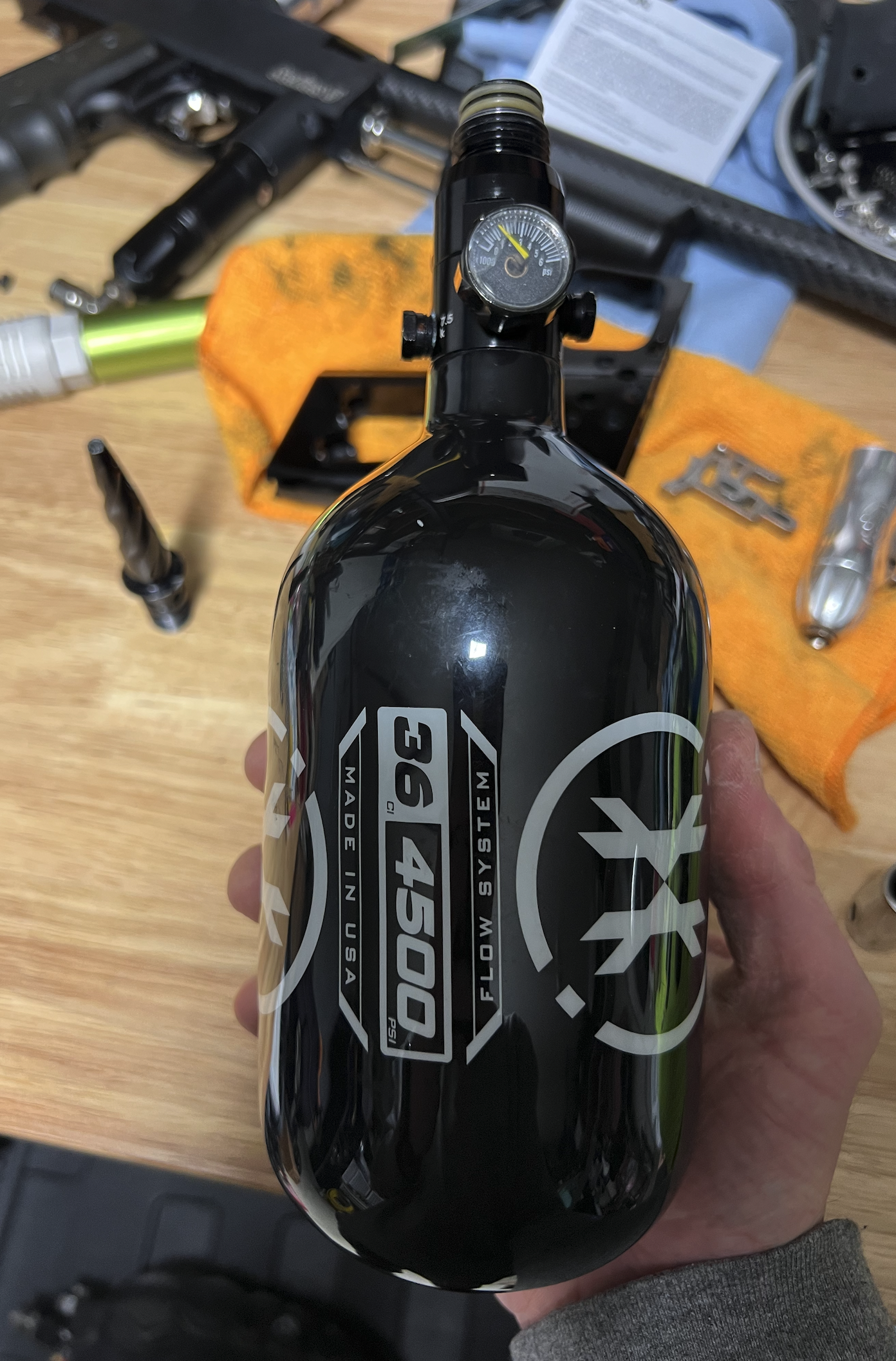

                HK Army 36/4500 is the perfect size and great for going out for two points.
                • latches109
                  latches109 commented
                  flyweightnate I agree the stock reg was slightly too short. this is an old photo, but I eded up swapping out the reg for their higher end extended reach. This tank balances very well compared to the other sizes.
                  Way to short for me works great on my kids pump marker.
