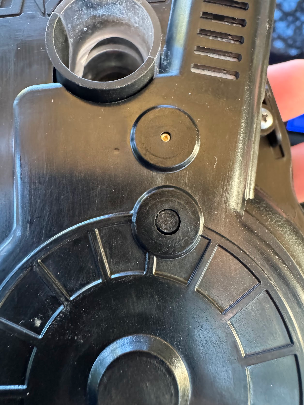

    when you re assemble the casing over the drive setup use a pick to pull the tip of the brass shaft into place, it has a hole milled into it

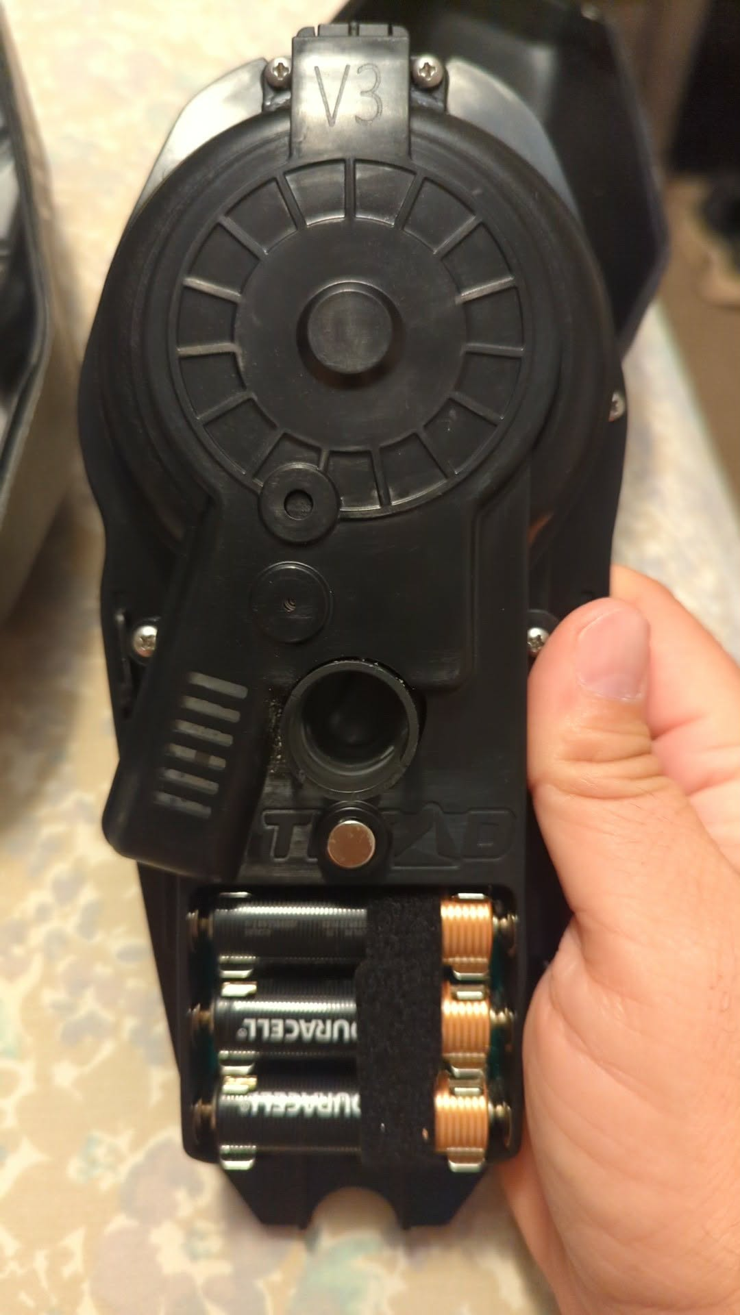

    AAAAND as I eluded I went looking for pictures and found that it was shipped to me assembled incorrectly.
    it *should* look like this, with the little bronze tip showing:
    ​In the photo from the seller you can actually see the bearing:
