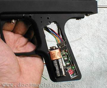

          Oh! And the King, the very pinnacle of bad...!
          Okay, a little backstory: Around the turn of the century- '99, 2K, etc.- the "holy grail" of the day was an E-Cocker. Neither the Race nor the E-Blade was out yet, and F5s were rare and expensive (and a bit finicky.)
          In this market, an "airsmith" by name of Al Mollick convinced a customer he could build him an E-Cocker. The customer sent a gun in, and after a long delay and a lot of excuses, finally got it back. I forget the exact machinations, but I think there was a trade involved, and I ended up with the carcass. I, in a word, was flabbergasted, and posted a few pictures:

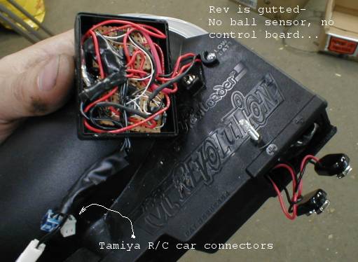

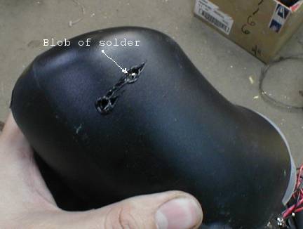

          The gun was powered off the loader- or more accurately, the loader was gutted and used as a battery box for the gun. As a preliminary indicator of the quality of the work, there's a random stab on the loader, from a hot soldering iron.

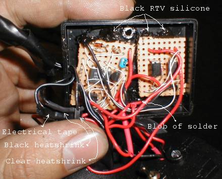

          The "brain box" was a small plastic snap case like you'd see a little sewing kit in, and the electronics are just scraps of breadboard glued in place with RTV silicone.
          That whole mess was unceremoniously bolted- see the screw above the battery snaps- to the side of the loader, and connected to the gun with recycled RC car connectors. (Soldered and black-taped, not heat-shrunk.)

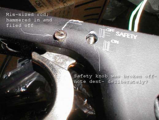

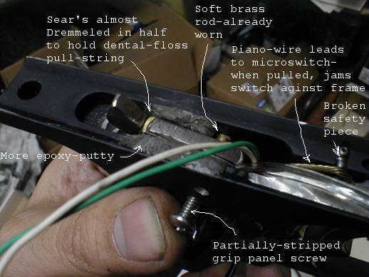

          The grip frame was a heavily modified Benchmark Automag 2-finger frame. It couldn't have been much rougher if he'd used a hammer and chisel.

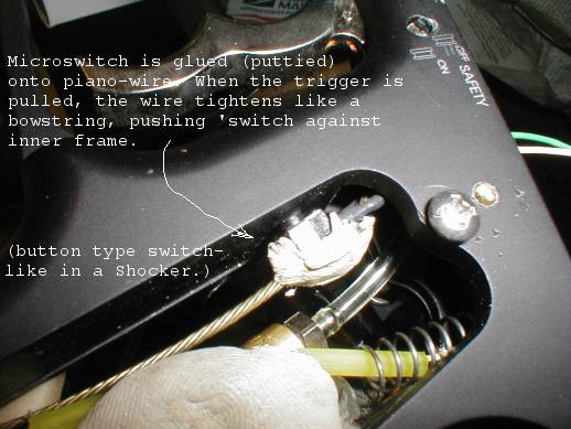

          The sear was literally pulled by a piece if dental floss tied to it, and the trigger was frickin' Brilliant. A piece of piano wire was attached to the trigger, and when you pulled it- the trigger- it tightened the piano wire like a bowstring, which pushed a small dome switch- which had been epoxied to the wire- against the frame, theoretically firing the gun.
          I am absolutely not joking.
          The single-acting, spring return ram had been glued into the frame with 2-part epoxy putty (the whole build used three different flavors of the stuff- the dark grey seen there is the "steel filled" type) and pulled on the dental floss which came through (I mislabeled) an RC car antenna support tube as a guide.
          Here's the aforementioned trigger switch.
          And finally...
          I think we set the kid up with a Bushmaster 2000 or something- I forget the details, it's been a quarter-century!- and I ended up with the gun, or what was left of it, anyway.
          I then did this with the frame:
          Which eventually became this- keeping in mind this was a full year before the E-frames came out.
          Doc.
