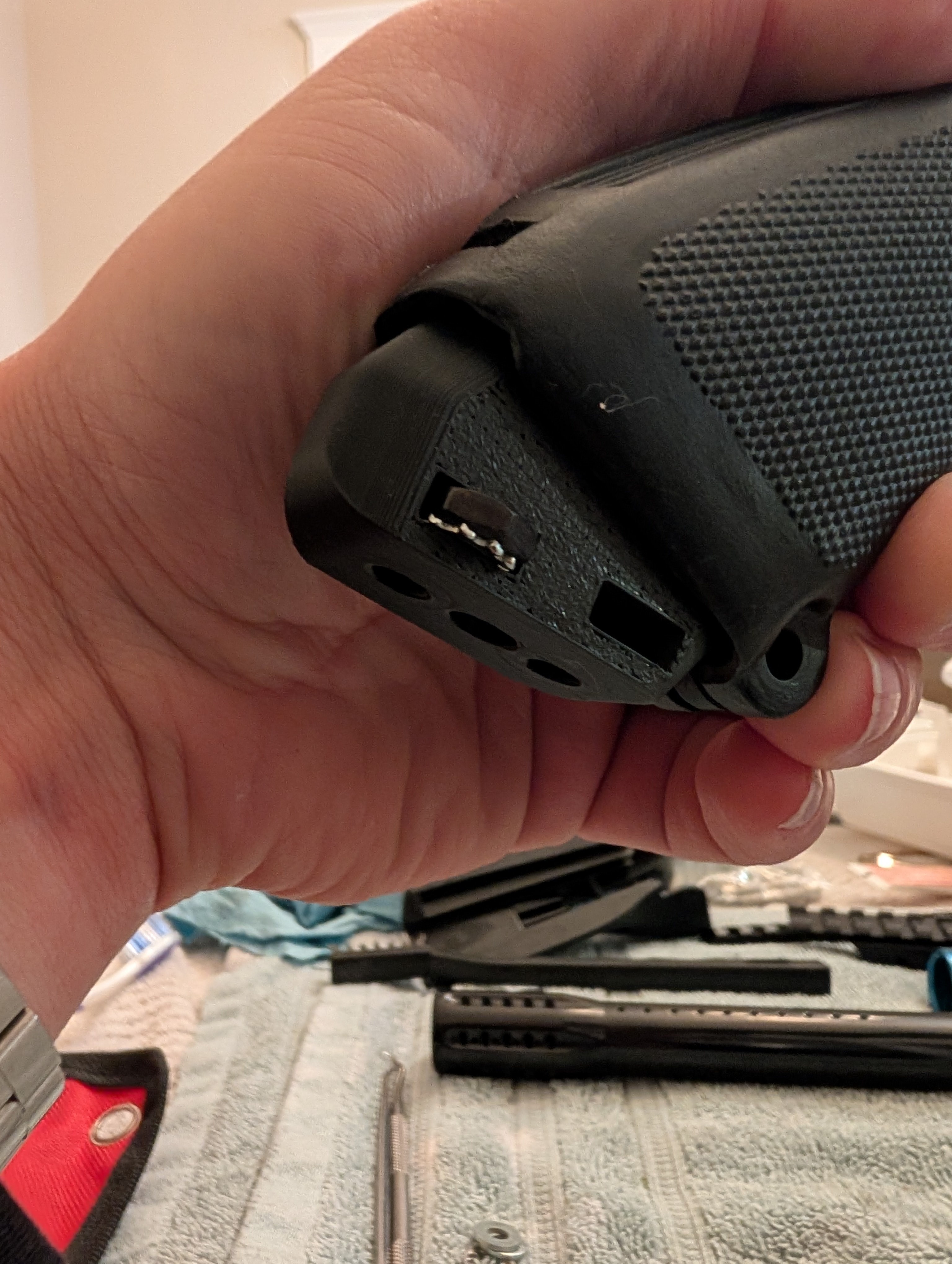

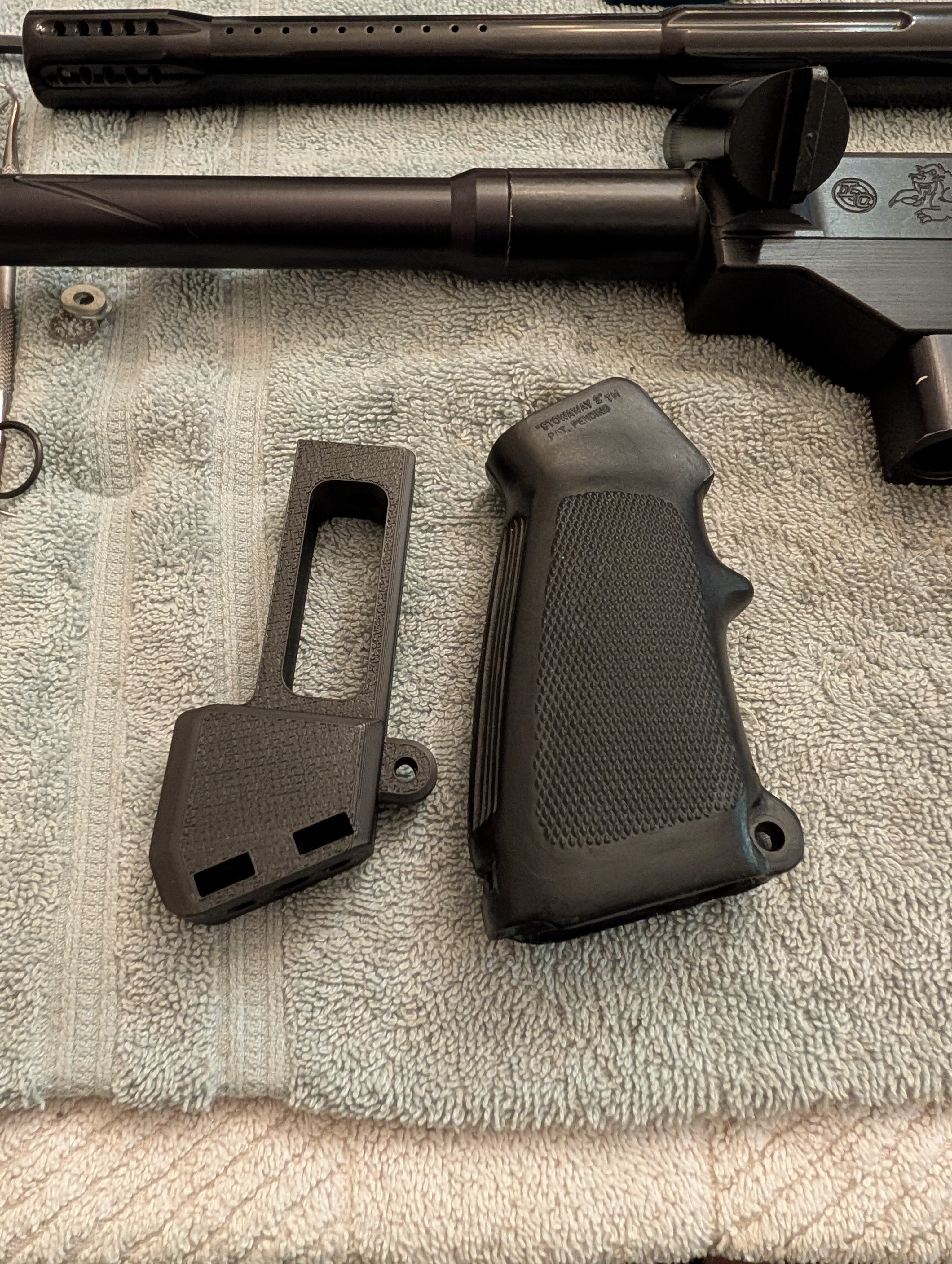

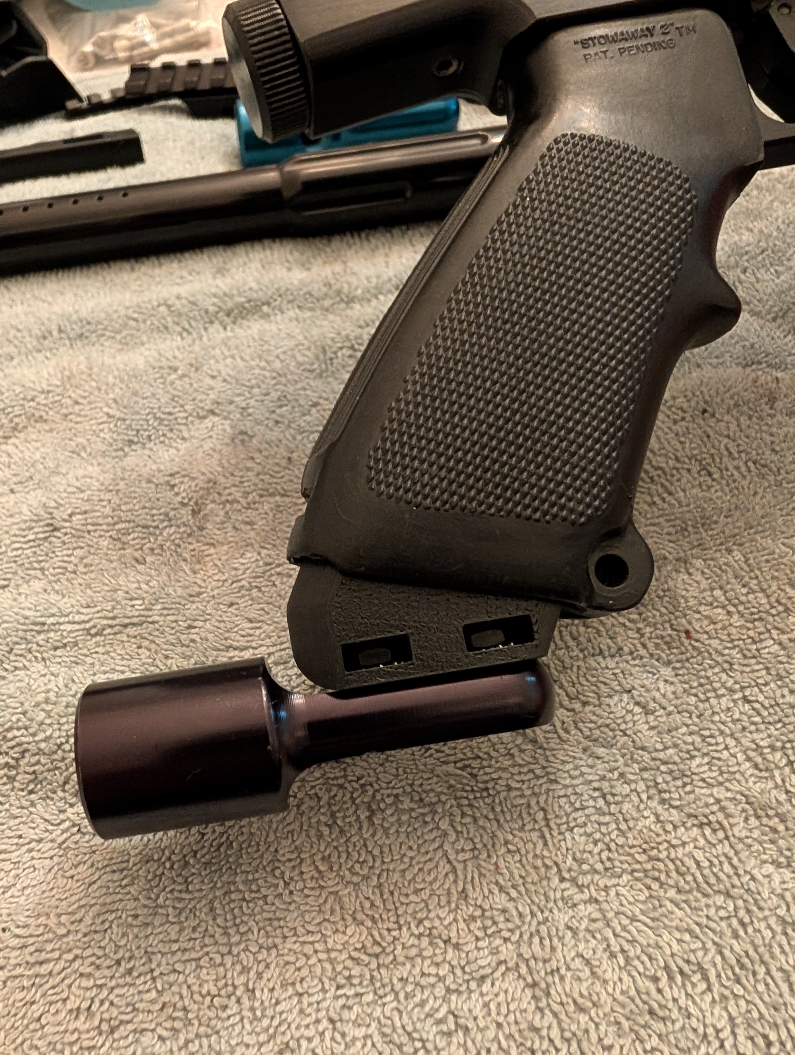

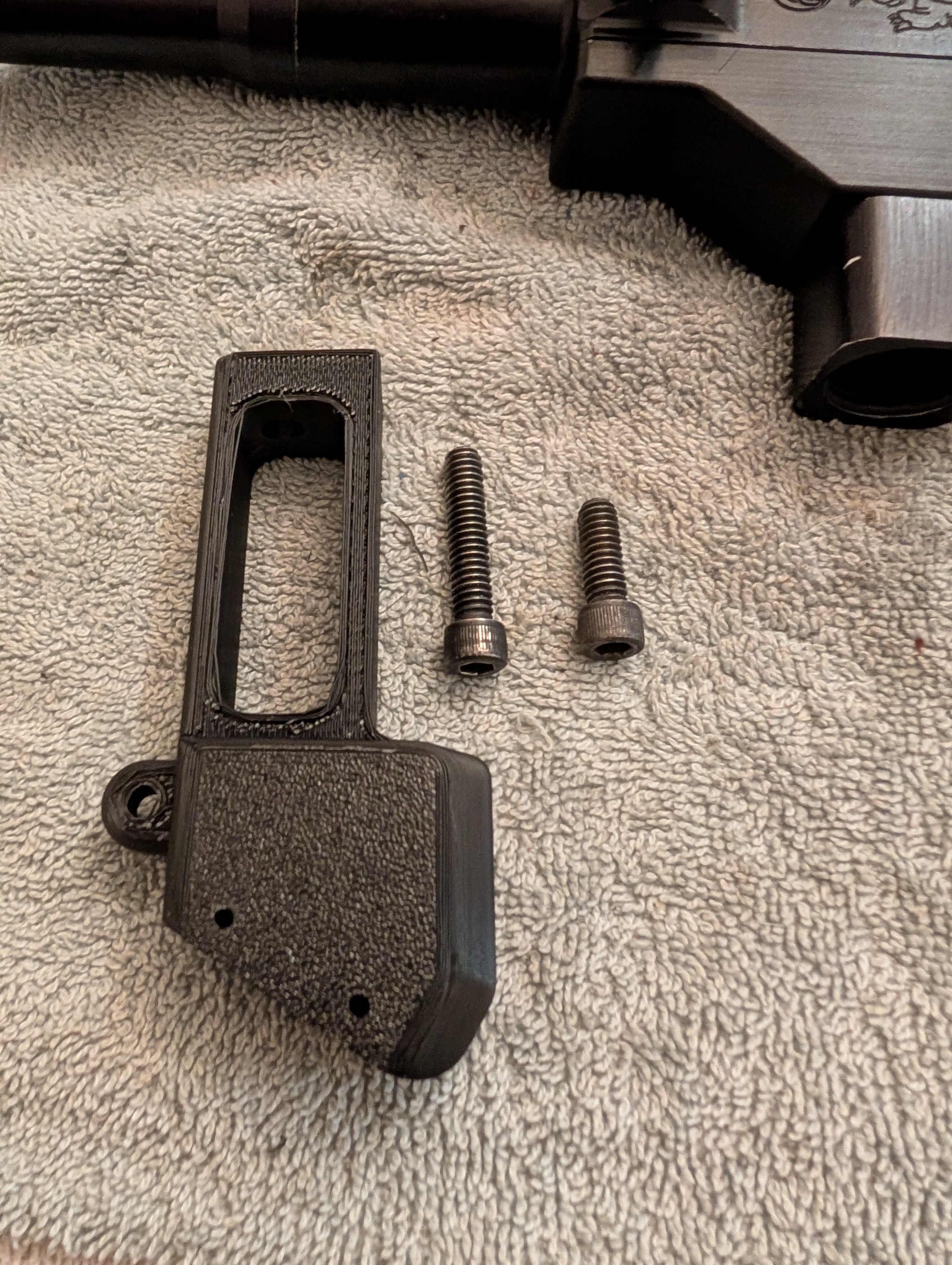

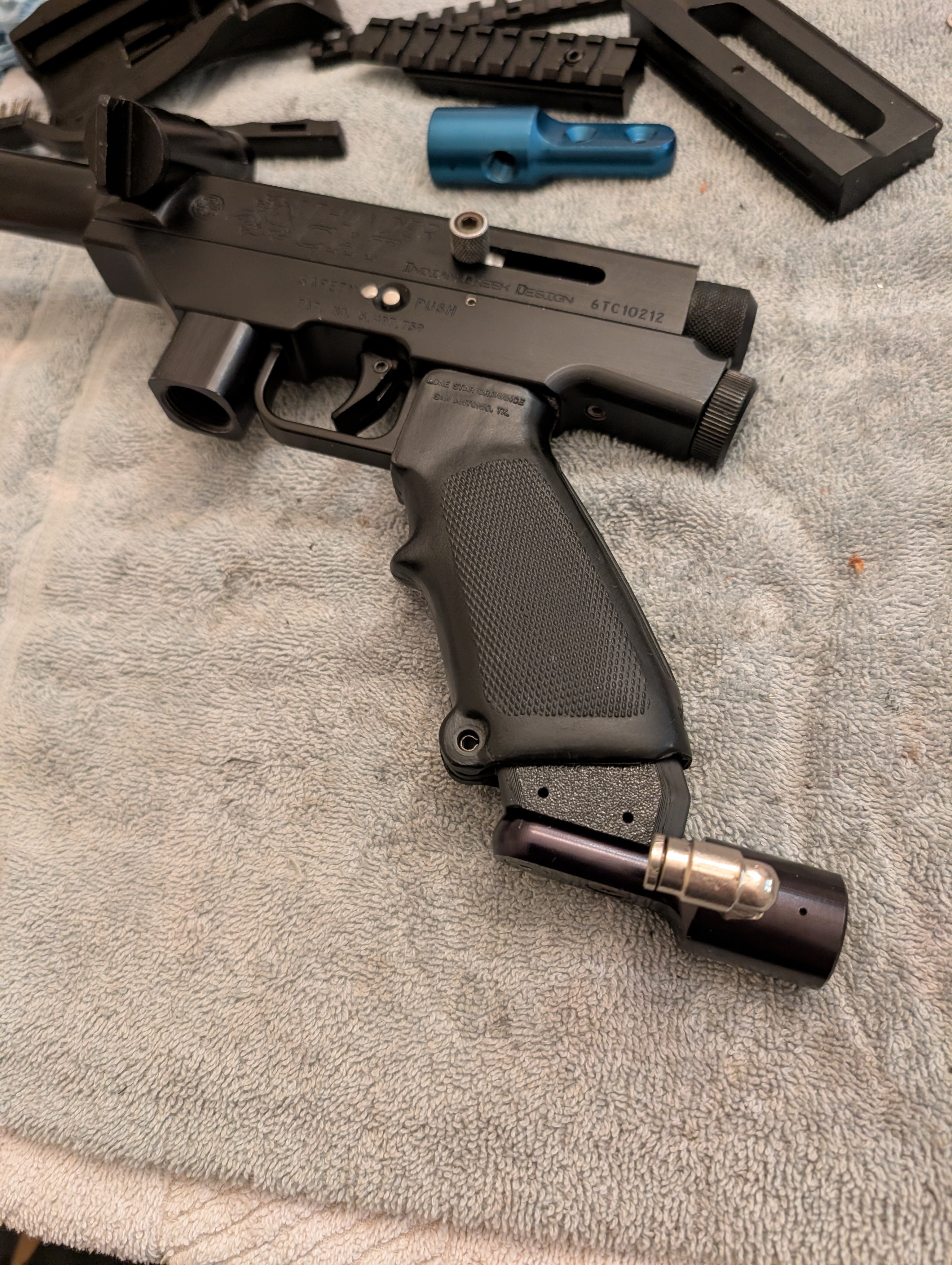

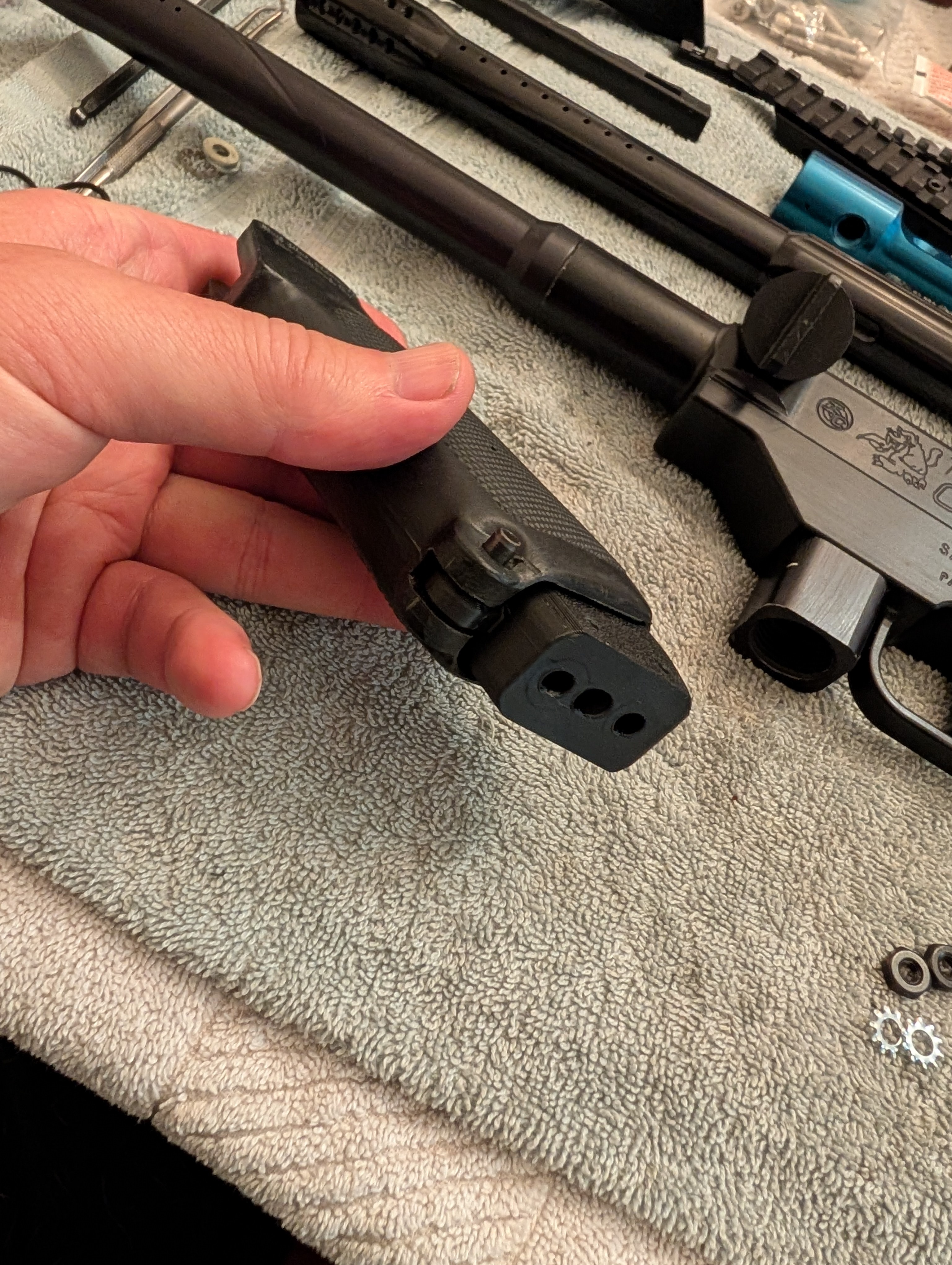

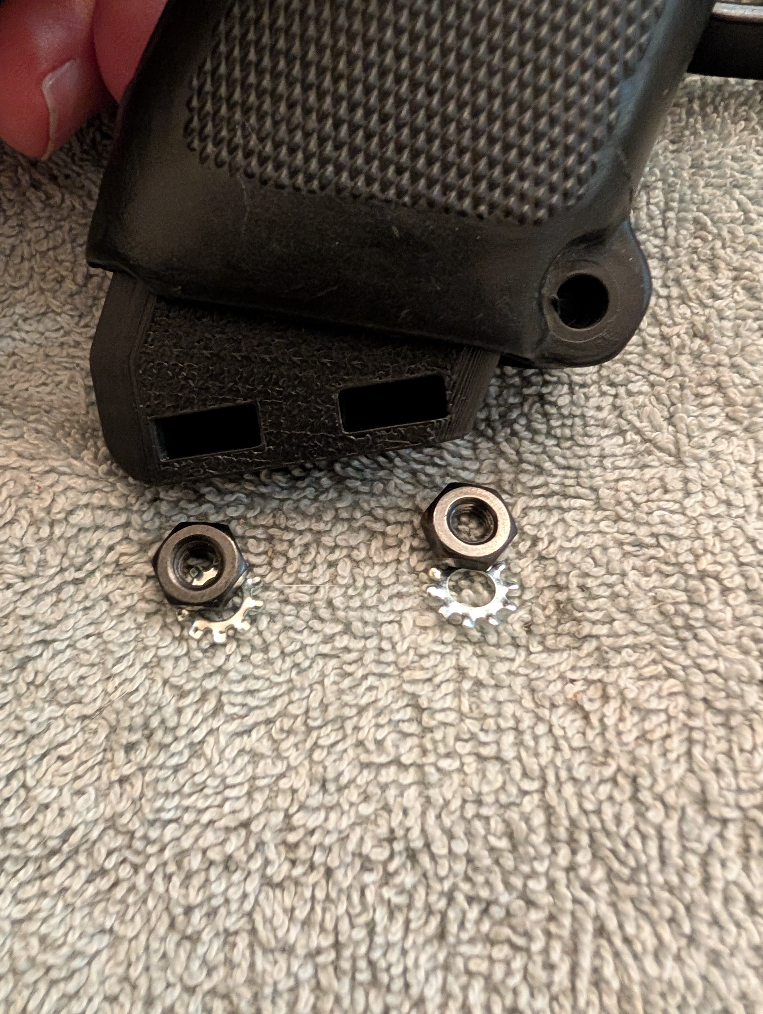

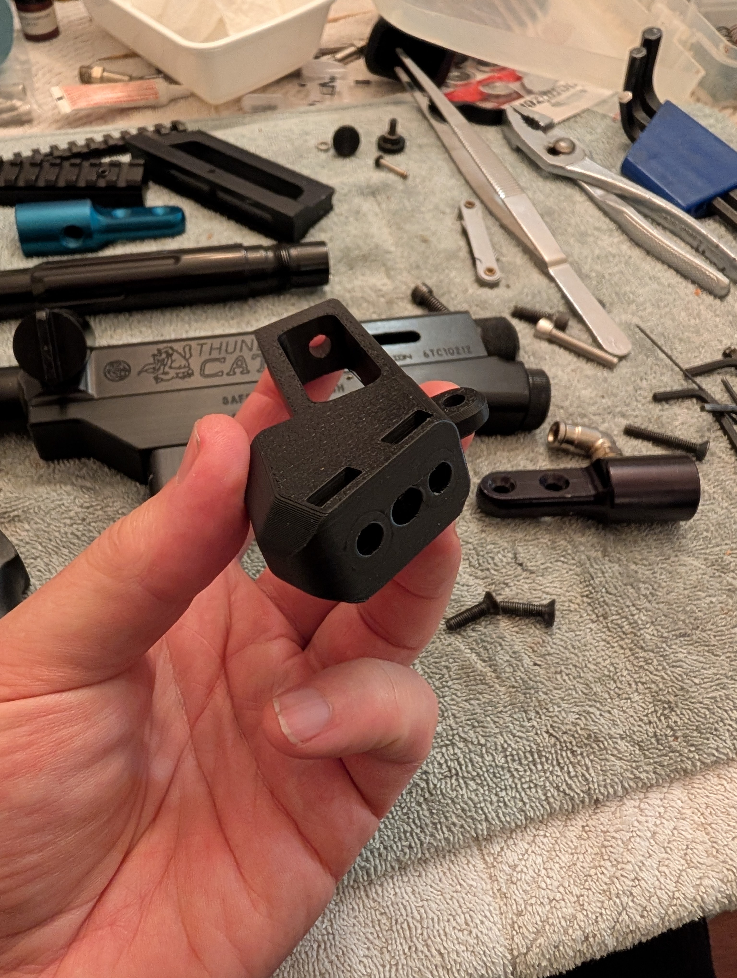

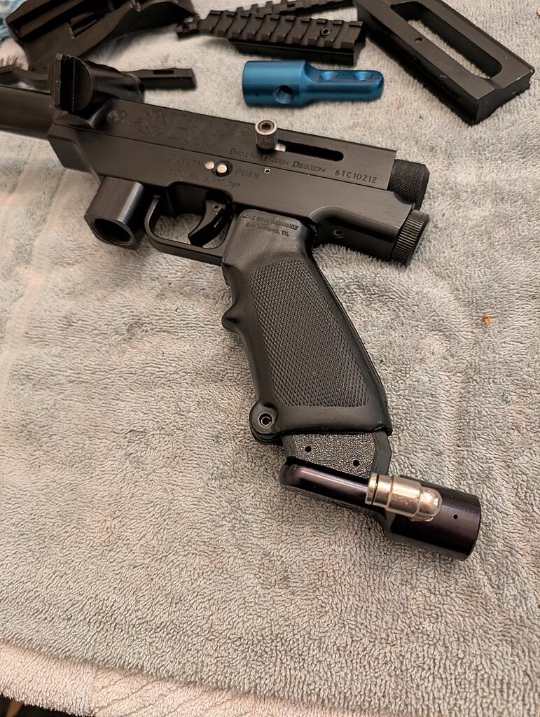

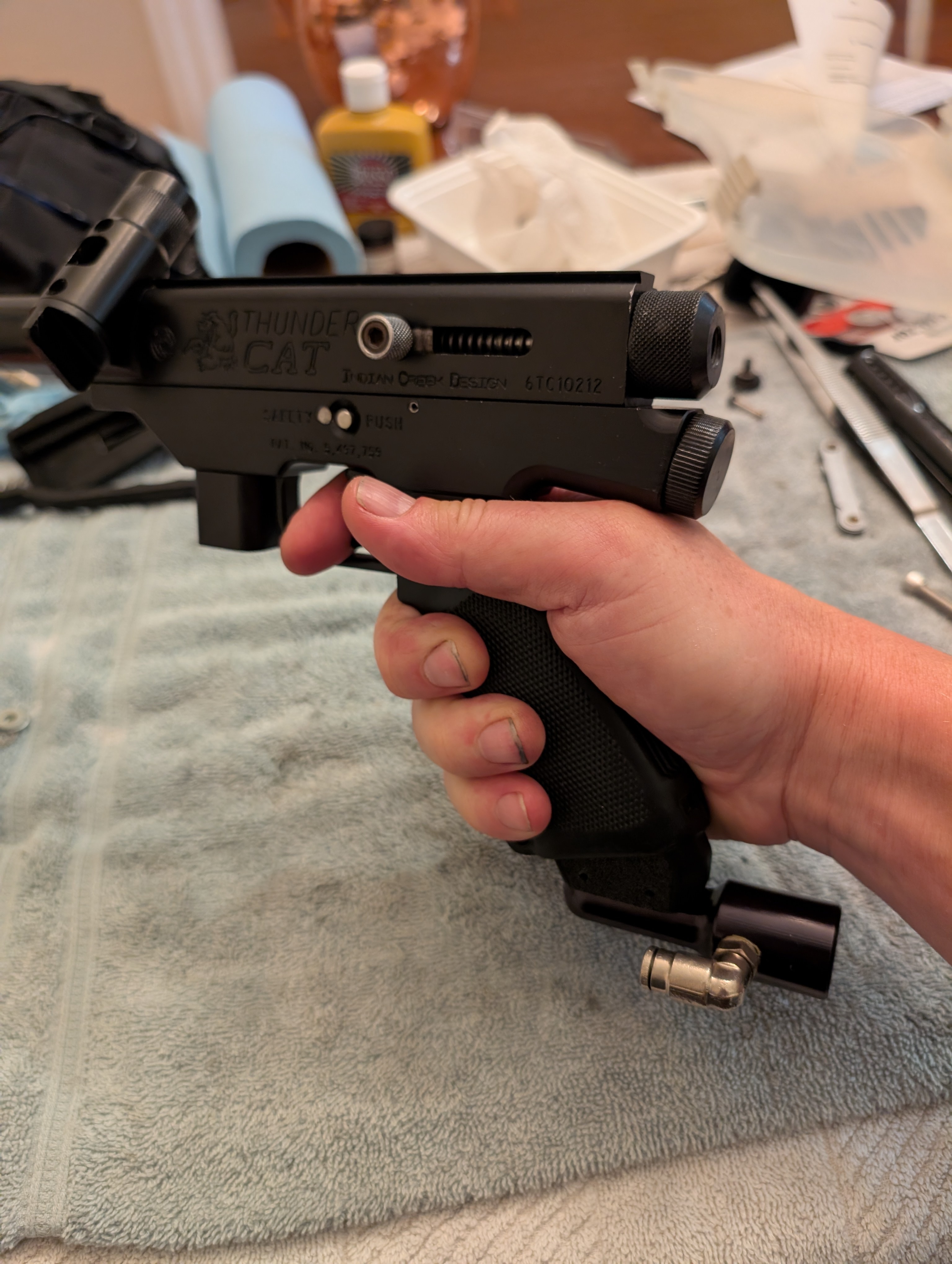

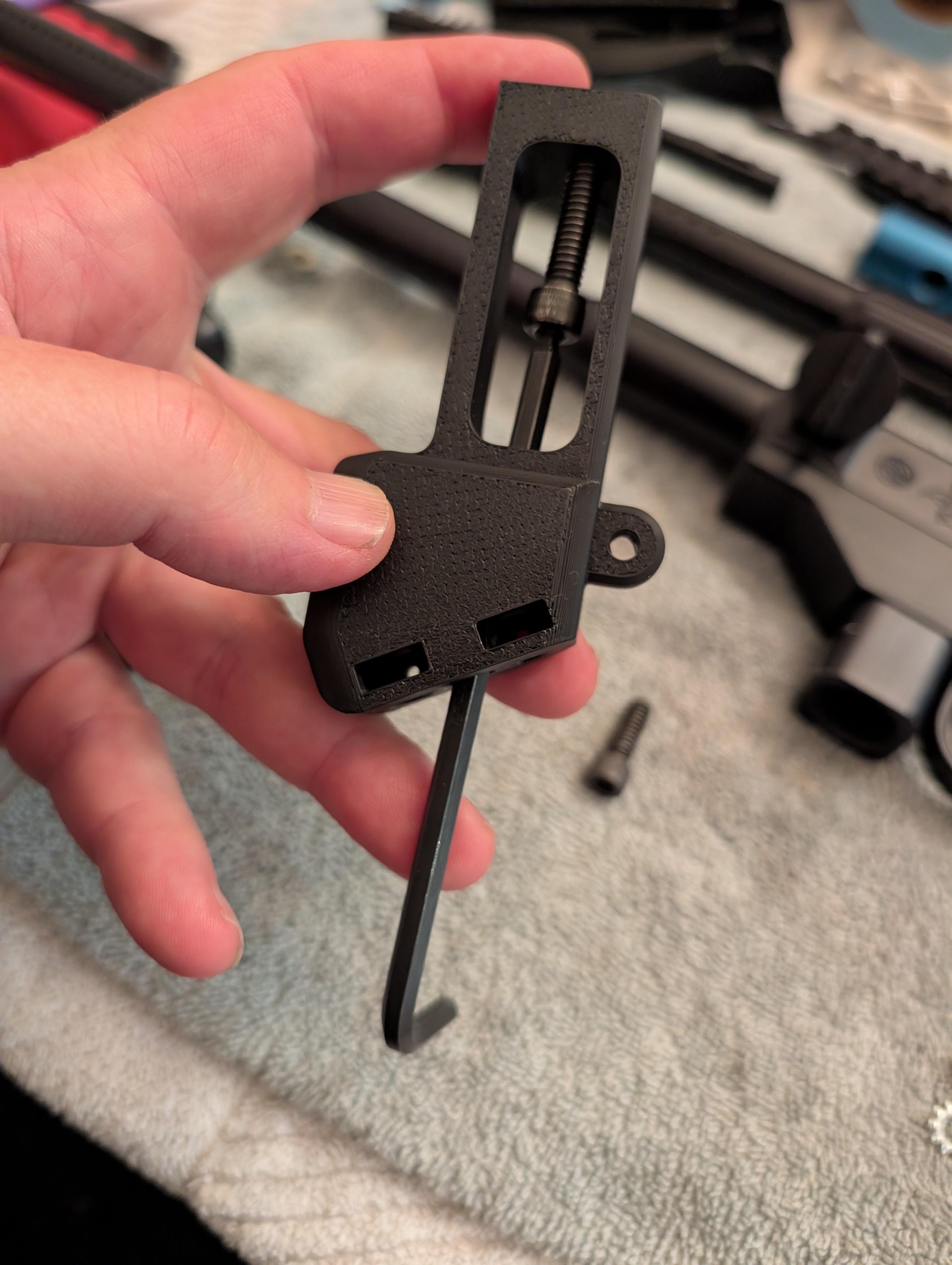

    So I have a few markers that use the Lonestar M16 'stowaway' grips. I've used CCI 45 grip blocks on a few, and I managed to get my hands on one of the old Taso bottomline adapters that has the 1.25 hole spacing. Thankfully superman was able to send me a duckbill asa to match that hole spacing, but I had a few other markers that I was wanting to put a bottomline onto. Also a few folks here have inquired, and I'm sure there are a lot of markers out there sporting these grips that would be better off with a bottomline instead of a back-bottle. I talked to my friend at work and he was able to create a modern version of the adapter with hole spacing to fit modern ASAs. I think it turned out pretty well, fits great and looks sharp, if you have access to a 3d printer (or a friend with one, lol) you can finally put a bottomline onto that m16 gripped marker.
    https://makerworld.com/en/models/313...fileId-3539110
    You will need a longer mounting bolt, and a couple of star washers under the mounting washers help stop them from spinning and allow the mounting bolts to tighten up nice and snug. Enjoy!
