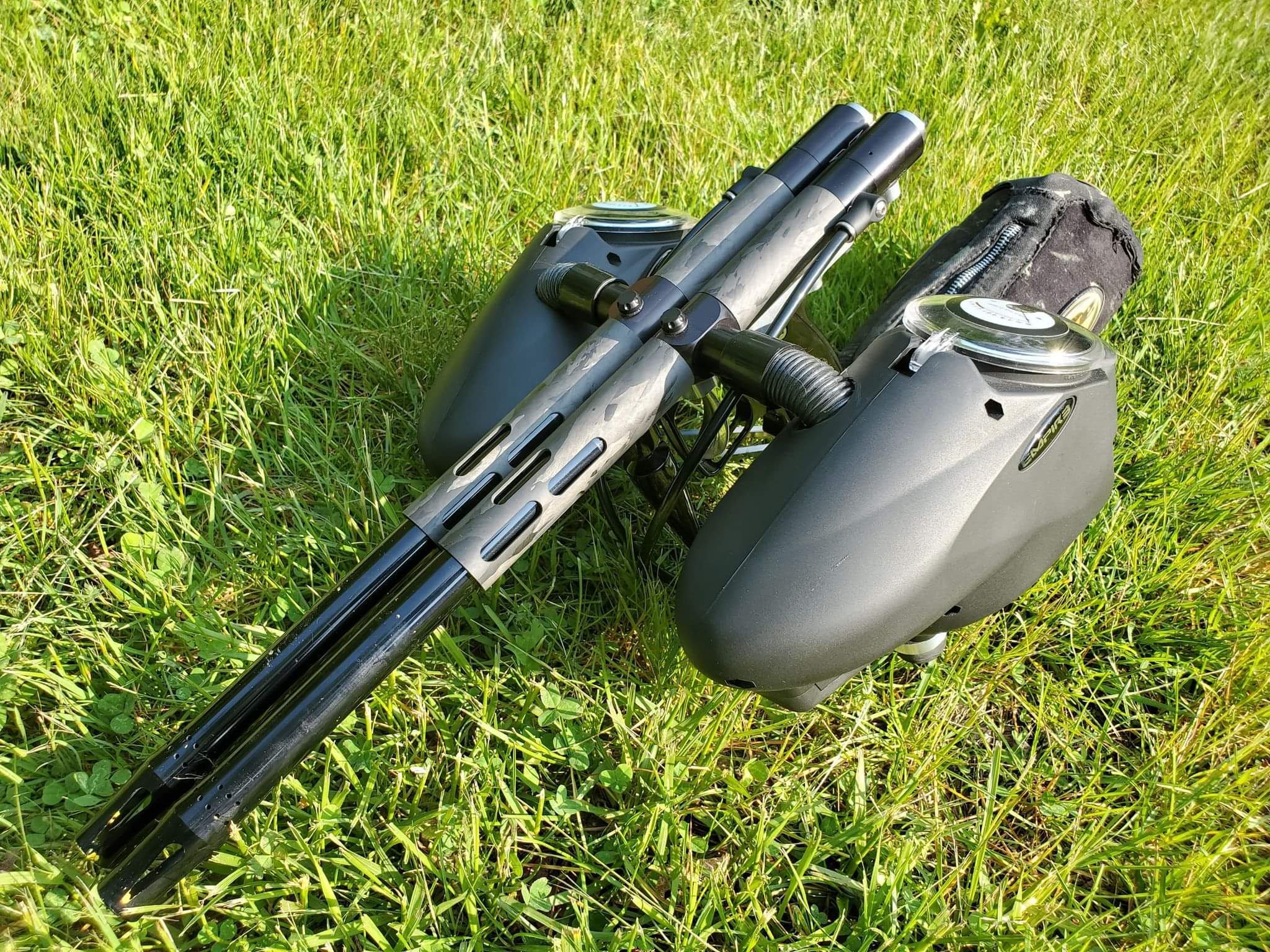

    Don't have many good pictures,
    • I designed the rail, hopper mount & M86v2 triggerframe
    • The bodies are camo carbon fiber which is semd to xmt to make monimag warp bodies for me.
    • The trigger is a sterling silver triggernomics trigger
    • Foregrip is a hand made spike.
    • And I modified both hoppers to feed upwards
    • Barrels are a matching set of Wwa Veritas
    • Both a normal and reverse xvalve.
    • Have since swapped it to stainless airlines incase I want to up the input pressure

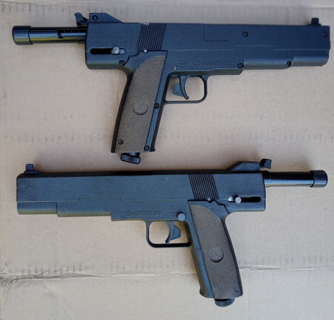

      (They come as a matched pair)
      Brass Eagle “Eagle 68” pistols
      Filled in all empty spaces with Epoxy Steel (lots of it), to reinforce the weak plastic bodies
      Removed self tapping screws and used machine screws & countersunk nuts (filled in holes)
      Sanded down body graphics (especially that weird “balls in flight” graphic)
      Body painted light textured black
      Painted grip panels textured tan (to look like separate wood grip panels)
      All new o-rings, and lubed properly (Brass Eagle recommended transmission fluid!)
      CO2 plug painted black
      ~285 across the chrono
      (Also have 12 loader tubes)

        WOW! You polished the hell out of a couple turds and made something awesome. Never seen one Eagle 68 look that good ,let alone 2!

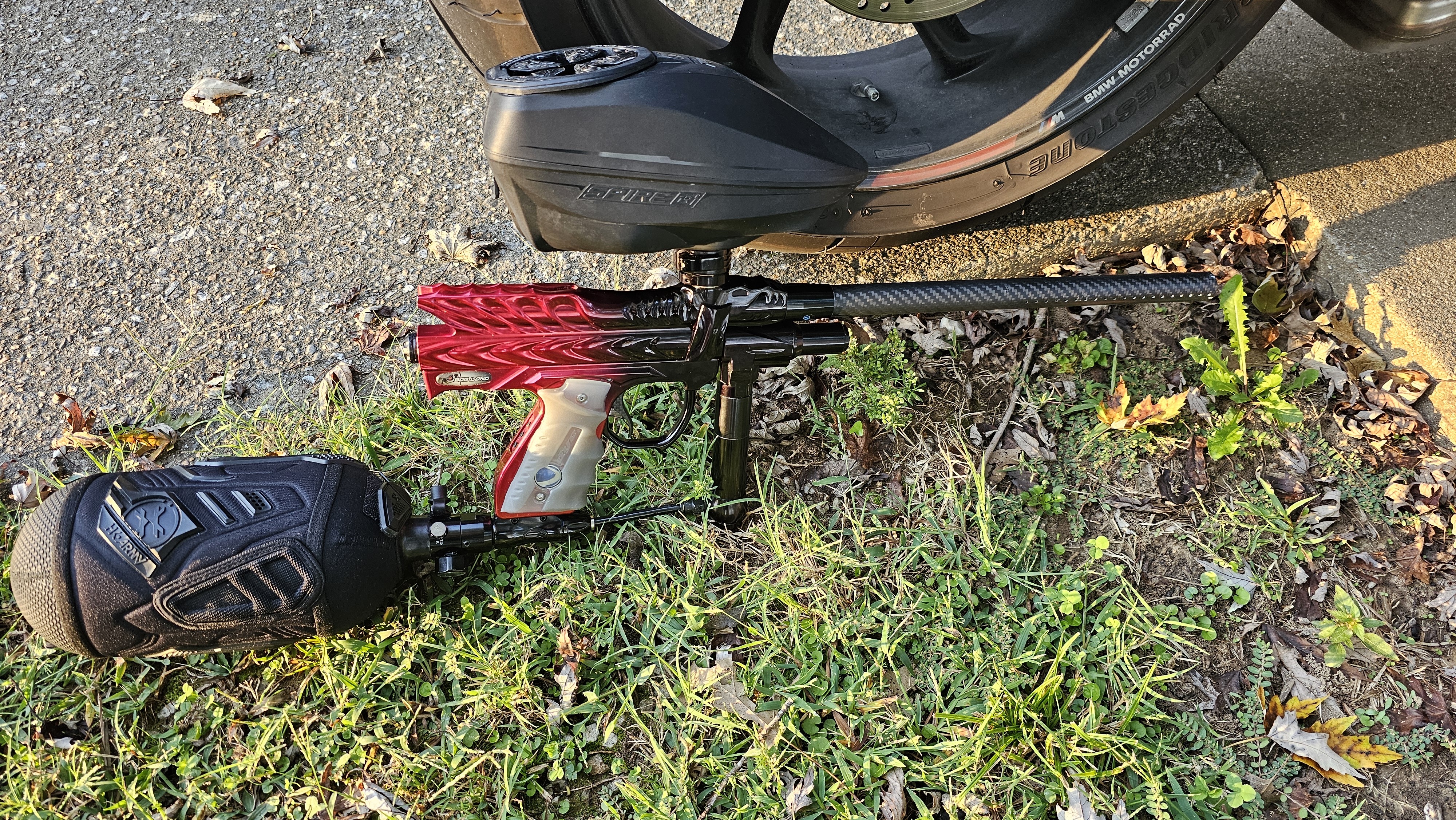

      2k5 Dragon Intimidator
      G6R feedneck
      Shocktech bolt
      Eigenram
      Kila stealth bolt pin
      AKA LPR and Sidewinder
      Scifi board
      Alias frame
      Techna Scythe trigger
      Deadlywind barrel
      Gear Drive ASA

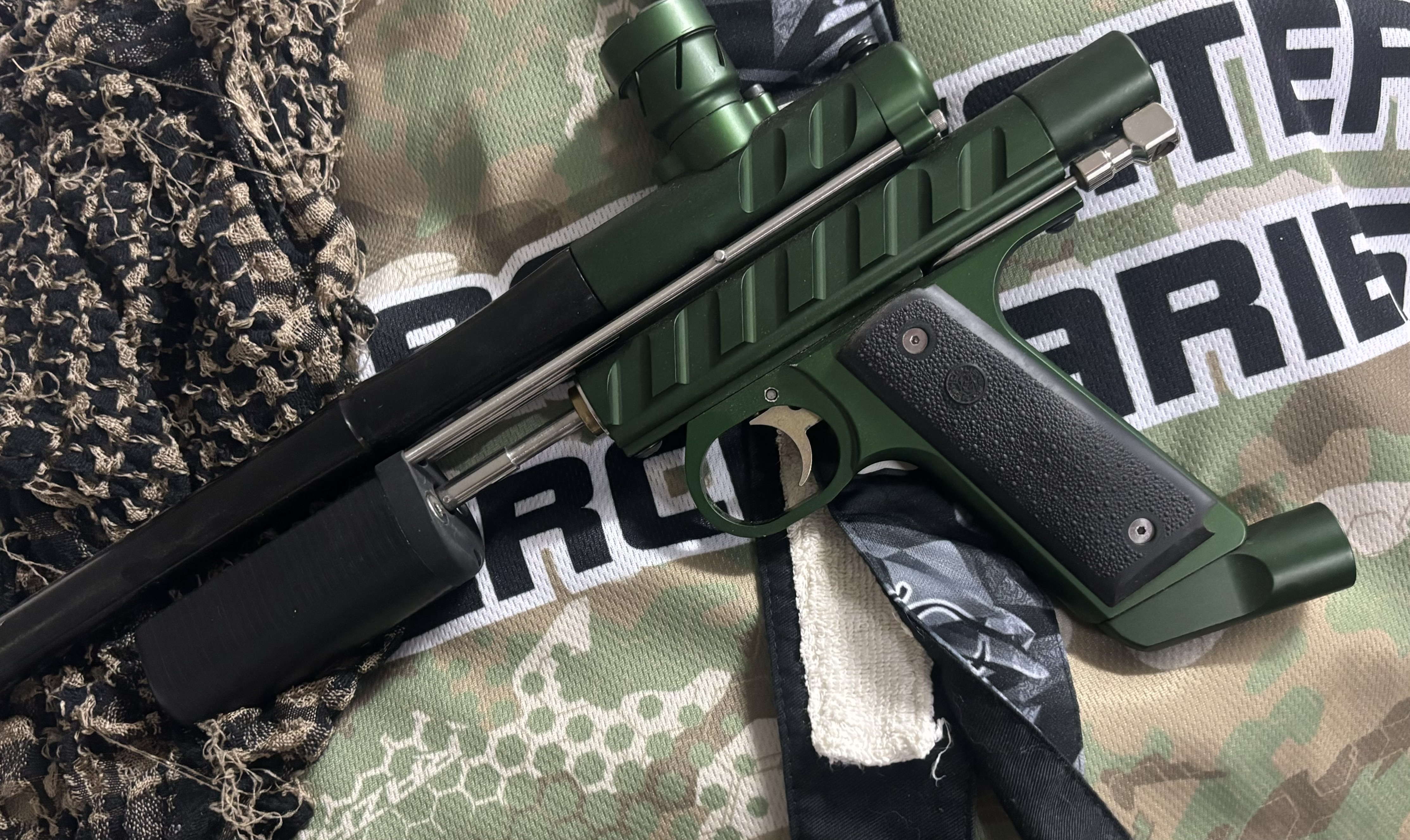

          Eeek… stiff competition already..
          T2 Sterling STP
          T2 upper tube
          T2 bolt
          T2 bolt sled
          Custom low pressure valve (all my tanks are mid to low output)
          Angry Antle milled.
          matching trigger shoe and 12 gram changer not shown.
          • ChuckLove
            ChuckLove commented
            Very cool!

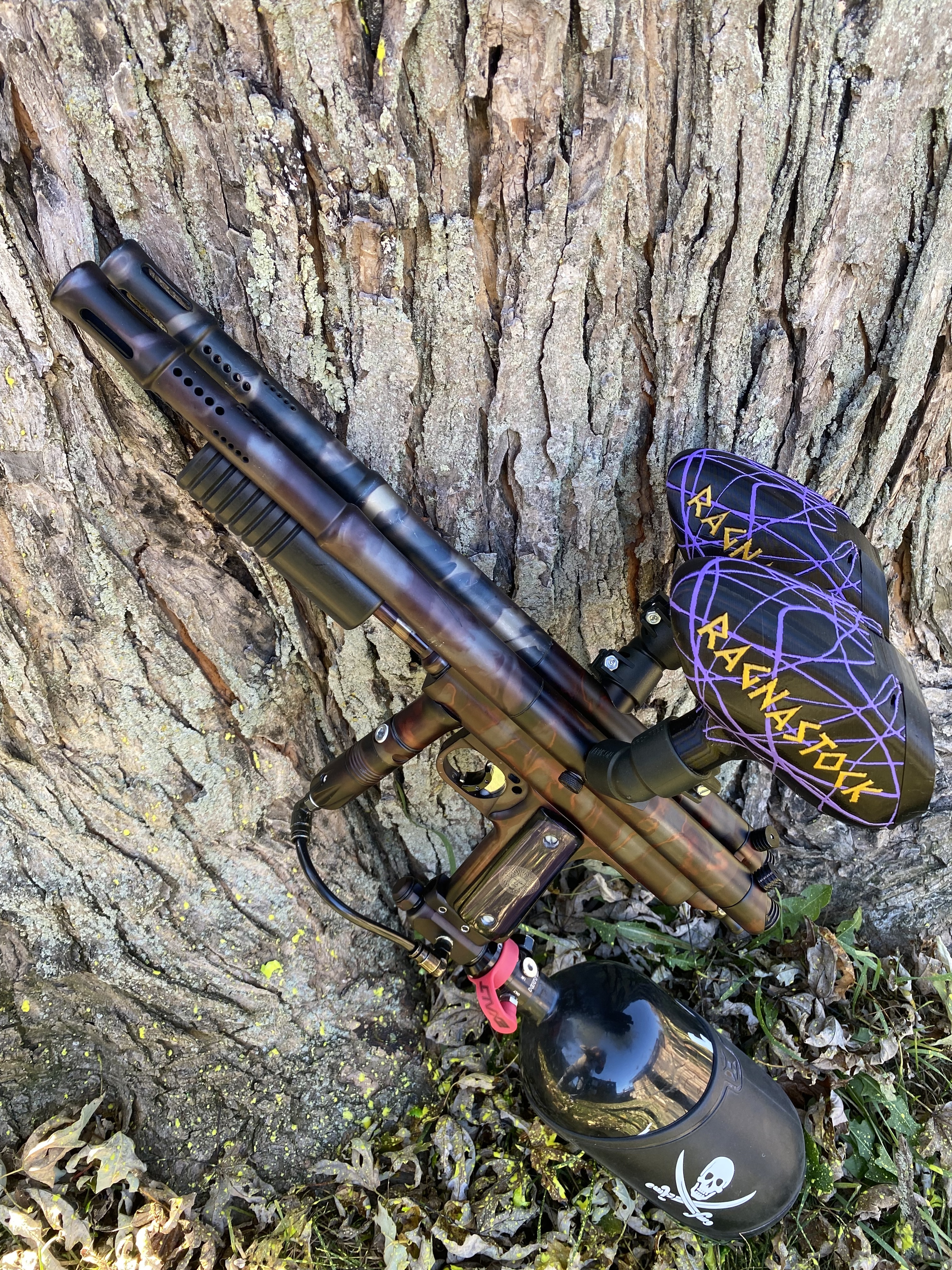

                  It’s a real tough one this month….but I’m going with NONOBLITUS That thing was awesome before his post-apocalyptic ano job, now it’s so much more bad-ass

                        I’m going with JeepDVLZ45 this thing is ridiculously amazing. The Ano is unbelievable when you’re holding it in the sun. So awesome
