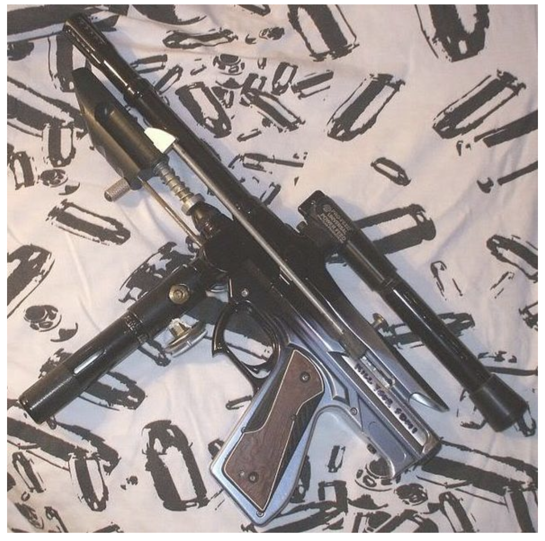

    Older photo because it's buried in bins right now... But I still own it just has an electronic interup auto trigger now.
    The Anachronic. A rarer 05 lasoya intimidator converted to a pump.
    https://youtu.be/YFp2MNLlymo?si=GddCn_g8n7_YcdCt
    • russonti
      russonti commented
      omg i want one. i don't even play pump... yet

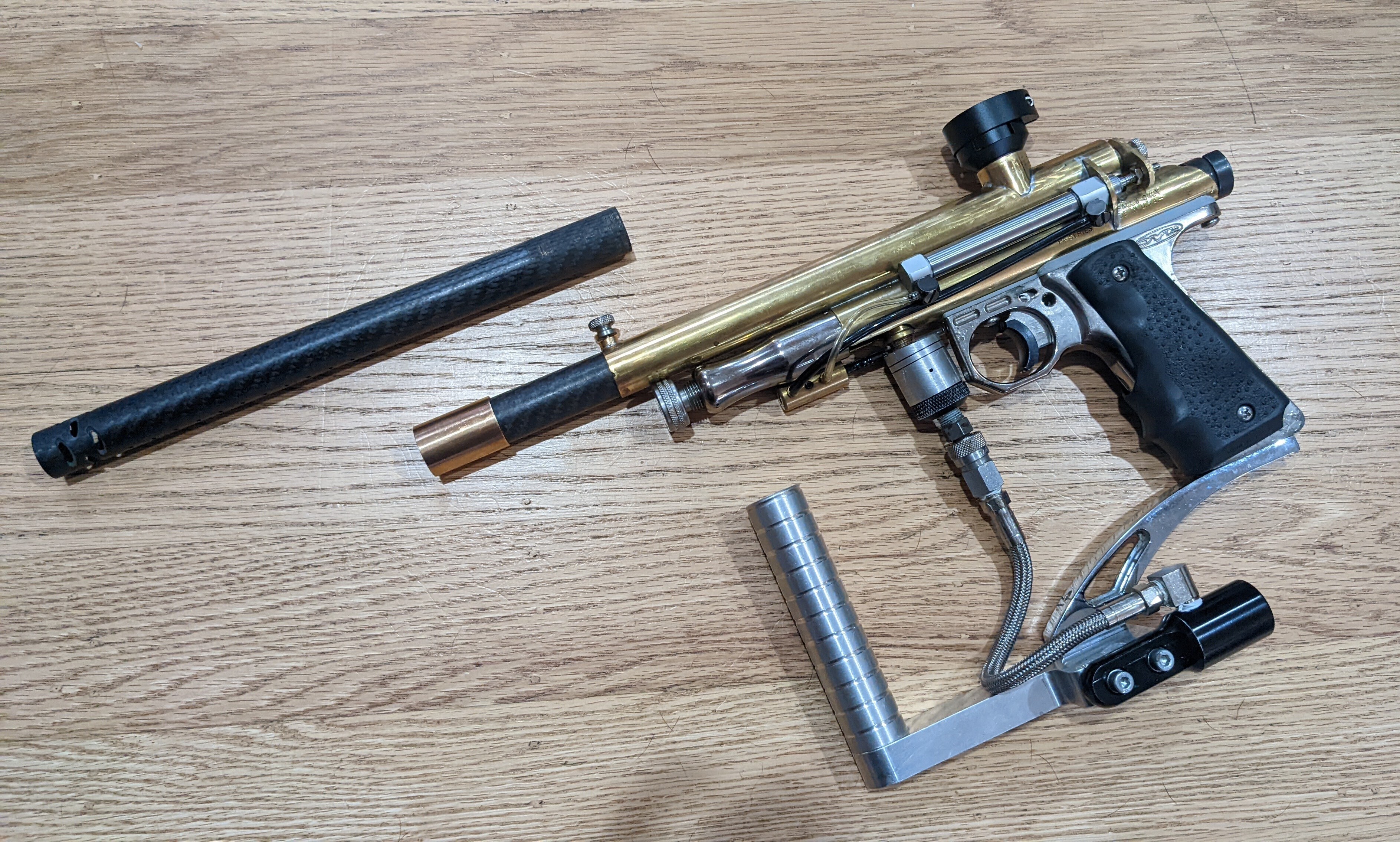

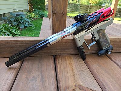

      Here is my PGP.
      It takes freak inserts in the body and has 2 stiffy barrel tips that hold the insert in place. The 3 way is attached directly to the lpr with a custom fitting (no front block).
      image_92441.jpg ​
        XEMON commented
        Let me know if this works
      • Riot
        Riot commented
        XEMON looks good! Ty

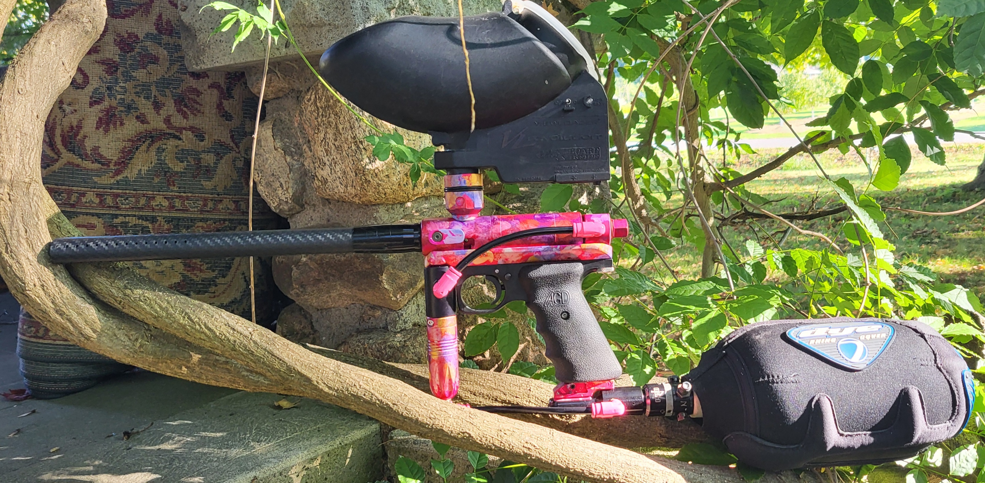

      Here is my Tippmann 98 custom I converted from mech to electropneumatic using a Karnivor frame.
      Parts list
      -Natural Newbie design Ram with 2x eclipse qev
      - Karnivor Worrblade frame w/ Samurai trigger
      -Dm4/5/c board w/ predator chip(also have tadao chip squirreled away)
      -Dm4/5/c laser eyes
      -Alias Timmy solenoid
      - Low pressure kit(with blowback function removed)
      -Vertical adapter drilled and tapped for Lpr
      -Palmer lpr
      -Hybrid Push button on/off
      -2k5 Superstock/Black Magic reg
      -Rufus Dawg center feed
      -Super-light 10 gram hammer.
      -cocking slot filled in
      -custom milling(still supa heavy)
      -Cheetah print powdercoating
        Jordan commented
        That is amazing, good sir.
      • BigRed
        BigRed commented
        Awesome build…would love to see the insides!
      • russonti
        russonti commented
        This is fantastic. I would also love to see the insides as well as see it shoot. Great work!

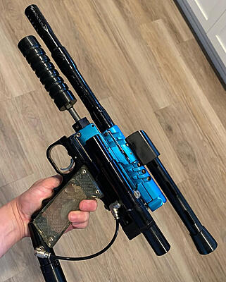

      I'll bite. Double barreled mech ion has a custom hopper that's 2x ricochet hoppers sawed, n glued.
      • russonti
        russonti commented
        You know, I have a nice ion that I just converted to mech and waiting for an asa to come in to post it in this but come on... how do i compete with two ion's?!?!! But seriously, this thing is awesome! I would love to shoot this. Like most likely crying from laughter and joy with every shot

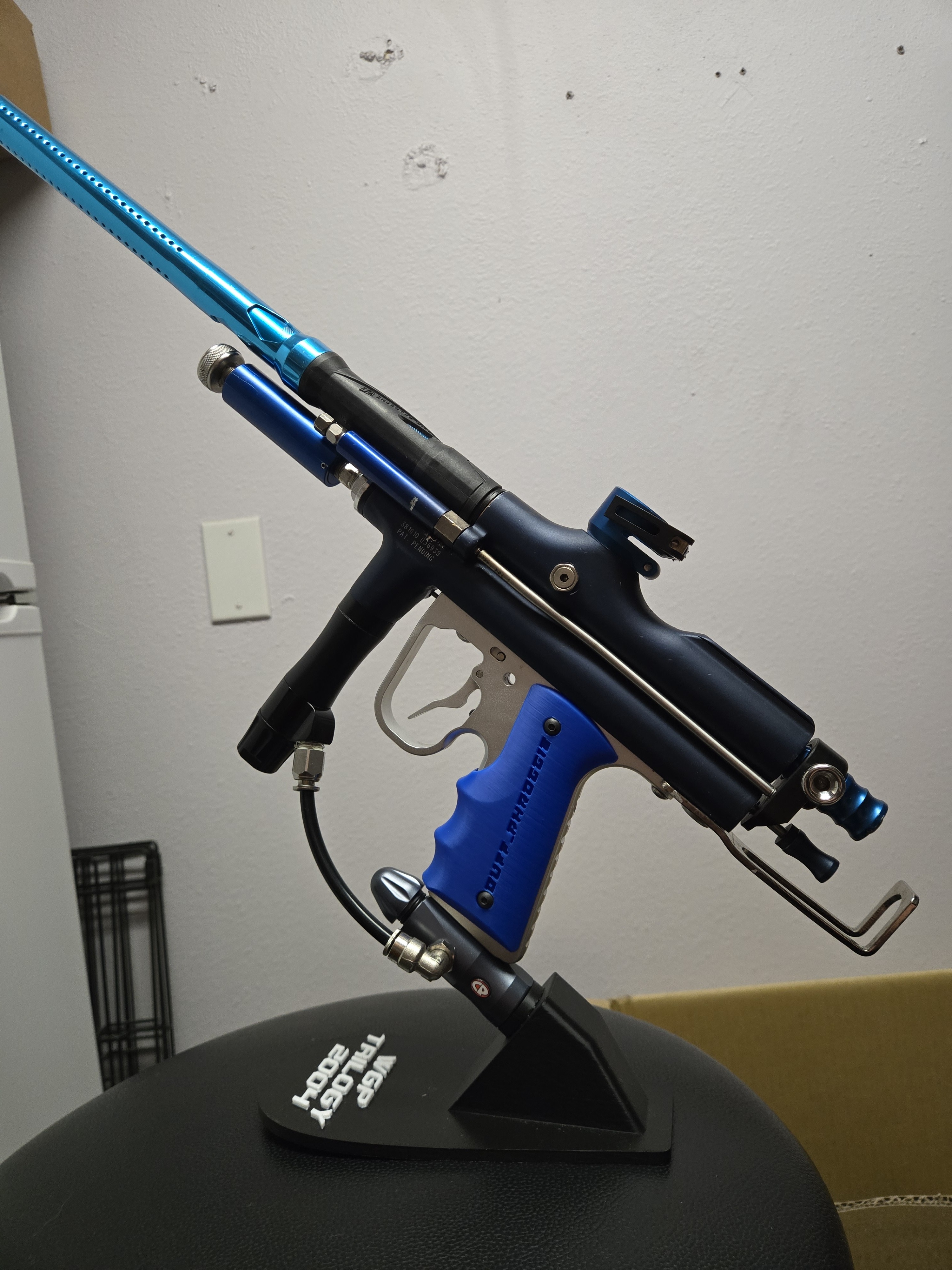

      My first autococker. It started 100% stock befor I got it.
      Currently has all the TechT parts on it, some random mismatched blue ram and lpr. Some translucent blue hose. ID feedneck (cut by BMC). Current internals are lazerus valve and jenni kraig hammer (angry paintball) and a random bolt. Cool slim frame I traded for som work with a roller sear, and cusyom printed grips.

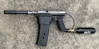

        Not sure if this counts because I didn’t do the conversion. I’ve plinked 500+ FS so far through this mag, shoots as good as my EMF.
        • NONOBLITUS
          NONOBLITUS commented
          These are so cool.
        • Super Nova
          Super Nova commented
          I want one of these GhostFlanker/Anson minimags bad

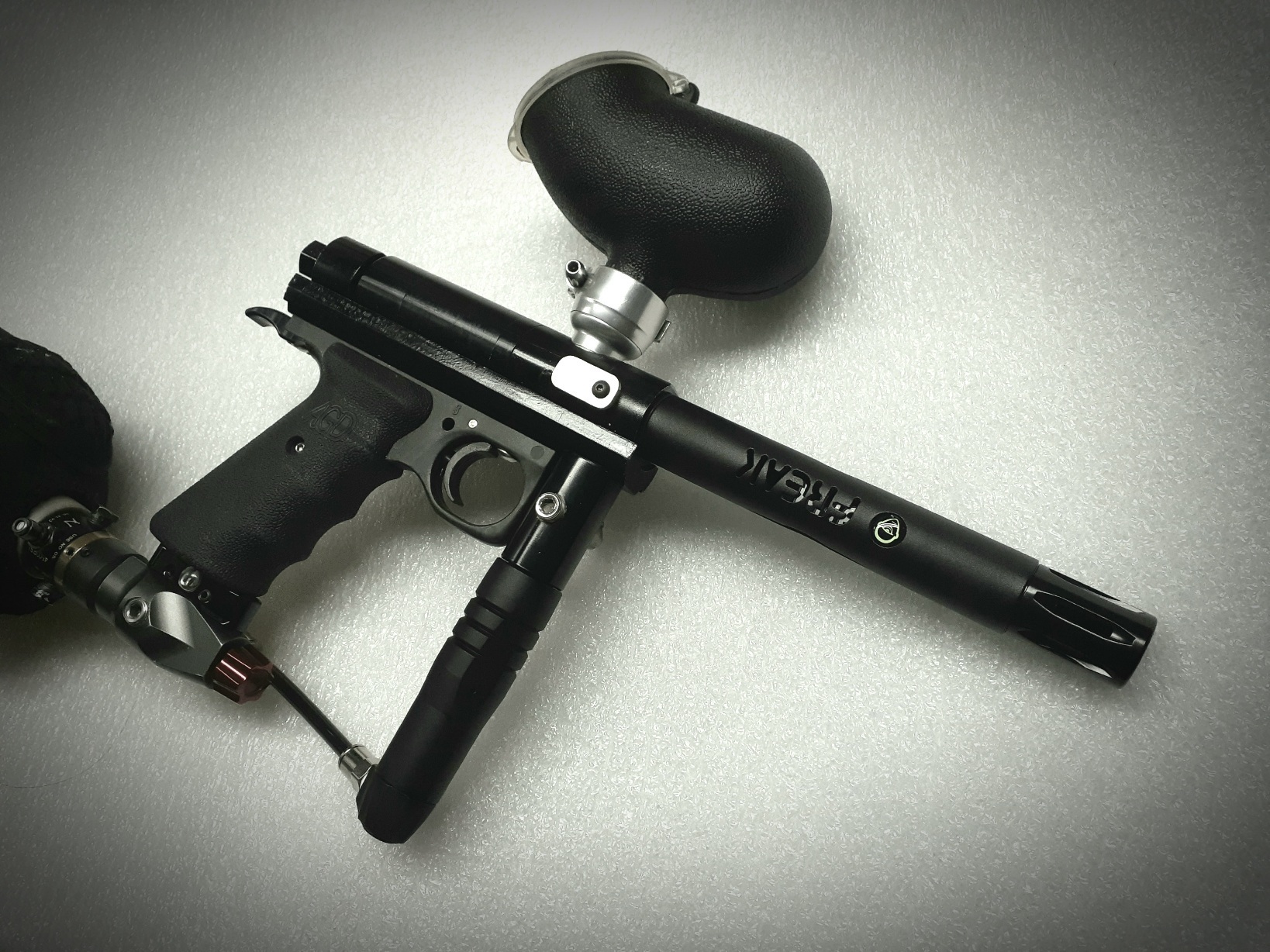

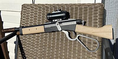

        I will try and replace this old photo with a nicer pic, but here’s my placeholder for now. Mare’s Leg Hammer 7 conversion from Layer Lab (I think I’m recalling that correctly).
        • GanonsGrin
          GanonsGrin commented
          Photo updated, click it for a Higher res image

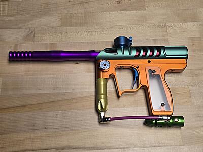

          This one's for you neighbor!
          I built this Skittles Ion a couple years ago. I love 90 degree triggers and always wanted to build this gun but wait too long and ans gear ran out of matching body/trigger frame colors. So i built it with mismatched colors anyway and called it the skittles ion. Then at ION this year i met some awesome fellas that not only invited me to MCB! but also told me about mech ion conversons and told me that i should mech this ion. Sooo a couple months later here we are. I did upgrade the firing can and shout out to my dad and his machinest coworker for doing twin tail bolt o rings mod so it doesn't dump air when the trigger is held down. Shout out to PewPew_Mike for making me custom clear grips for the ans trigger frame. And i do have a red cp on off asa coming to replace the green one since i changed a bit of the color scheme with the firing can and new feedneck, but usps failed to deliver it today. So just imagine the asa is red for now.

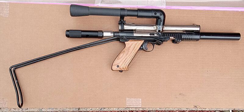

          Does this fit the category, as it started life as a bolt action basic Nelpot 007?
          quick strip slot
          slotted right side
          double tapped bolt
          dual armed pump handle made from broken Nelspot pump handle
          CCI Paintball red main spring
          Lapco #6 powertube
          Lapco valve retaining screw
          Black Magic valve cup seal
          WGP trigger shoe
          Nelspot wire stock
          7.5” extended barrel
          back bottle adapter
          12 gram bucket changer
          welded in hopper adapter
          horizontal feed adapter​
