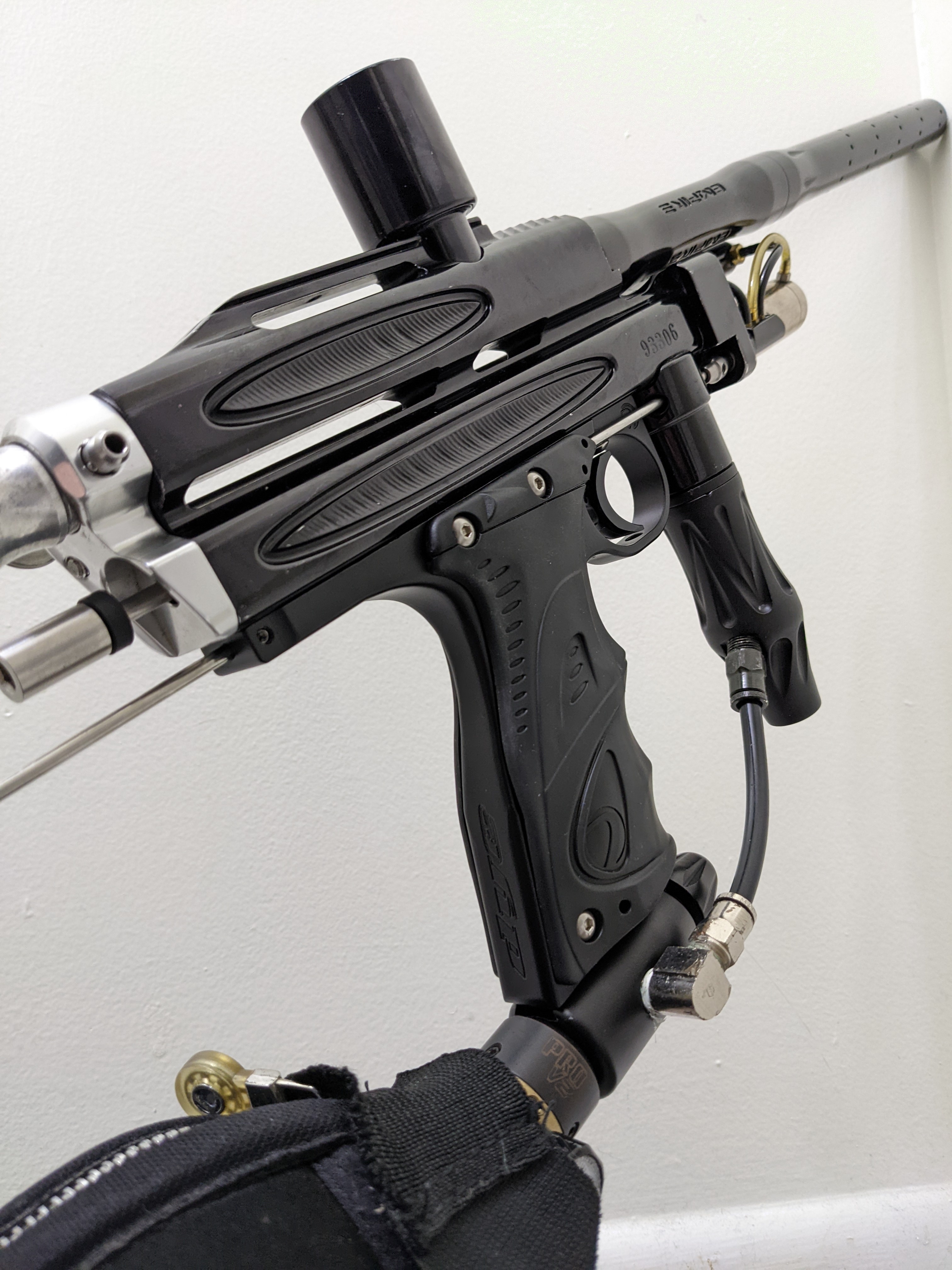

          Wanted arrived today I swapped it onto my Inception Kryptonite Sniper to give it a try. This frame is really comfortable in the hands!

            Ohhhhh sweet christmas... I need to go change my shorts...
            I should have got one of those when they came out. I ended up getting a ripper body instead and I kick myself every time. Right after I built my ripper everything came out in that style. While the Kryptonite is still a unique look. That’s a really nice build!

              I think I'll be letting mine go after having it mounted on a gun. Here are the reasons why:
              + When shooting right handed, I pull the trigger on an autococker with my middle finger. When you try to do that with this frame it feels awkward due to the finger grooves. With that said, it feels amazing if you hold the frame as intended and pull with your pointer finger.
              + The trigger leaves a lot to be desired in my opinion. I will say that the trigger plate has less side to side play than the plate that came with my 2018 Millennium. The UL frame when mounted on a sniper struggled to achieve a decent pull despite attempting multiple different hammer lug depths. I'm sure with more time, effort and different springs it could be improved if desired.
              + The T-Slot ASA mount limits what On/Off can be used without purchasing more parts. No way to mount a POPS or EZ on/off directly or with a universal rail.
              With that being said, it still could be a great frame for most people. I'd probably swap out the plate and springs and look into polishing if the finger grooves were more mellow.

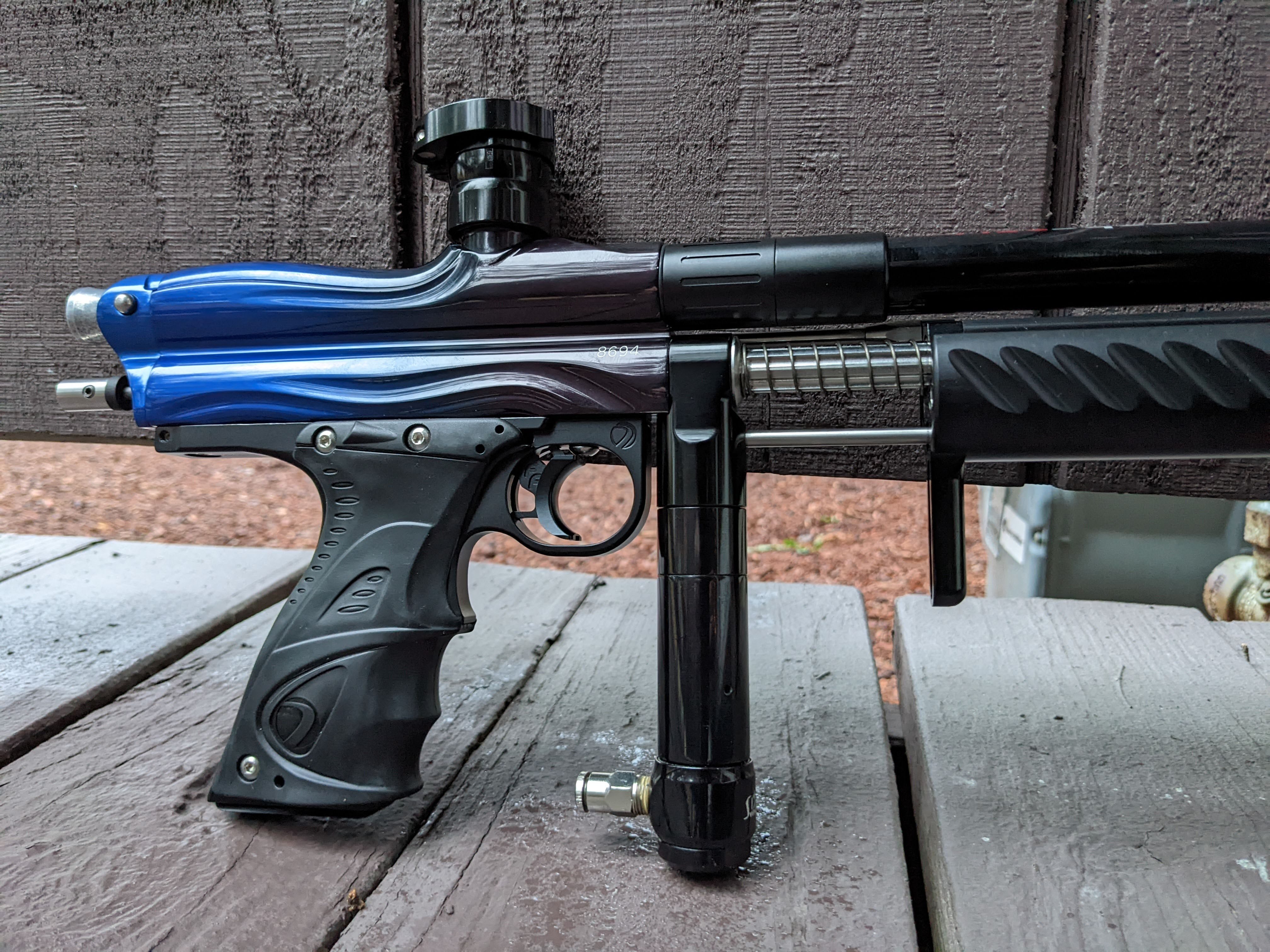

              I got mine mounted on my S5. I have no mechs I’m willing to mount it on ATM. I took it apart to inspect and lube. Four drops of oil (AKA Extreme Lube), and spending some time with the set screws In fairly happy with the feel. I think replacing the front screw with another brass tipped screw and some time polishing parts would turn this thing into a stunner. But that’s the same for all frames out of the box IMO.
              The UL frame shape is a Classic at this point and feels great.
              The dovetail rail system in 2022 is definitely antiquated, but on the flip side anything but a Dye ASA on their frame is sacrilege.
