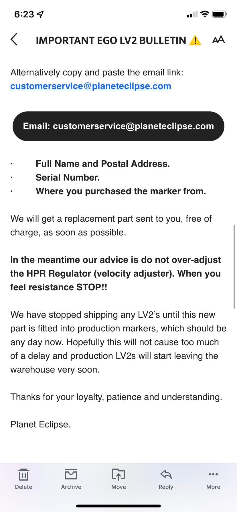

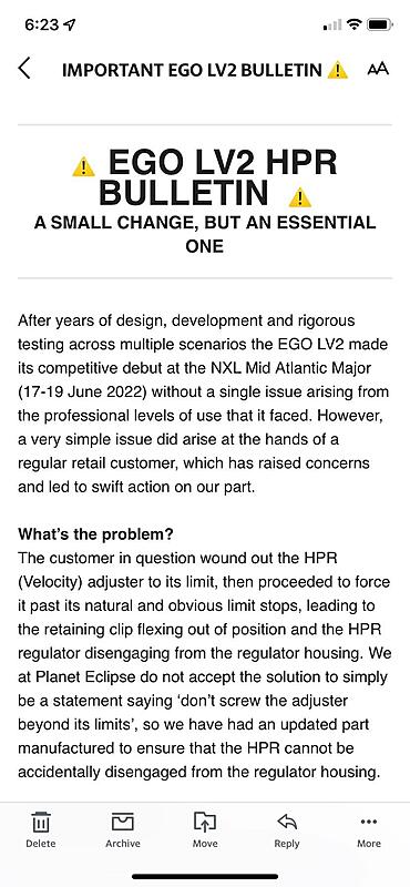

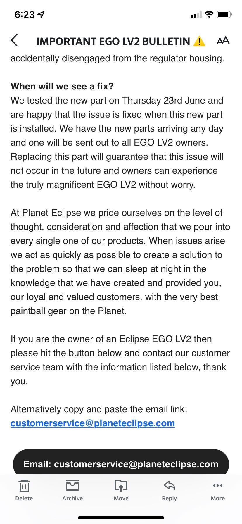

    Saw this on FB this morning, figured I'd post here as well. Seems there's a potential safety issue with the HPR adjustment going too far and causing the HPR to unseat itself from the body:

      "PE LV2 Voluntary Part Recall:
      Backing out your HPR velocity screw too far can cause unexpected and dangerous behavior. We have created a replacement part to fix the issue. Please contact us if you have an LV2"
