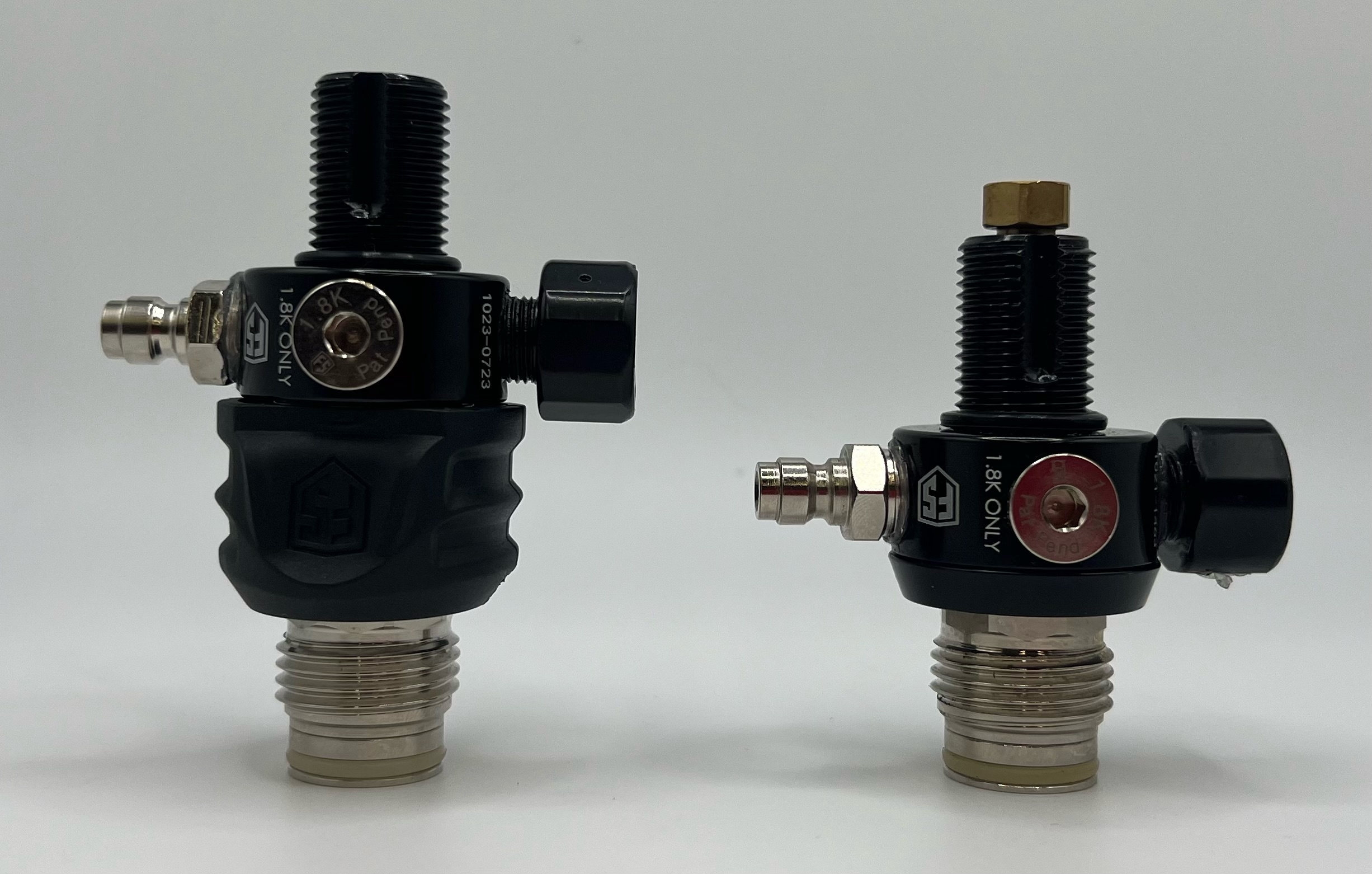

    I went looking for a rebuild kit recently for an older Hero regulator, and was told they have new regulators coming out. They are running an upgrade special, so I got one. Haven't seen it mentioned anywhere, their website is still updating, and google searching didn't turn anything up. I haven't aired it up, assume it's around 600-800psi default. Springs were greased. This was the informal quote about what was different:
    "The new reg uses the same internals as the Hero2, which means if you wanted to get a new Anti-Hero (and warrantee) you would have another reg to use for spares if needed. Those spares will work on all the regs you have. The brass reg seat seat seal is not used in the new reg so it is less problematic in that area. The grip for rotating the reg is easier to grab and more user friendly "
    Obligatory Pictures:

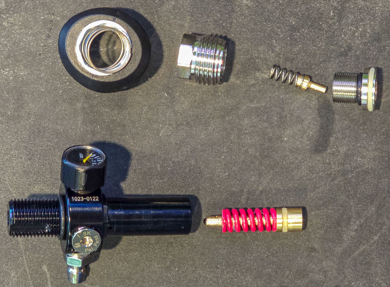

            Looks like the reg-seat/spring is the same unit, but now presses against aluminum body instead of brass plug, but more importantly, that unit is swappable on the older hero regs, so you should be able to rebuild the old regs with the new guts. Using the hero2 on a 9ci is my use case also, it matches the old 3.5oz tanks in height on a VSC phantom.

                Fill nipple is now wrenched from the outside to remove vs allen key down the inlet, this does make it stick out a bit more. My FS regs are all "p3" or "p2" units, not the hero2's, still same guts, just different variation on the body adjustability. I never had issues with the regs on gear, but most stuff is double regulated. I know the reg-seat was the failure condition for many people, so perhaps this is one of the design changes that was done to alleviate issues.

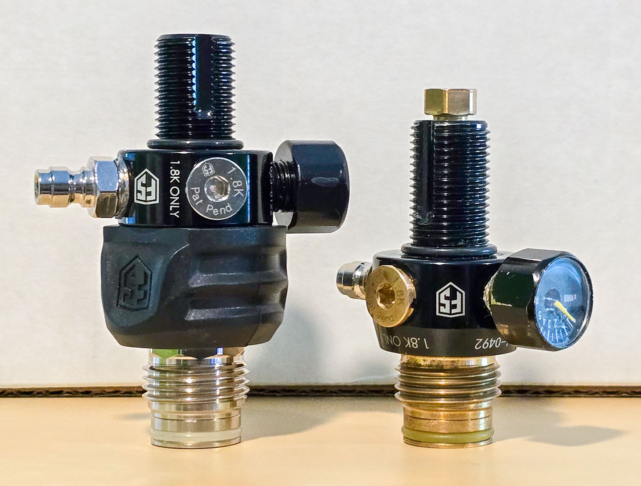

                  Yeah, the Hero reg's are from the Guerilla Air, my sample in the image is basically the FS labeled G3/P3 reg - https://ansgear.com/guerrilla-air-g3...lator-4500-psi
                  Here's a picture from the Renatus Team (formally FirstStrike) that shows technically a Hero2 regulator with the slightly different collar, that's magnetic.
                  The P3 reg required you to unscrew the top and adjust, and rescrew, so not really dynamically adjustable.
                  Both options allow you to spin the bottle to avoid intake-wrist collision
                  The cheaper, not adjustable - https://ansgear.com/guerrilla-air-m3-tank-regulator-3000-psi-tank-standard-output
                  Video Demo - https://www.youtube.com/watch?v=15na8qJ--zw
