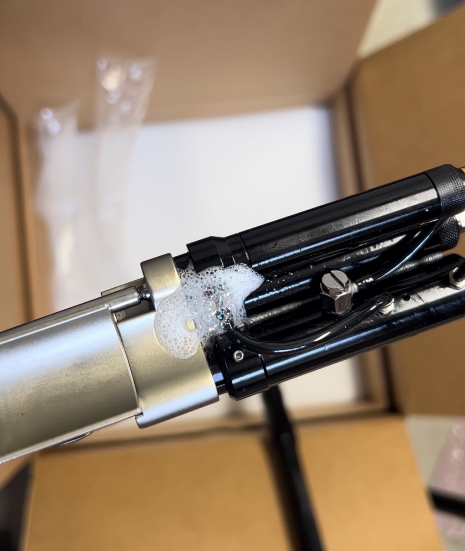

      I really wanted to take it easy on nova since the hurricane. Ordered a NX1. Like usual Nova fashion for all 3 markers I have purchased NEW, was leaking out of the box. This one had a split ram barb and leaking cup seal. I did not receive a tuned marker. Back block length was not set correctly. timing was too tight, pump arm threads extend into the body causing rub and damage. I doubt anyone tested it before it shipped. no way to miss that leak. I like the 3way idea, the finish on the body was nice, and it did shoot 300fps with the leak.
      docfire lets see how things proceed.
      some bubbles to find the leak
      Click image for larger version  Name:	IMG_0676.jpg Views:	0 Size:	320.9 KB ID:	603460
      pulled on the hose without much force and it cam right off.

      • zinger565
        zinger565 commented
        I think TJ just sees your name on the order and goes "ah, he'll figure it out, no need to test this one" lmao.
        In all seriousness though, disappointing for sure.
        It is funny (to me) how much people punch down on Nova for a $500 cocker when the "big boys" can't even ship a marker release without some sort of issue.
      • latches109
        latches109 commented
        zinger565 100% I can fix it, not a big deal. Just reporting the condition for others, so you know what to expect. The value is there for the price. I like to support small paintball companies and I'll continue to buy Nova stuff, even though they send me leaking markers.

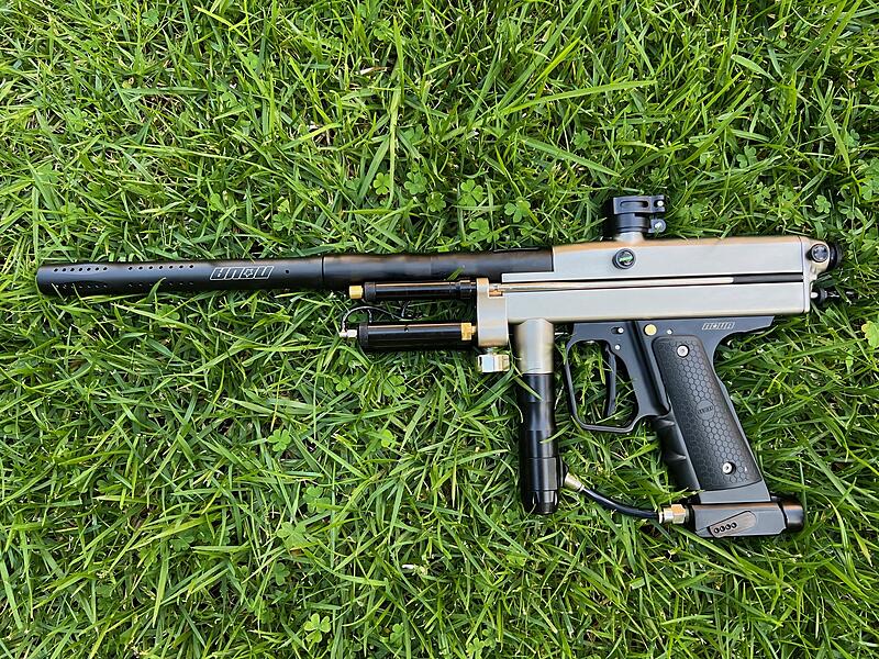

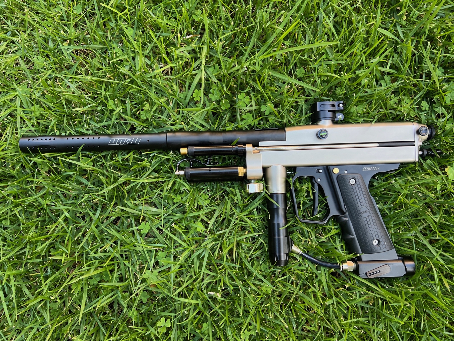

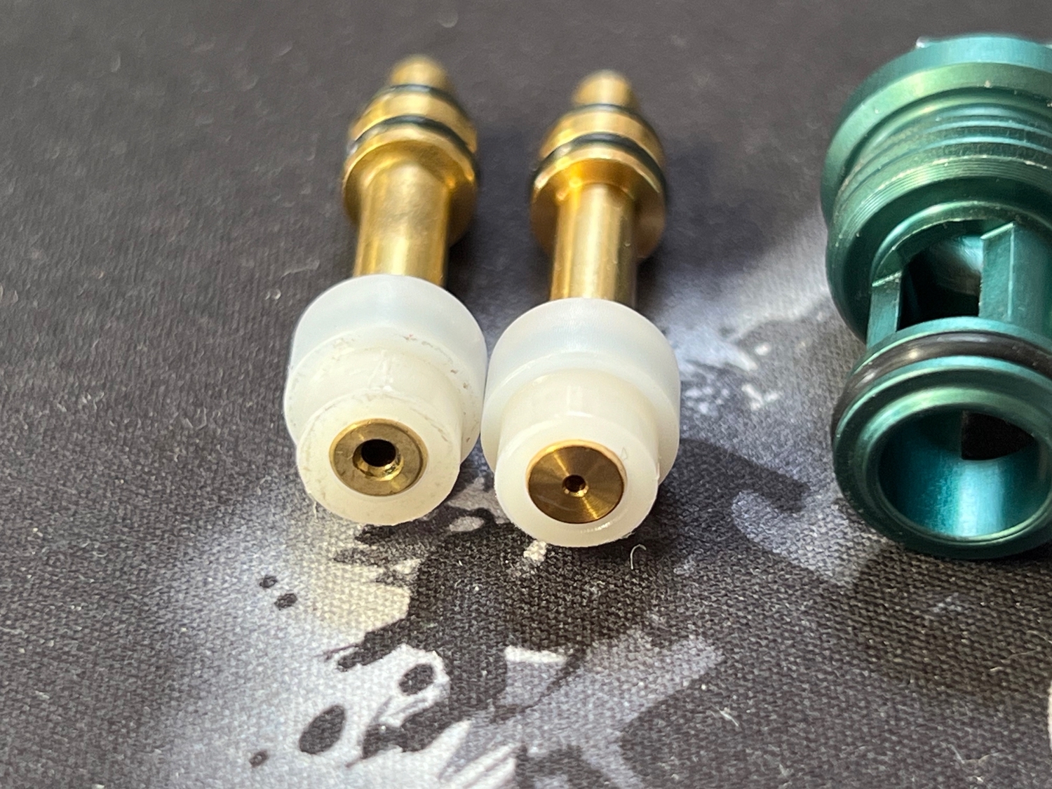

              Click image for larger version  Name:	IMG_2373.jpg Views:	0 Size:	1.73 MB ID:	612246

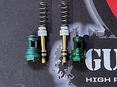

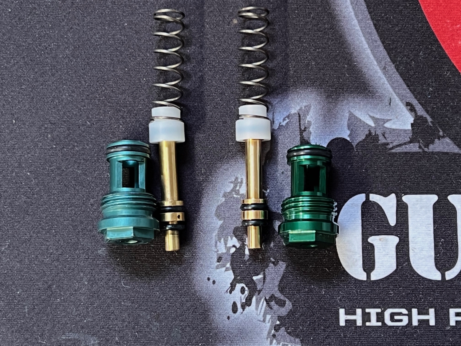

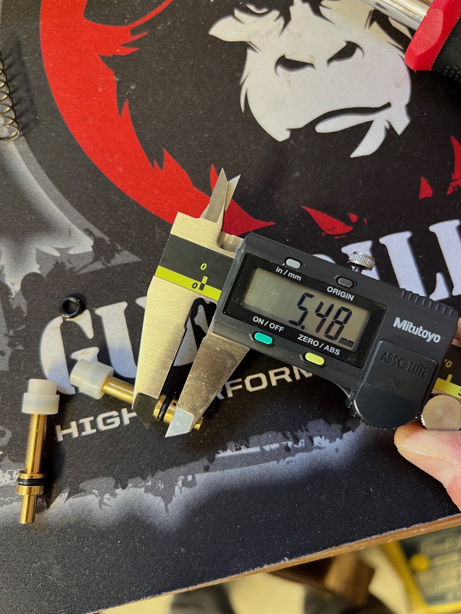

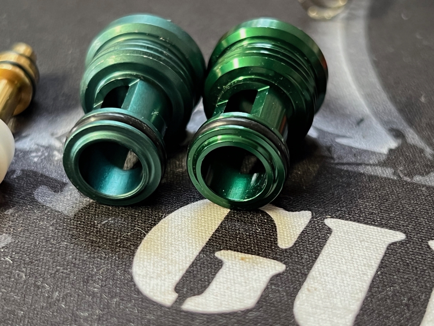

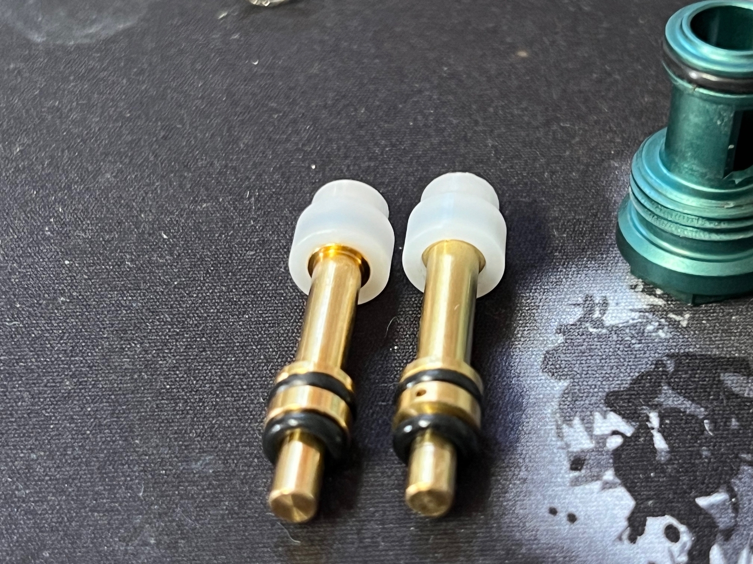

              Notes on my NX1 Experience:
              Nova sent 2 replacement valves, one for this marker and one for a miss-machined valve I purchased earlier this year. The machining, finishing, and anodizing quality seems to have improved. They were almost identical in size, with a slightly smaller hole on the top of the stem and a reduced center part, likely to increase cup face pressure.
              I bought a Harbor Freight tool to service the valve, as the original design required a specific tool brand, which is a significant oversight. I disassembled the marker, cleaned all grease (including pneumatics), inspected all O-rings, and replaced a few. I regreased with Dow 33 light variant. After reassembly, there were no leaks, and the new valve fixed the barrel leak.
              The stock springs aren't ideal. The stock valve spring works, but the hammer spring was not an ideal spring rate. The lowest achievable pressure was 250psi with the IVG flush and my custom hammer spring.
              The 3-way... 5-way valve is interesting. I like the forced cycle completion, but the trigger pull is limited. Longer trigger pulls require increased timing, which affect my shot rhythm. The swing frame feels good, but the shooting experience is unusual, as I kept using it as a single-finger trigger. The banjo metal is low quality and not hard enough, it dented easily from normal removal.
              Overall, for the price, the marker is decent, but it had issues out of the box, including leaks and erratic velocity. Even after the valve replacement, velocity was still inconsistent. After a full rebuild, I achieved +/-2fps consistency over many shots, which is my typical tuning standard. The HPR has a significant 20psi pressure drop per shot, indicating insufficient flow. In comparison, a 2-liter and Palmer regulators only drop 2-5psi. I did not outshoot the flow on the nova regulator, but I am curious how it will perform with heat, dirty field air, and real dirt. The 5way makes the marker feel snappy, and I was able to get it very consistent.
              I was relatively disappointed in my initial nova support, but TJ did come through and made everything right. It's good to see they have sorted out some of the poor machining they were getting back from asia, I will reiterate, quality defiantly increased. If you buy one consider the cost of sending it to one of the members like docfire to get it tuned and built properly.

              • gtsjames
                gtsjames commented
                Just wanted to say thank you so much for this post. I picked up the exact same Sentinal at Fulda a couple weeks; it's about to Arc for a custom anno job, then straight to Docfire to be put back together and tuned!
