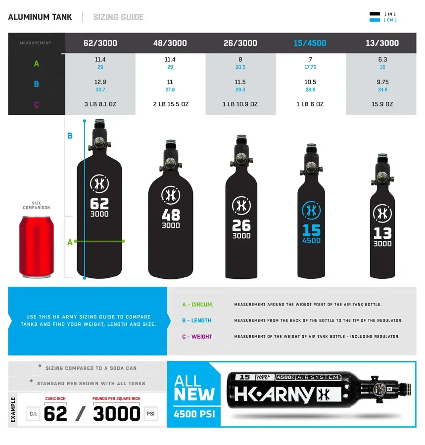

            Yes, but it looks like this one is all aluminum, not just because they imply it but it also has that telltale square bottom of all aluminum tanks.
            Since it's a smaller volume, I wonder if they just kept the diameter small and increased the wall thickness by a small amount. But I'm also interested in what certification process they went through.

              7 ounces heavier than a 13/3k (+50%) - so it's quite obviously a heavier wall.

                  They have the circumference listed, and with some quick math it is 2.2” in diameter.
                      I question that listed figure. Maybe they just rounded up. I'm tempted to buy one just to get some calipers on it. I have use for it if its under 2in but if it's even a mm over it's kinda dead weight.
                          Maybe, but they've got the dimensions for the 13/3k right next to that and those are right at 2"
                            That is really weird though. They listed the circumference rather than the diameter and yeah your math checks out, I got 2.23 inches. So no 2 inch rule I guess.
