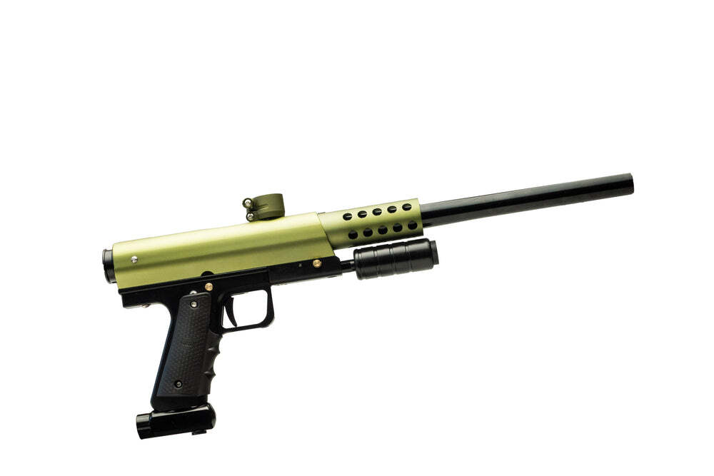

    Nova N45 now available
    https://novapb.com/products/n4-5-odin-pump-black
    Goofy fun Nova stuff, closed bolt spool semi/pump hybrid with on the fly changing and autotrigger
    I ordered a green one, $400 is a pretty good deal pending technical drama. It’s two loaners in one so I’d be losing money if I didn’t get one right?

        Supposed to be a cheaper and better version of their N5 destroyer I guess, based on the N4.1
        It has a safety like push button to switch between semi and pump, and the switch can be removed to lock it into pump

            Woke up to this in my messages
            Minus a rollout it seems to function pretty good

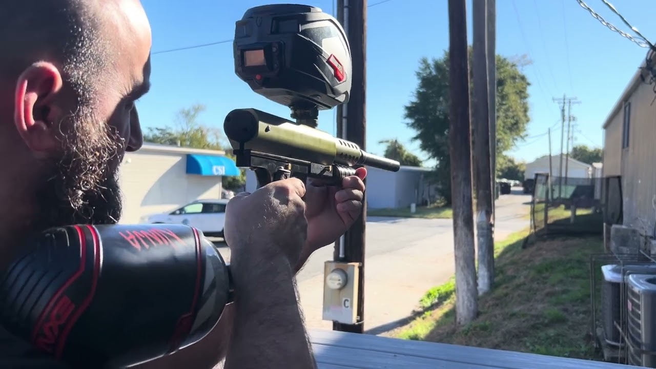

              https://youtube.com/shorts/MSos5iTdj...nv-hMCGAlUoyDf
              Couldn’t get a hopper through without any breaks. Tried a couple different paints, different inserts, different barrels, different hoppers, all combos broke paint.
              Cycled it with balls and no barrel and confirmed it’s clipping the paint. Looking down the breech, the rollback
              is pretty severe. I miss my adjustable ram cap on my old timmy.
              When it doesn’t break a ball, it shoots phenomenally. Dual detents make me want to put a rotor on and rip.
              What I hoped was a quick strip pin is just a slow strip pin, it seems I need to take the frame off to access the bolt kit still.
              Maybe I can make a bumper for the back of the bolt to eliminate rollback. If not, it’s down to modifying or replacing the bolt.
              Came with a bull barrel that takes nova inserts, a nice fat barrel sock, and orings. No manual of course

                Thats pretty bad. I wonder if its a singular issue or if they whole run of them is like that.
