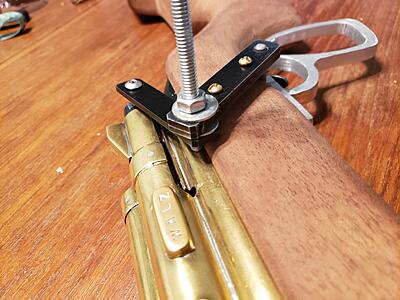

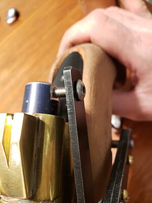

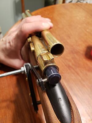

    Alright NSD. Here is what I was thinking, and just holler if a typical rod end method is just going to be better in the long run..this is just my brain child.
    So im making a lever. in my head, I was thinking of utilizing a series of shoulder bolts, and bushings to transfer the energy into the bolt.
    I was thinking a 10-32 shoulder bolt tapped into the rear of the bolt would give me the best energy transfer.
    So basically, I want a normal kp2 bolt, but rather than the off kilter hole for the pump rod they usually have, I want a large flat decked on the 3 o clock plane, and a 10-32 tapped hole for my desired shoulder bolt.
    Id want more of a deck than my practice bolt has if we do this. At least enough for q 1/4 diameter shoulder to hit. It can be longer out of the back of the gun. I can always make the arms different.

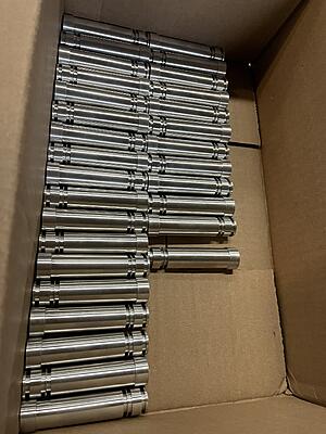

      This first run will be 25-30 pcs. I have 30 blanks setup, lets see how many make it to the end.

            All lathe work should be done friday. I will then complete the milling and send out for anodizing.

            Lathe work finally finished last night. Now onto the mill.
