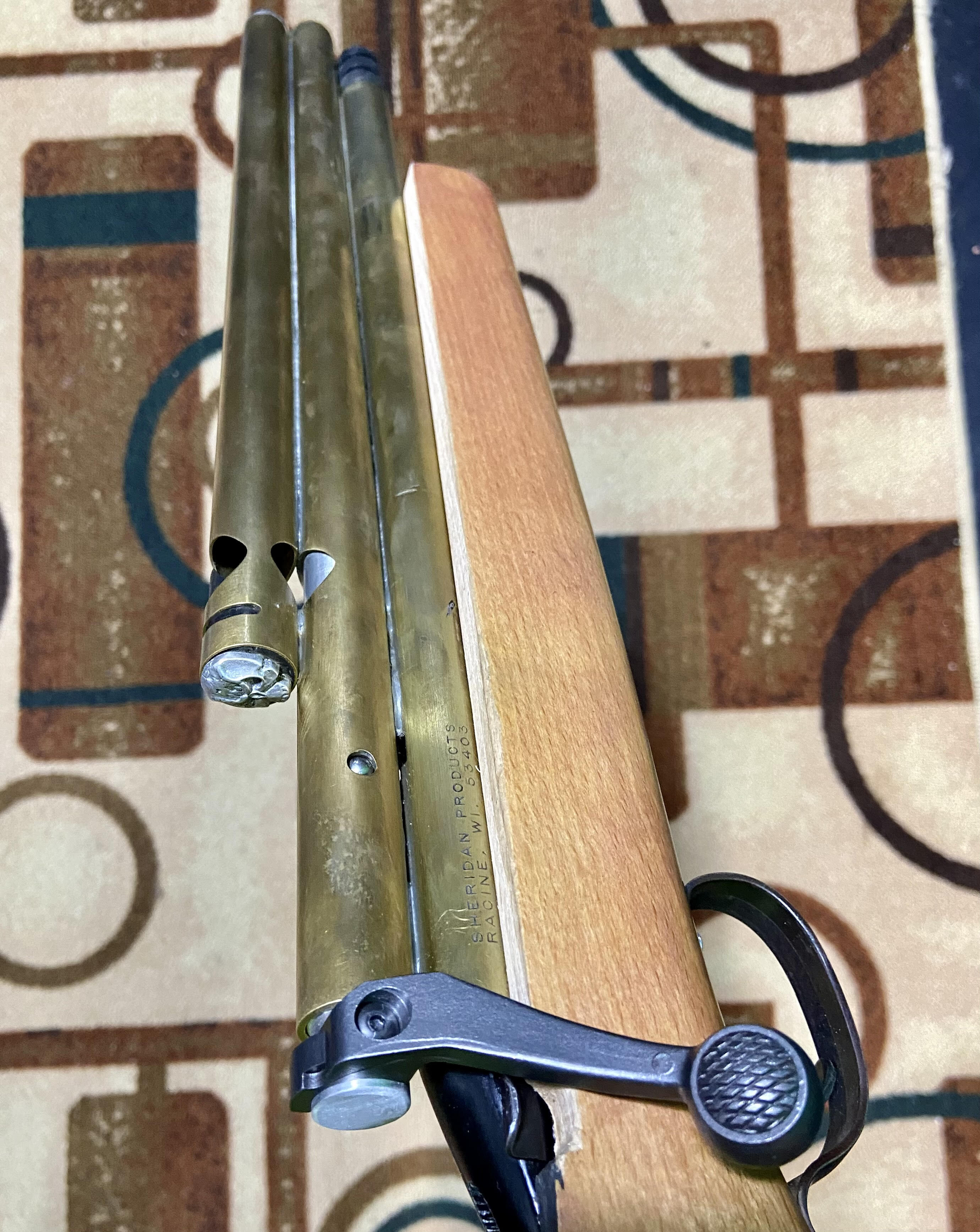

        I was supposed to play paintball today but the knee wasn't at all agreeable when I woke up this morning. I spent some time in the shop instead:
        LtoR: Bolt action PGP bolt (for packers), Bolt/Pump KP2 bolt (for myself), Bolt action KP3 (for cougar), and 2 prototypes of the centerfire PGP bolt.
        I am trying to find a process that can provide fast and accurate results for making these centerfire bolts.

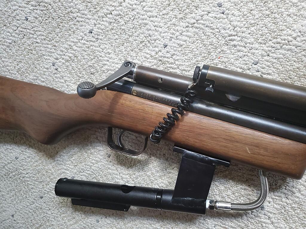

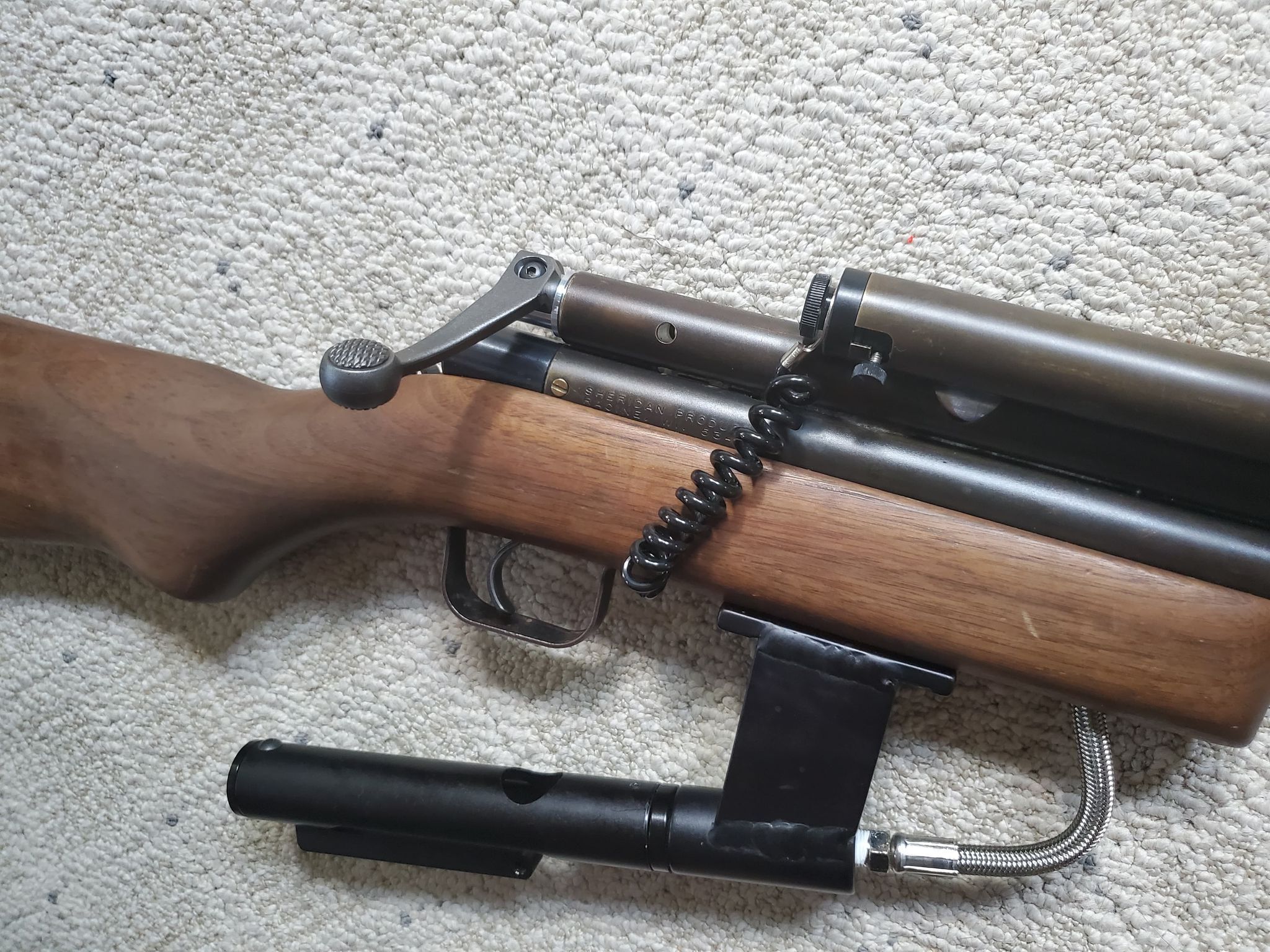

              I've had some time to fondle the gun with the bolt in it. The more I fondle it the more and more I love it. Seems natural. It did take some getting used to as my gun has the quick strip slots and you can easily disengage he bolt from the hammer.. But that's my guns fault. Not the bolt. I chose to run it without the bearings due to this.
              I love how it looks on the gun, Just as I had hoped. The coloring on the handle is just right to look like its been on the old KP for along time. The angle of the handle and all it perfect. :Time to fondle the gun again. Be back in a minute to finish:
              Ok Back
              After finding several things wrong with my gun, yea i didnt rebuild it right. Nothing the bolt caused all prebolt issues
              The gun shots great with the new bolt. I'm loving it.

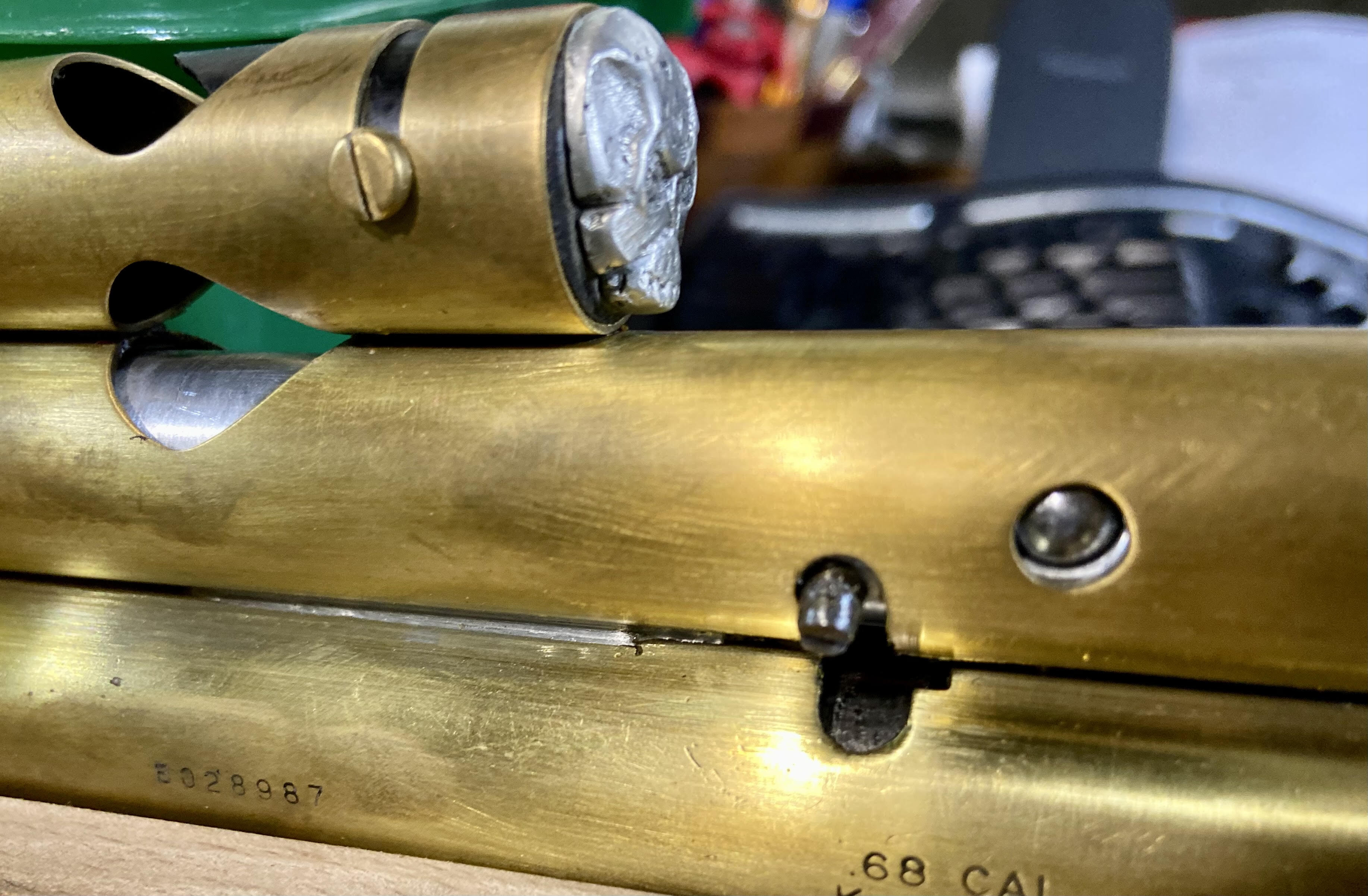

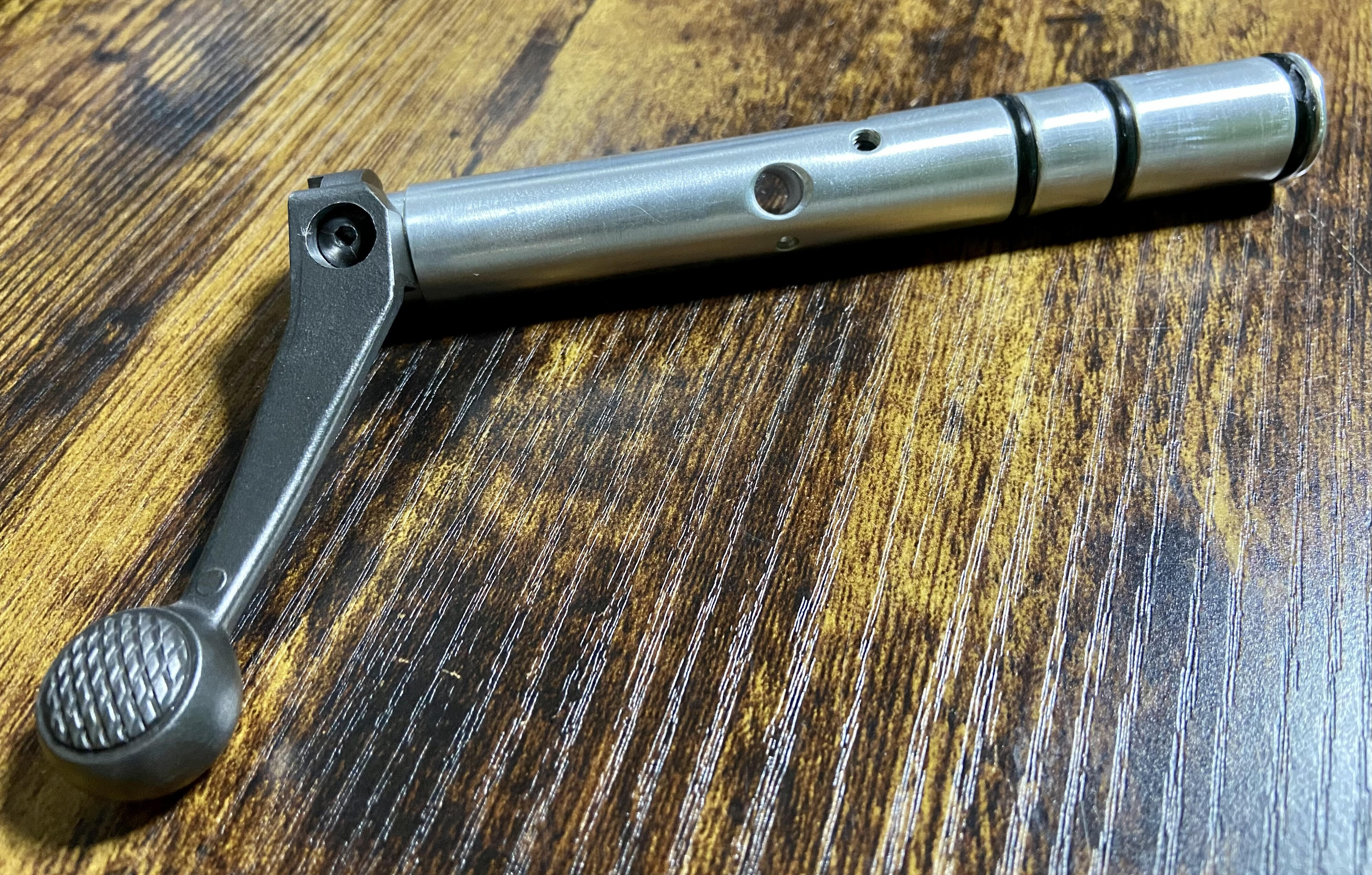

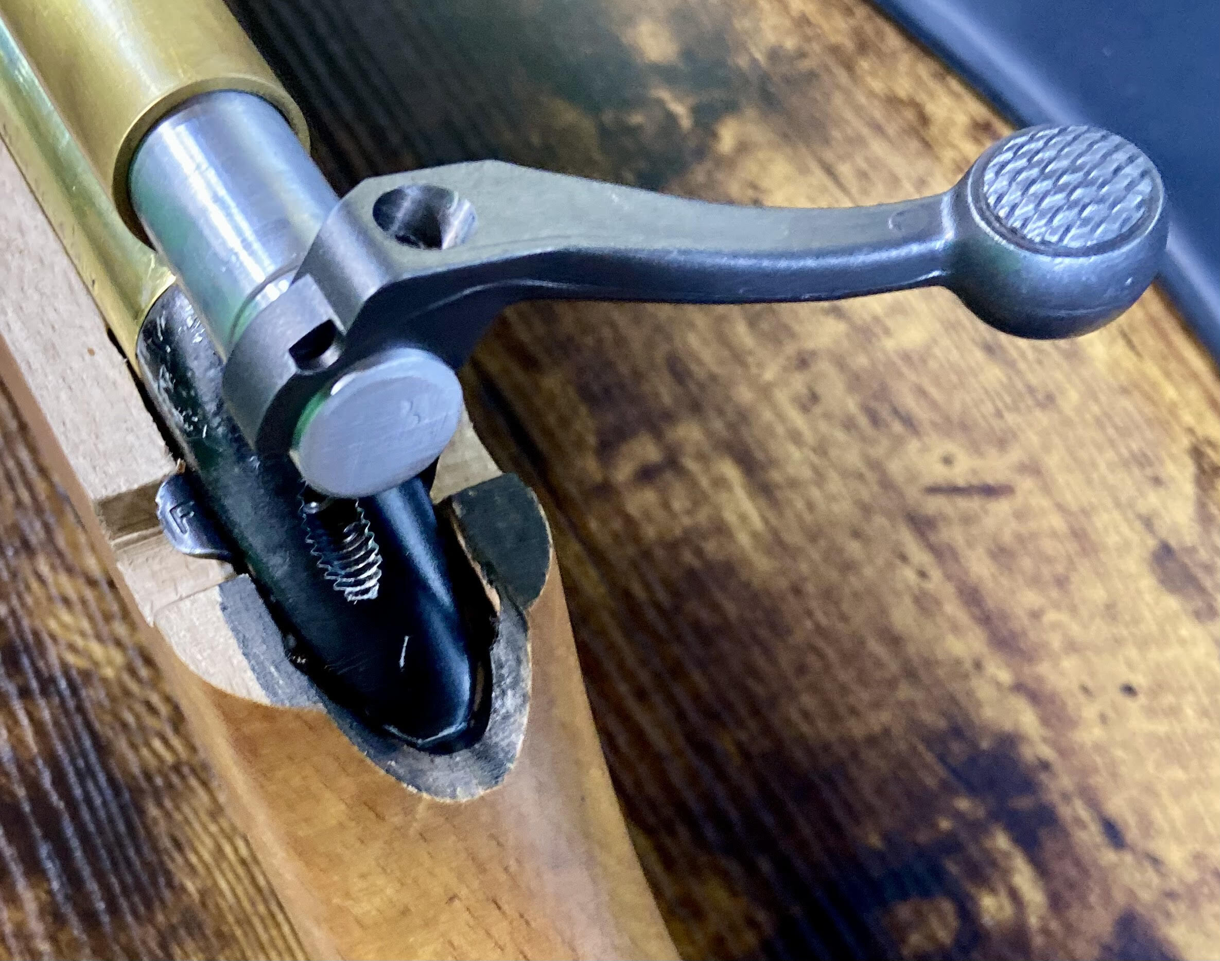

                These bolts are awesome. Converted a stock bolt style (threaded rod into bolt) to this. Amazing difference, and those who have had original KPs...cleaning or changing o-rings is a 45 minute yoga routine with that lug through the lower tube. Looks good on this elongated and top-tubed KP.
                Ignore the stock, it is a work in progress. Also, ignore the fingerprints, didn't want all the glare after polishing it out.
