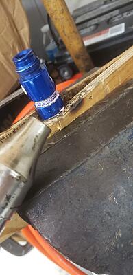

        I'll title this piece "I win." Alternative title, "Holy red Loctite, Batman!" I'll check fitment and function of the reg seats after this guy cools down.

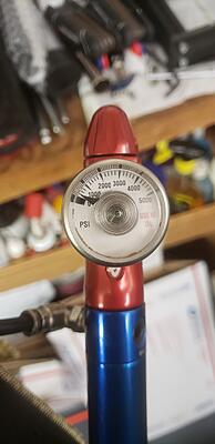

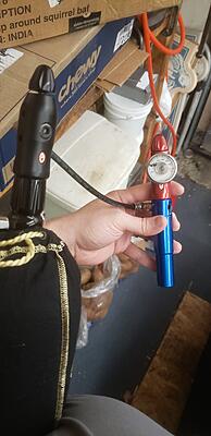

                Also wrapped up the rebuild on this old Stabilizer and it's regulating nicely. Vented a few times and it recharged right back to 200 psi. I'll let it sit for a few hours to verify that it's not creeping. The old Dye Throttle puts out about 650 psi IIRC.
                • Yo soy el Warg
                  • Jul 2021
                  • 192
                  Just following up here. In classic Palmer's fashion, the Stabilizer held right at 200 psi for 24 hours.
