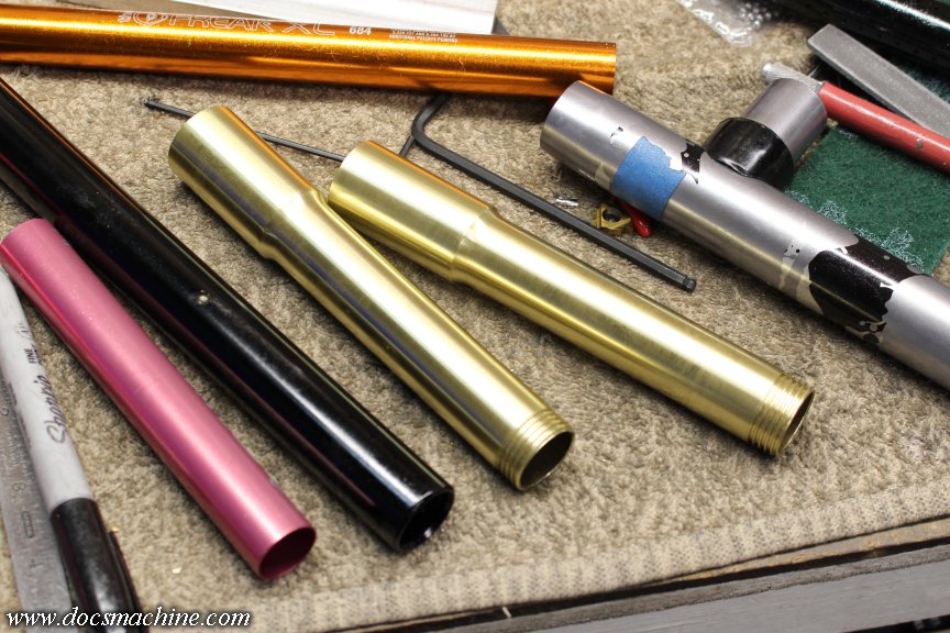

            For those asking about a 2-piece Phantom barrel- yes, they're possible! I just finished making a pair of brass ones:
            I have a couple of aluminum examples that still need to be finished, but I can certainly make a short run of them if there's enough interest.
            Again, as above, you'd have to use them with an undercocker kit- and even some of those would need to be modded- or you'll have to make yourself a custom pump. But, if you're willing to do that, I got the barrel for ya!
