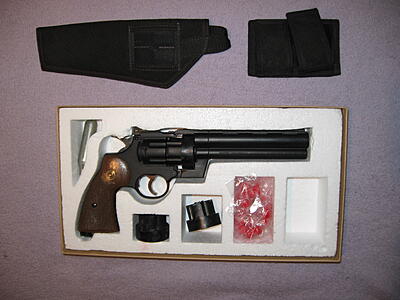

NIB crosman 3357 with all accesories and box Looking for approx value?
  • Sal
    • Jun 2021
    • 13
    Will be for sale, but I have no idea where to even start on a value for it, anyone got any ideas? or would eBay be the best bet on this one?
    $300 shipped seems like a fair bet.

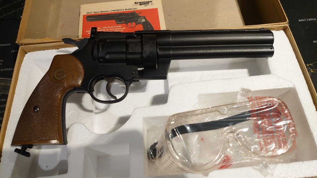

            ...and I would say no more than $300 for a "new in box" 3357, because of it's possible 30+ year age, rubber seals might be dried out, and the cylinder detent may have gone gooey with age, if it has the rubber ring center version of the cylinder. But having a good shape box and manual would be a value plus for a collector. Prices have been really crazy on 3357s, one month a 3357 only goes to $200, and the next month someone gets $400 for a virtually identical package. I will say that extra cylinders will make the price go up, as that is a coveted item.
            And the shop googles in the first post never came with a new 3357, there was the marker, the box, the manual and 50 red paintballs in the package that originally sold for $89, I think.

              Sounds good, I haven't tried to gas it up, and it is the rubber cylinder seal at the front, I haven't done more than just take it out of the box for the pictures, as I have no intent to shoot it, so far its the nicest one I've ever seen as far as the actual condition of the box, manual and gun, it doesn't even look like it had been upacked before I got it.
