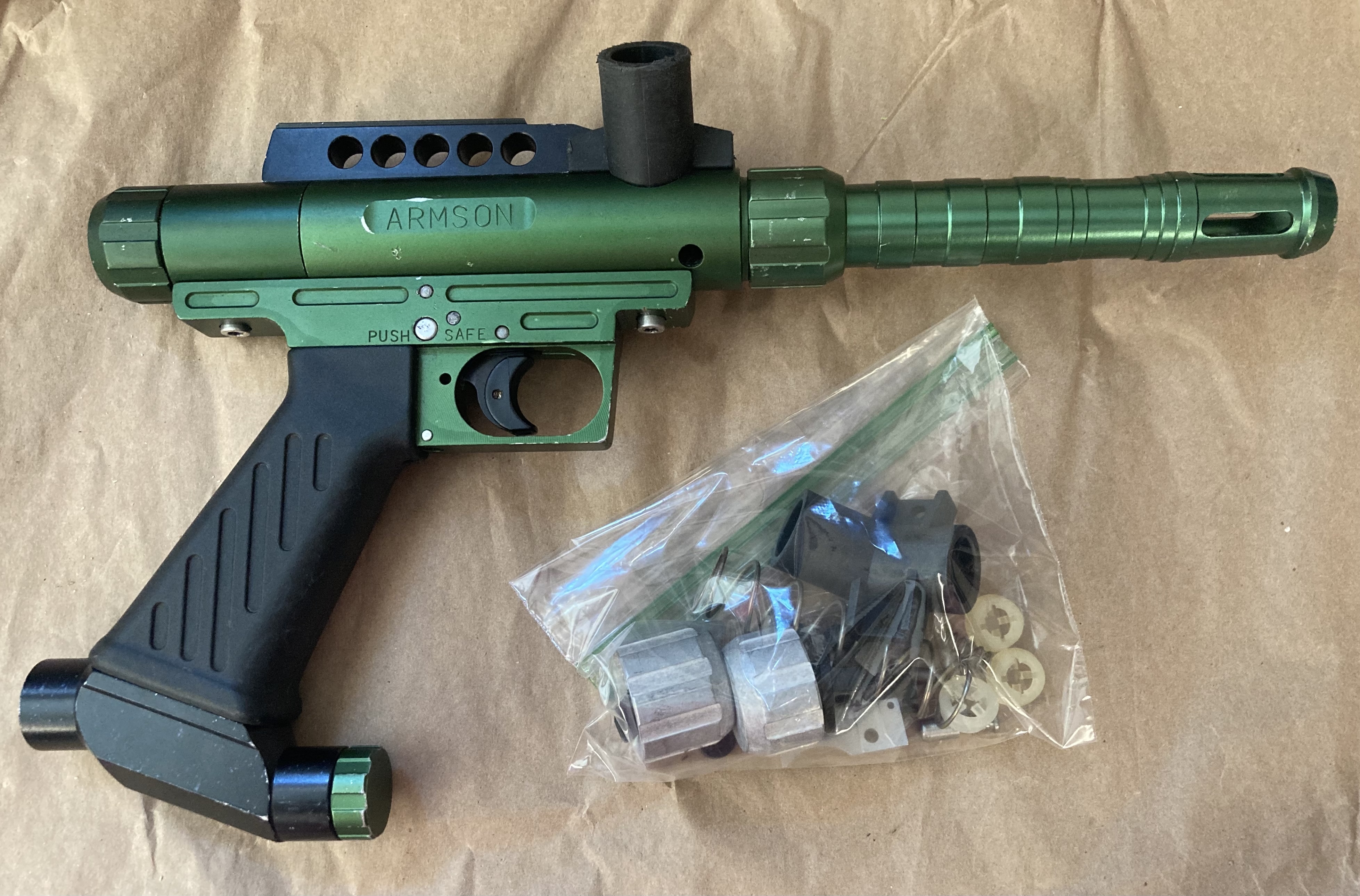

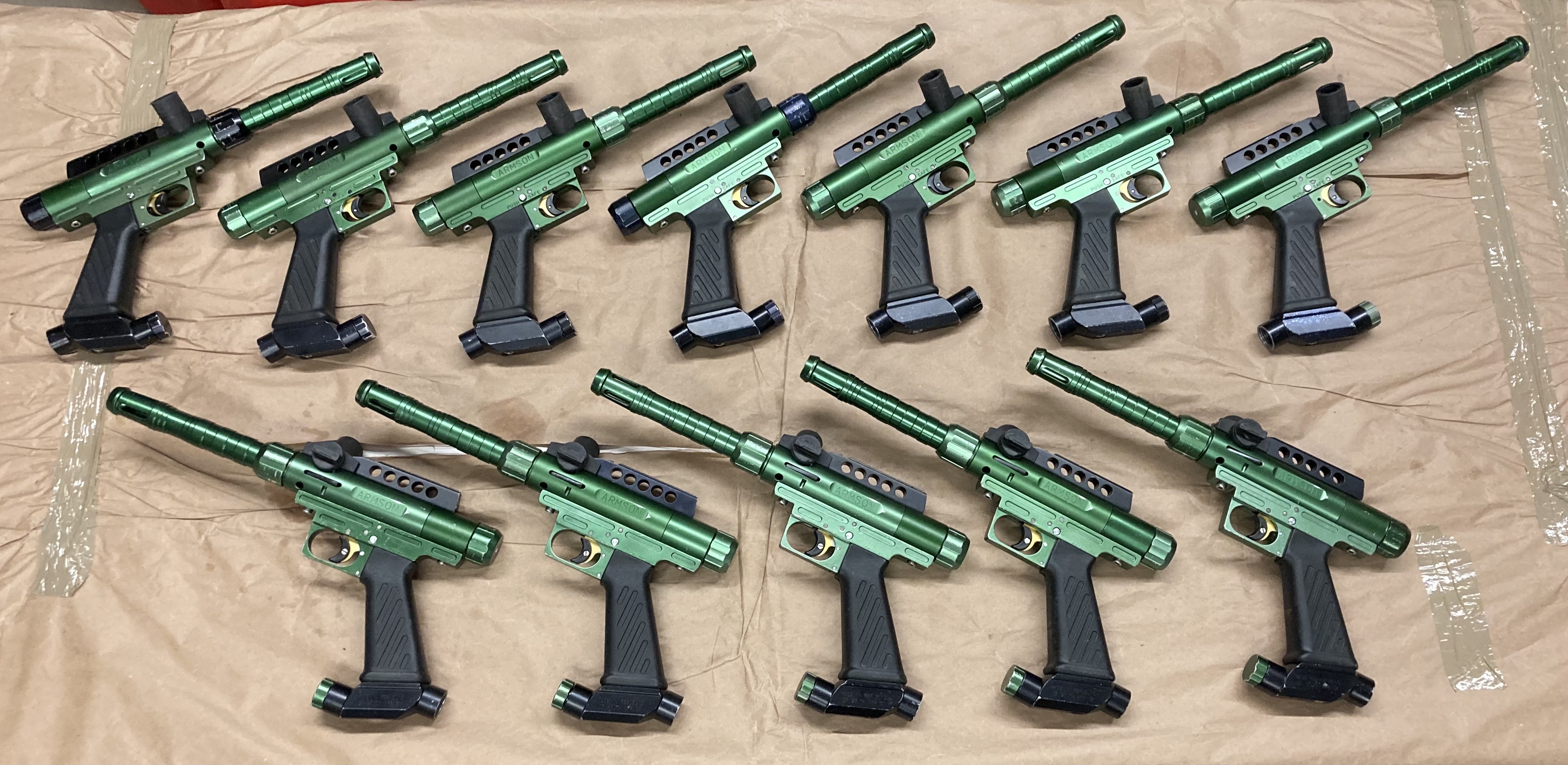

    I acquired a decent size lot of Armson guns a couple months ago. The lot consisted of Armson Paintball Rifles and Armson Semi paintball guns. I have spent most of the time since cleaning/repairing, finding parts and learning a lot about these guns. You might see them on eBay, but obviously contact me here if you have any interest in one. I’ll do my best to give you the pick of the litter based on what I have.

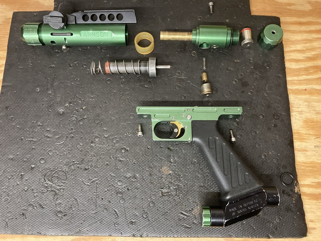

    Every gun has been disassembled, some seals replaced and most of the dirt and grime cleaned out. I did not completely disassemble the grip frames. Each gun has also been aired up and tested for leaks and basic functionality. They will be tested one more time prior to shipping.

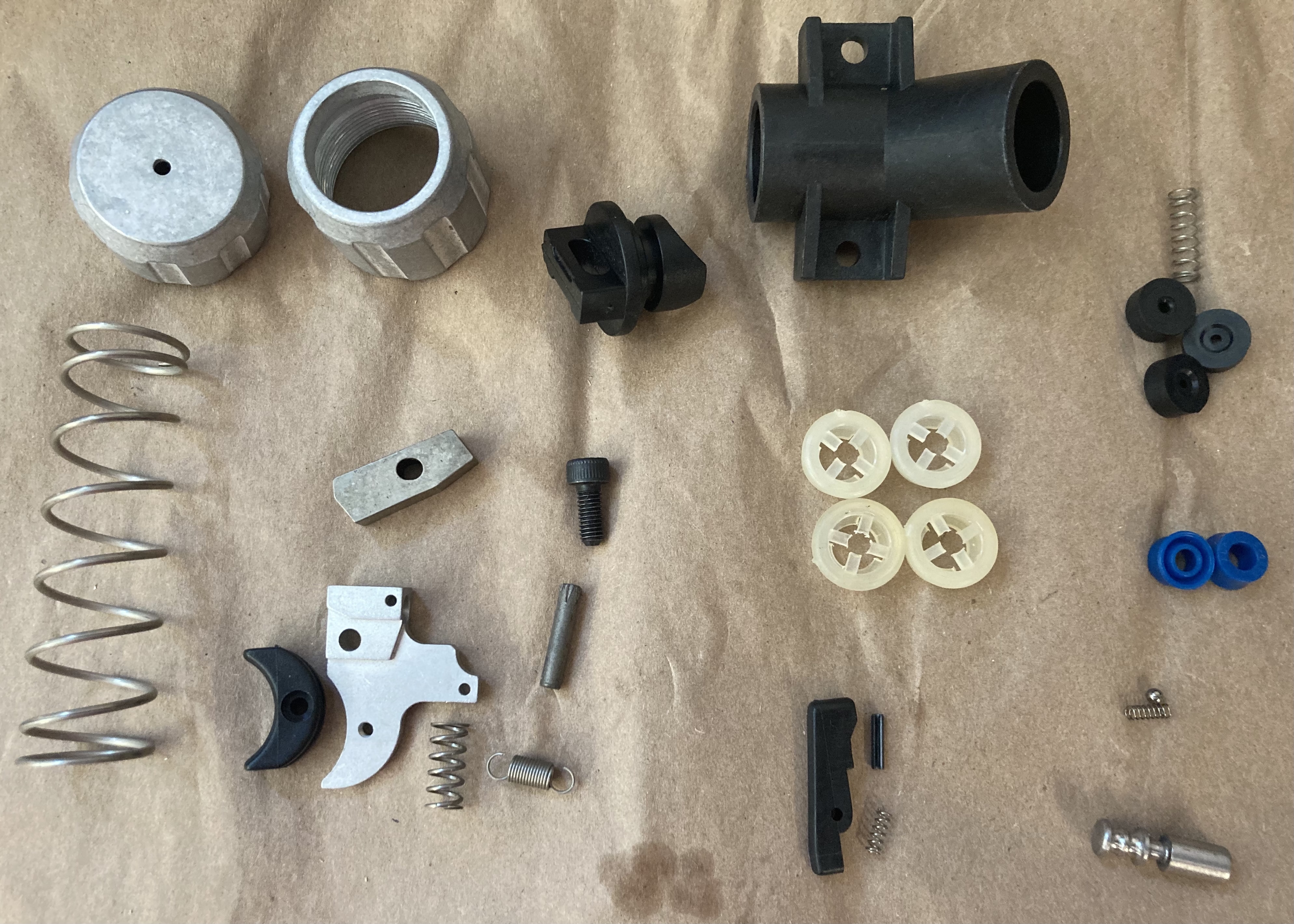

    Each gun will come with a parts kit. All spare parts are brand new. Some of them are hard to find parts, others not so much. The parts kit is subject to change, in your favor, as I continue to track down additional spare parts for these guns.
    SEMI
    The picture shows the guns I currently have as of this posting. I have no problem moving parts around based on what you want and can build and show you the exact gun you want prior to shipping, although I have kinda already done that and the 5 on the bottom are the nicer ones.
    Most have an older powertube seal that probably won’t last too long. I will change it out if it’s leaking, but leave it in if it’s still working. This is a “hard to find” part. The parts kit will include brand new powertube seals.
    I sent a barrel to BMC for freak boring to test. He was able to do it no problem. Only issue was that the Semi bolt will get stuck in a small insert. It was anything below .684 with mine. I did a little sanding of the last 1/4” of the bolt tip and it was fixed and worked fine.
    Armson Semi + parts kit. $500 shipped

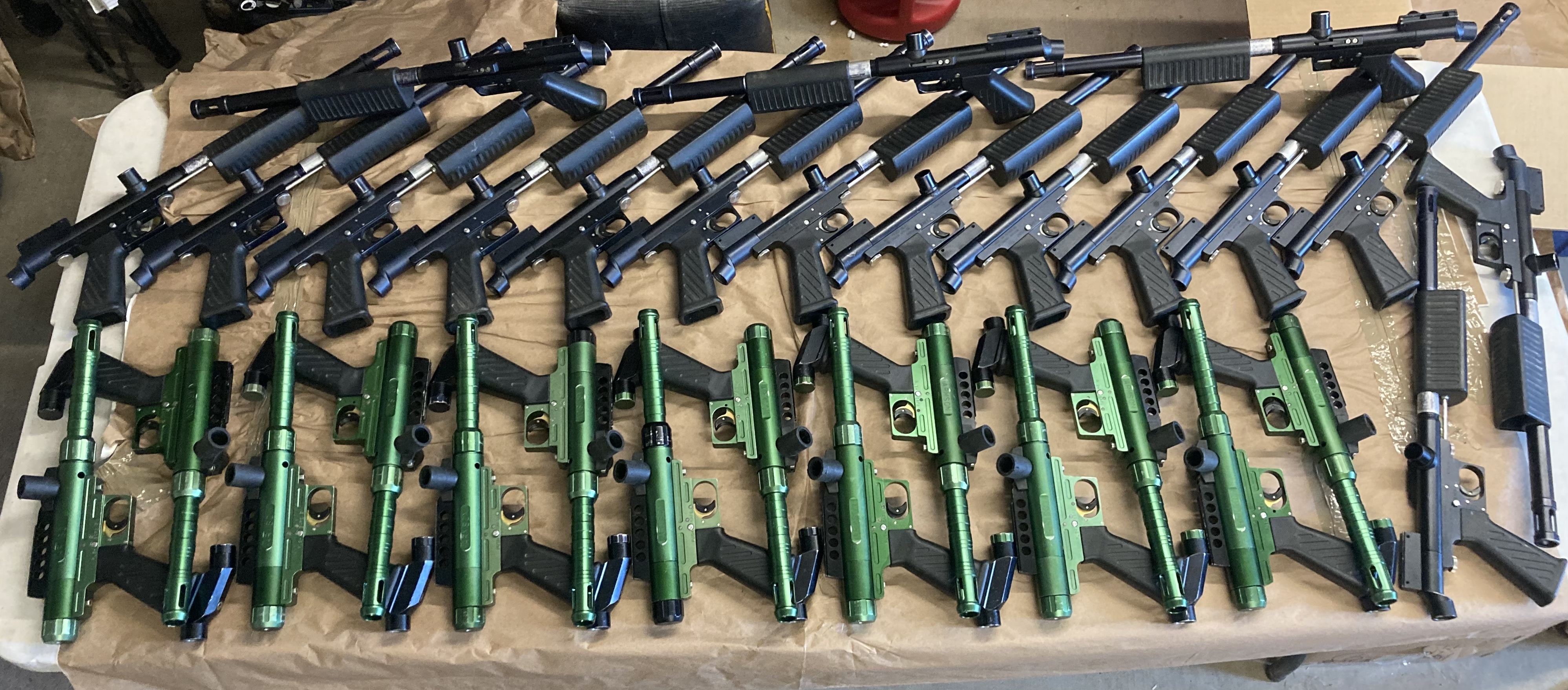

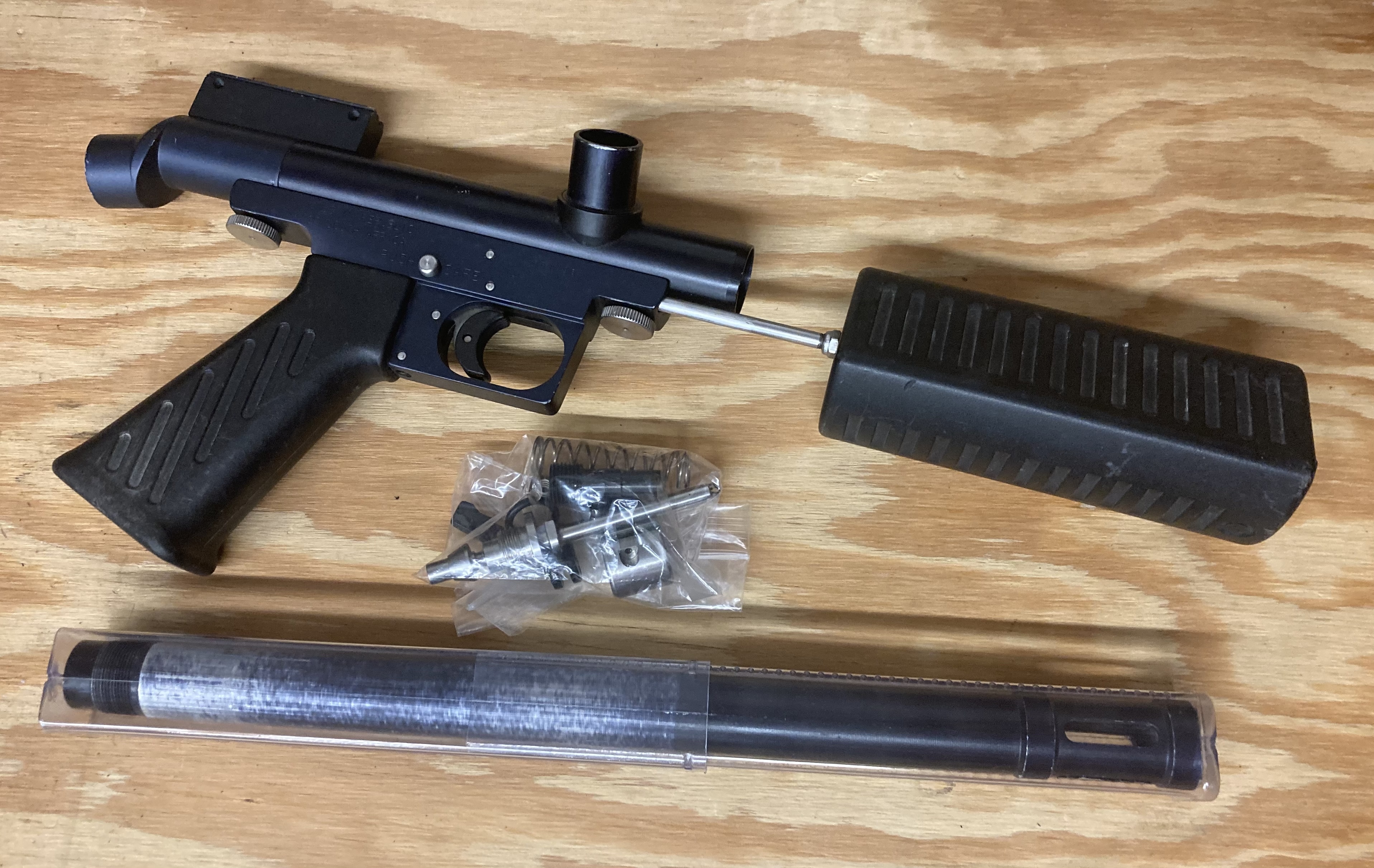

    RIFLE
    Some of these are not quite getting up to velocity. So a little tuning and tinkering might be necessary. Probably just a combination of old springs and a ‘90s barrel with a huge bore. A new factory mainspring is included in the parts kit.
    All of these guns have a unique powertube setup currently installed. This is how they showed up. They work as is, but I was able to get the “newest” powertubes and hammers and am including those in the parts kit. If you change them out, the sear and cup seal will need to be transferred from the old setup.
    I also sent one of these barrels to BMC for freak boring to test. Again, he was able to do it no problem. And I had no issues shooting the gun with a freak insert.
    Armson Paintball Rifle + parts kit. $220 shipped

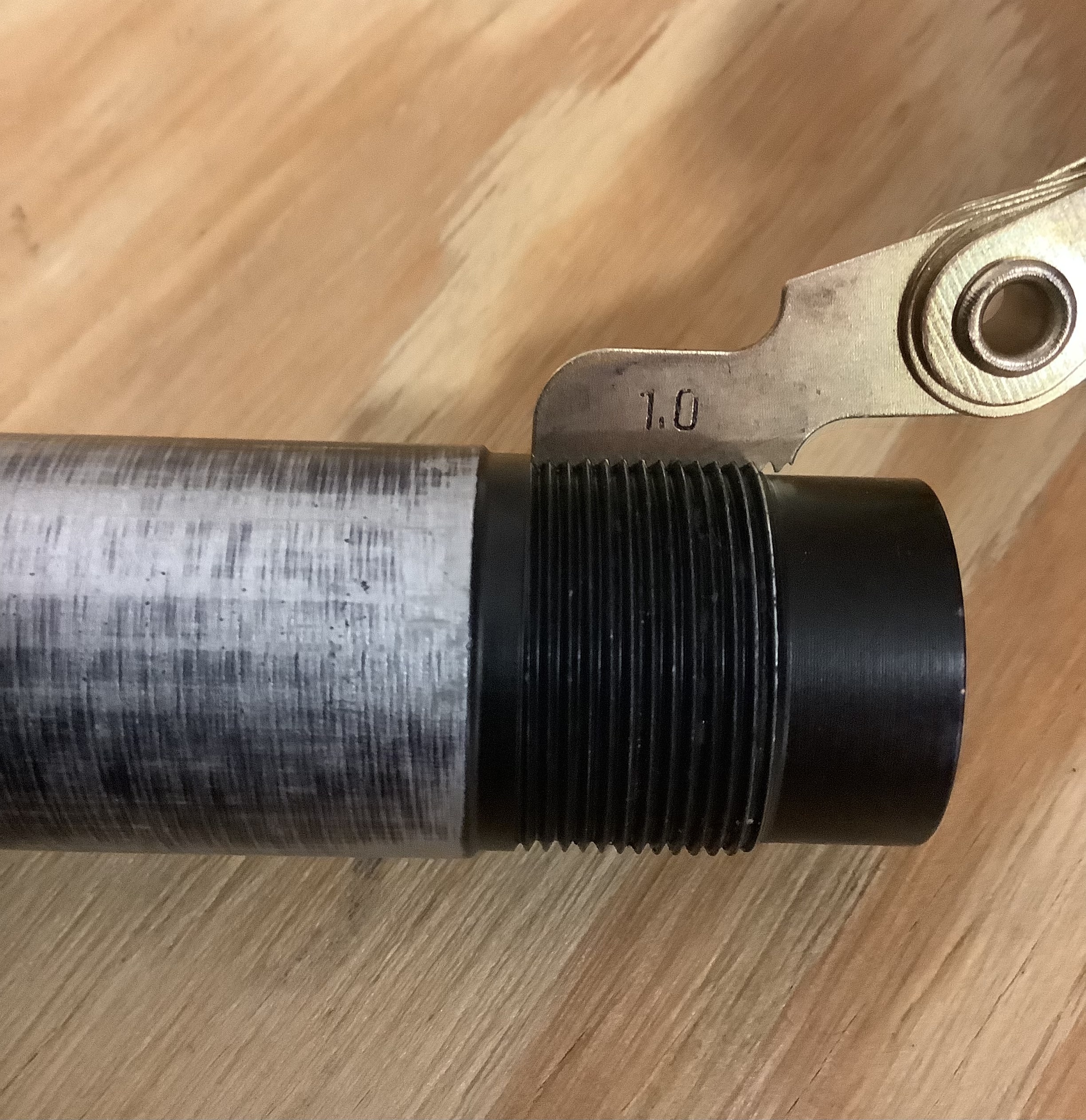

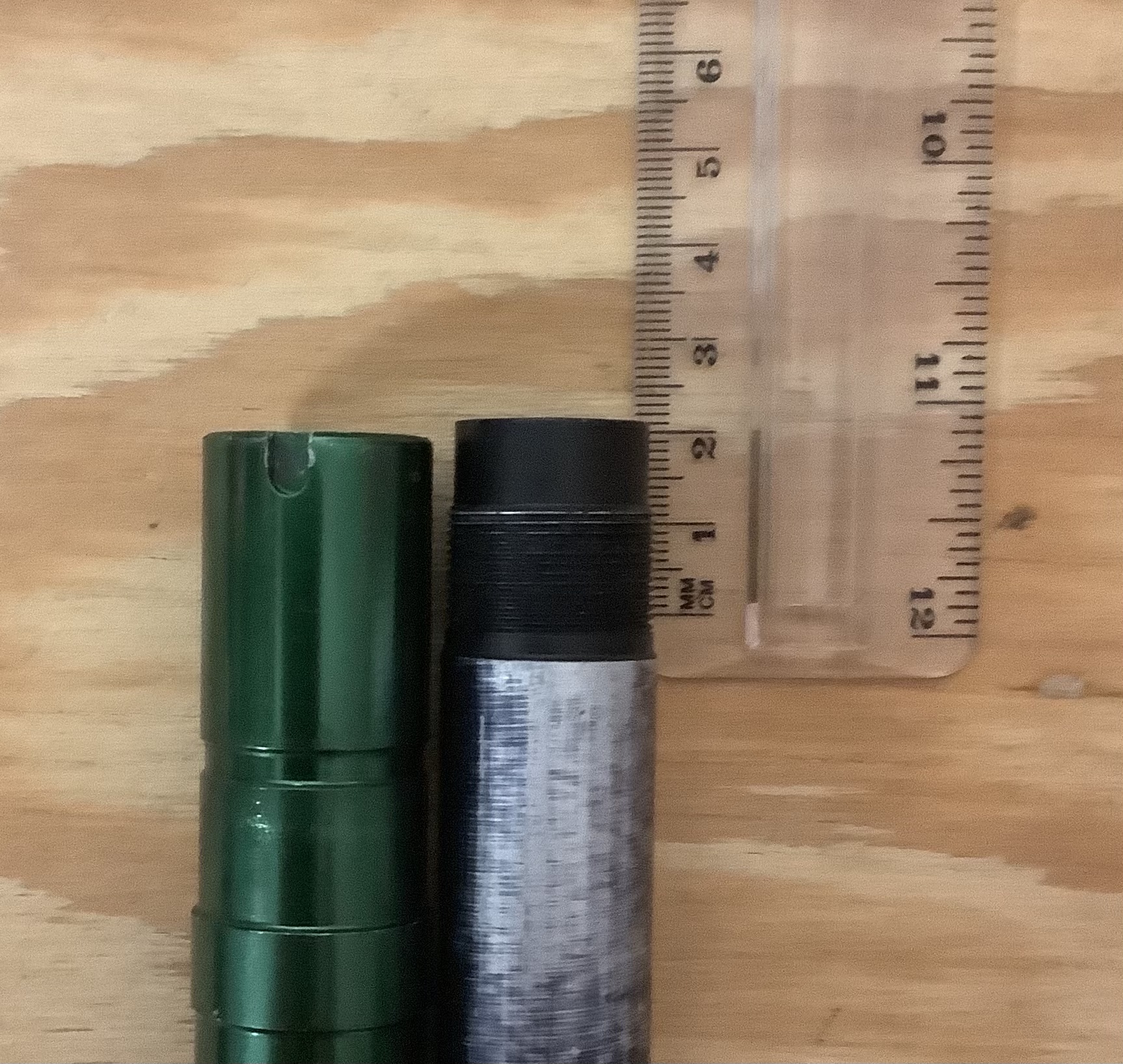

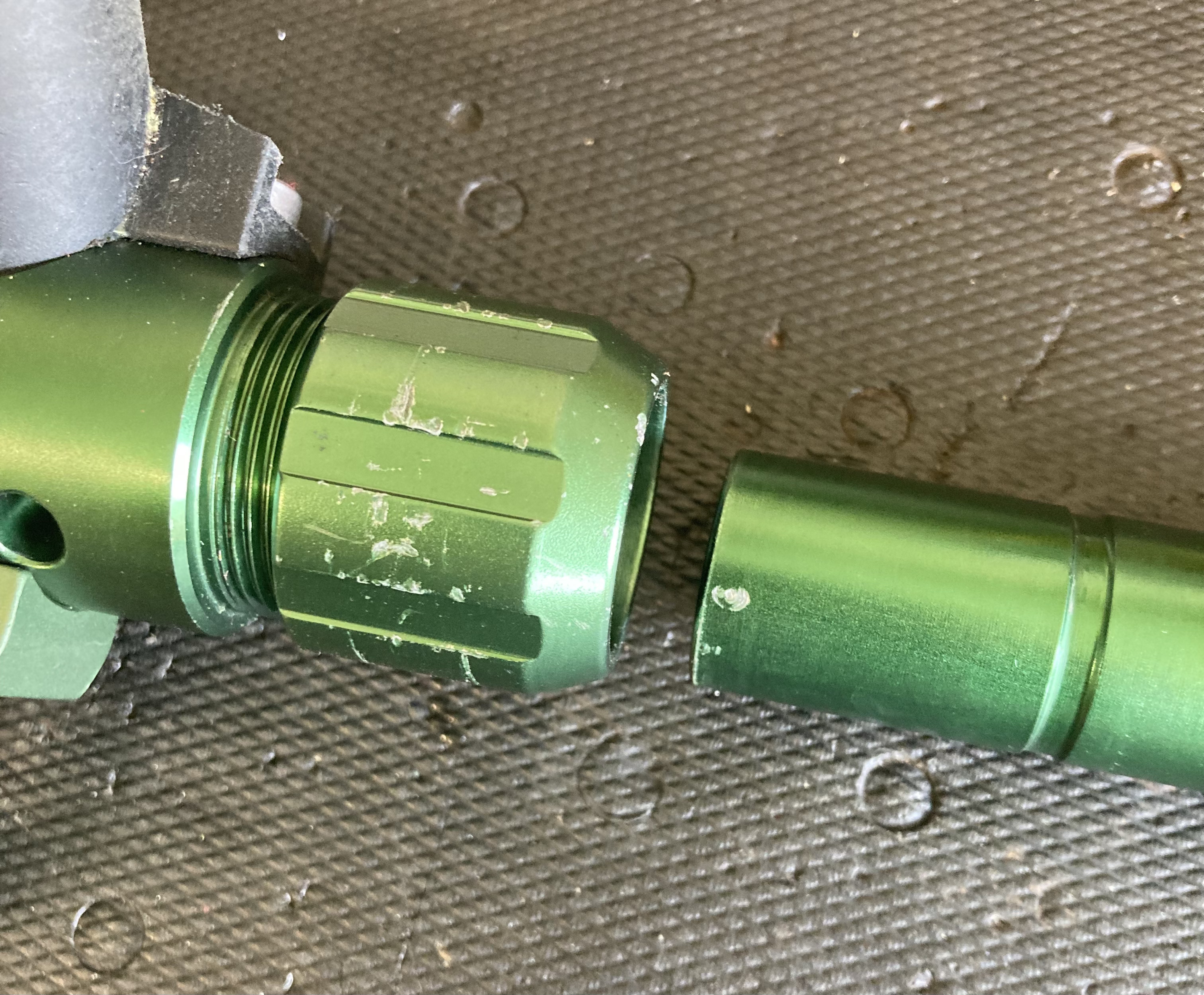

      Armson threads or lack there of. SEMI isn’t threaded, just secured by a collar that tightens down around it and the front power feed screw prevents it from spinning and fits into that groove.
      The Rifle threads are metric since these are from South Africa. See pics.

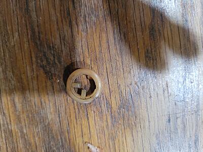

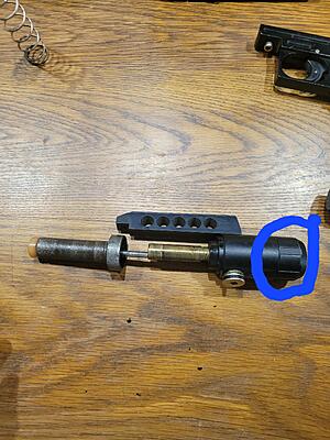

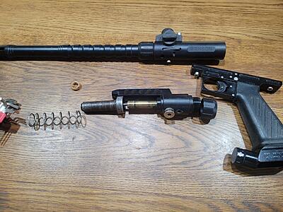

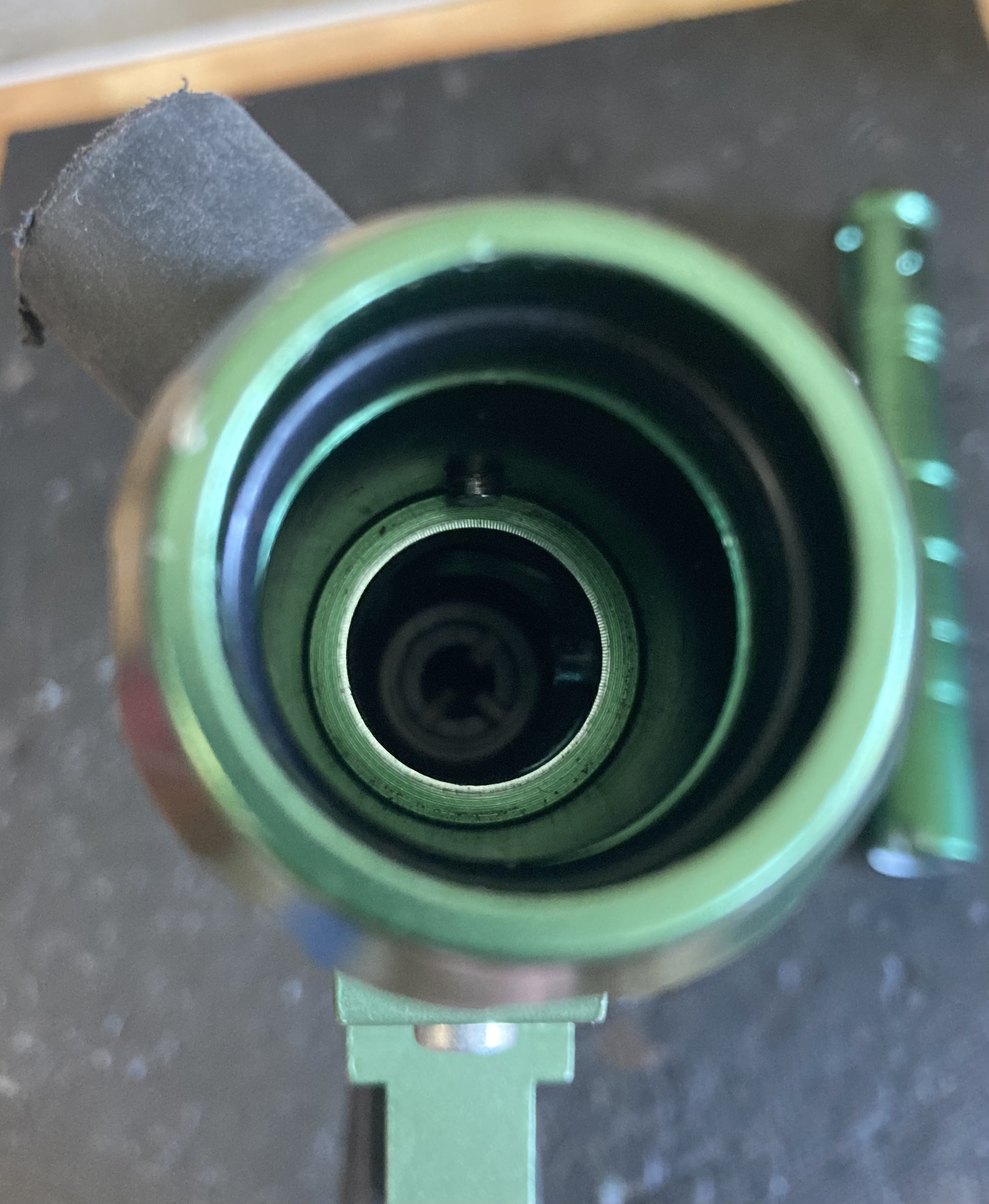

            Hi all. I have recently started restoring an Armson Paintball Marker. When I attached the CO2 tank to the gun ane opened the valve there was quite a lot of air coming out of the back of the gun (picture1). What could cause this? I checked the o ring and it seems fine so I'm wondering what else could be the issue also what is the name of the part in the second picture
            This gallery has 3 photos.
            • wthomas333
              wthomas333 commented
              The item in the 2nd picture is the bolt tip. Yours has obviously seen better days. I have plenty and can send you a few new ones. Just need an address.
              As far as air leaking out the back, there are only 2 orings back there. One large one that simply holds the rear cap in place and doesn’t seal anything and then the one around your velocity adjuster. I would assume that oring is bad. I also have some of these I could send with the bolt tips or you can just buy some 2mm x13mm ID orings which will work for both the velocity adjuster and the air transfer
              assembly.
              If you haven’t already, go here for a full breakdown.
              https://www.mcarterbrown.com/forum/p...-semi-teardown
