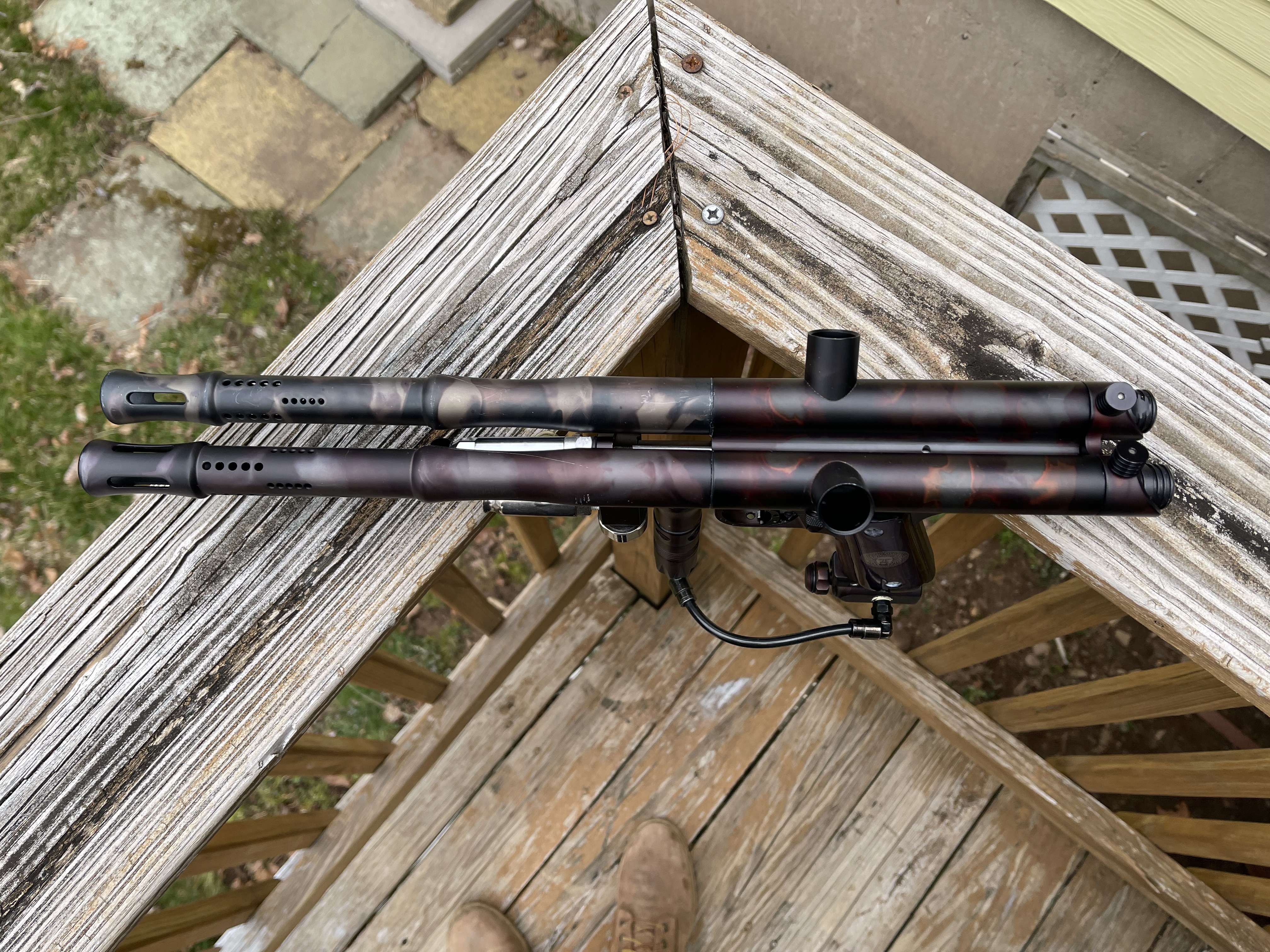

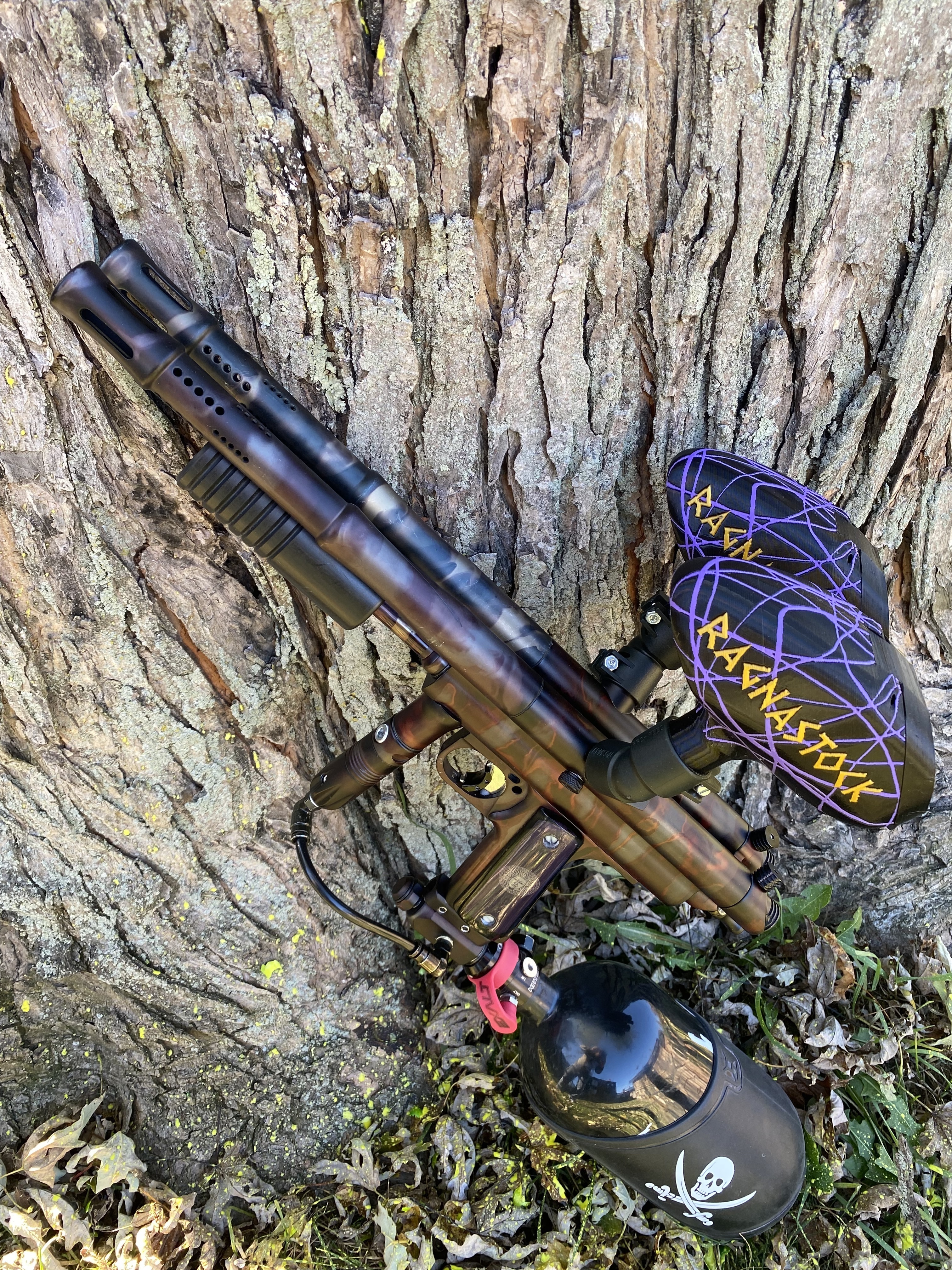

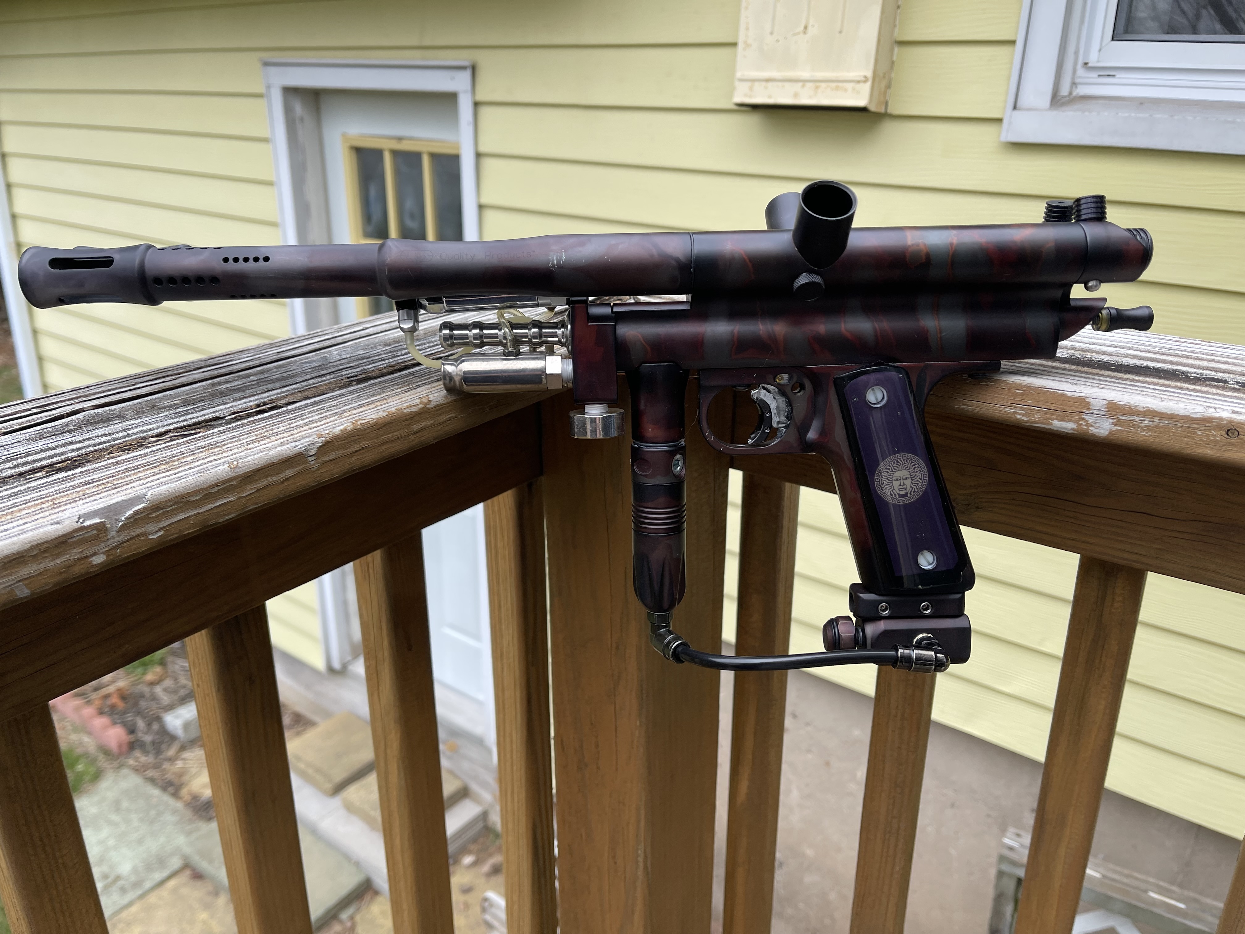

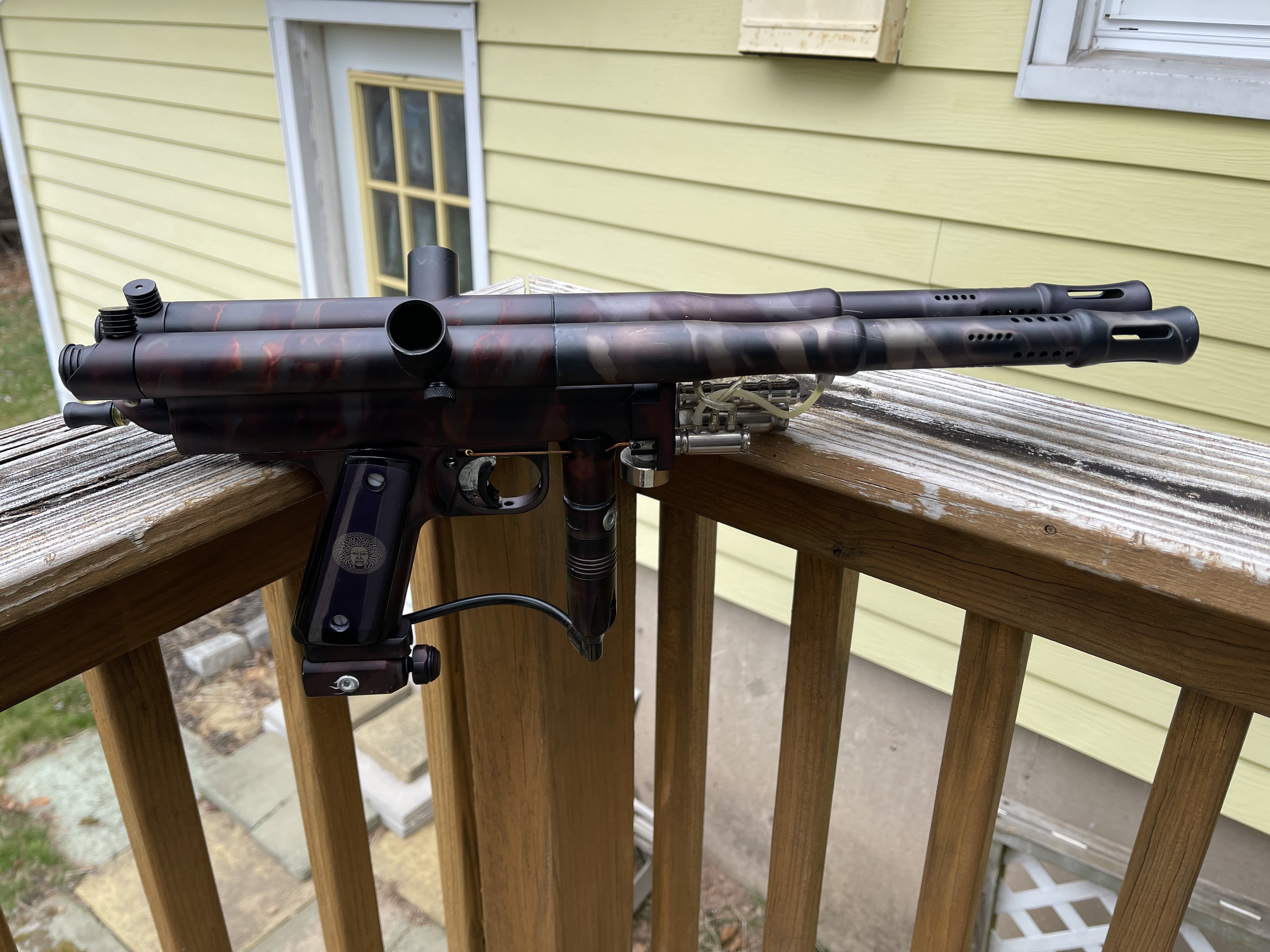

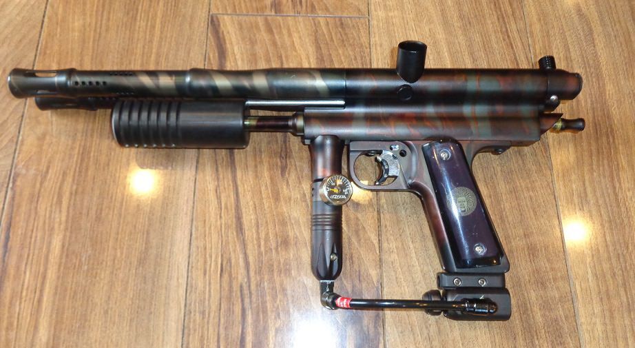

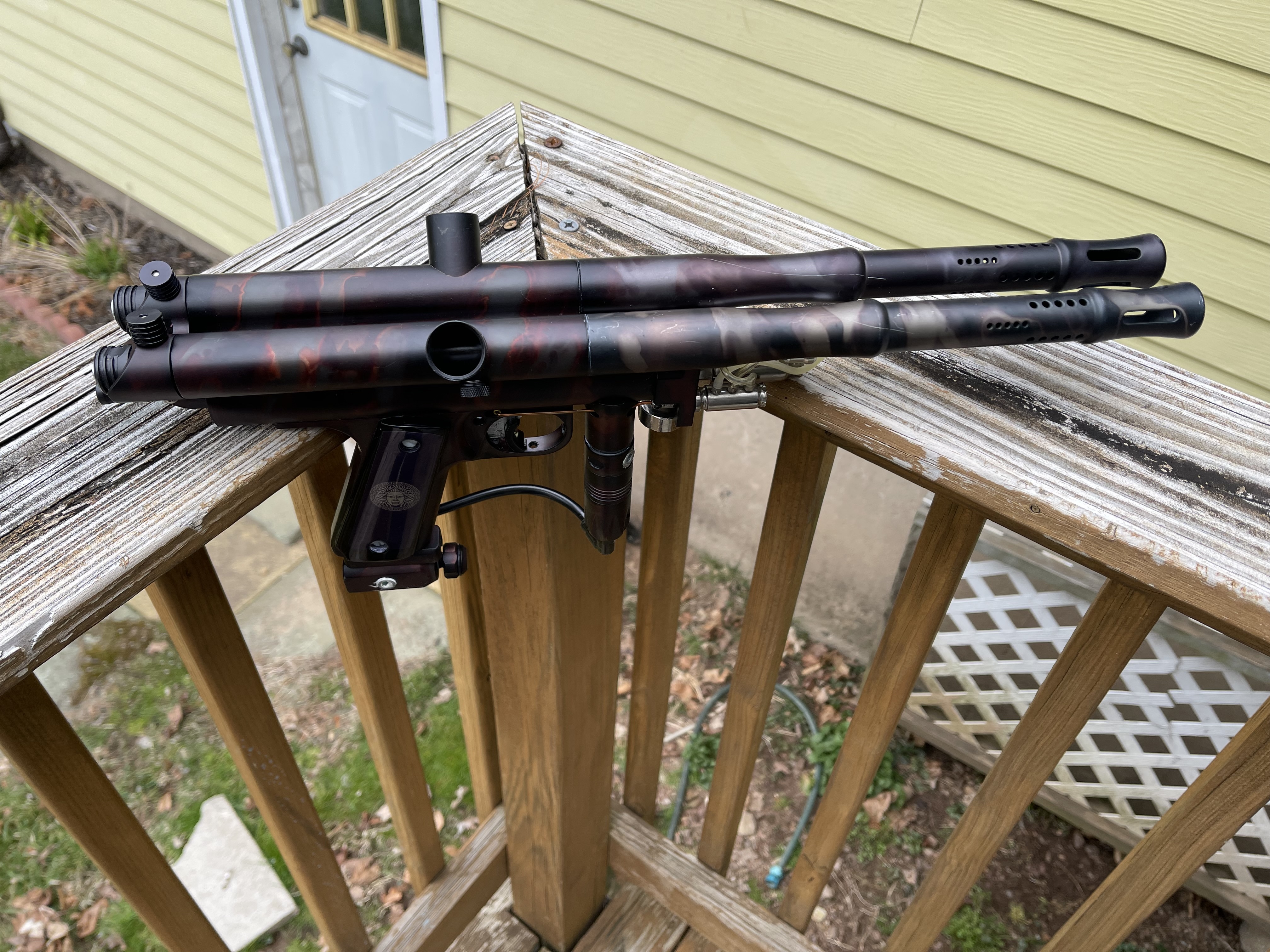

    KPCS Ma-Deuce-A II
    Update 11/20/24: This is currently shooting at about 275fps.
    KPCS Ma-Deuce-A II
    Some specs:
    KPCS Ma-Deuce-A II body
    KPCS Ma-Deuce-A II pump kit
    KPCS front block
    Benchmark slider 45 frame
    CP regulator with gauge
    CCM mini rail and on/off
    AKA Lightning bolts
    AKA bolt pins
    KAPP ball detents
    Freak bored ANS Phase II barrels
    Custom made Medusa grip panels
    This above list is taken from an old post... but I don't imagine anything has changed. It is currently set up as a pump and I’ve never had pneumatics on it in my ownership.
    I would like to see $1500 shipped.
    Member's Price: $1350 shipped.
