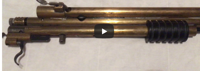

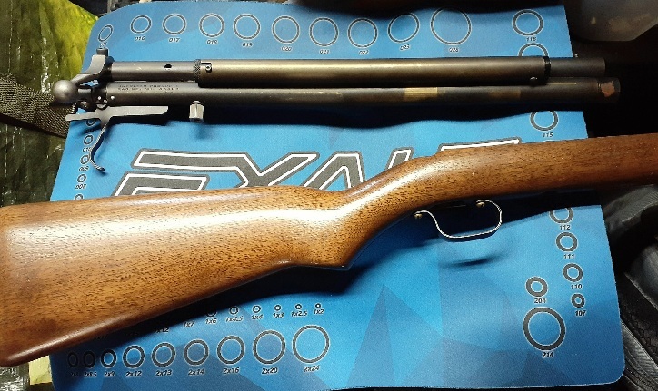

    I have a KP3 with a bolt action bolt mod, but I am missing the Hammer and valve
    I have PGP interbal but not sure it would work with the trigger group
    Looking for KP hammer and valve with pierce pin
    Second
    I always wanted a lever action pirate
    I have two PMI LB and a blue strike trigger group
    I will use one of the LB for this (dont worry I wont cut a KP stock, planning to make one)
    Looking for a lever (big loop or small), and maybe some picture on where is usually mounted the pivot
    I am located in Canada
    Thanks for your help

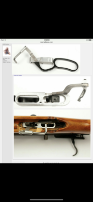

          Click the pic to enlarge and clear it up
          this is not my work, but from a project on old MCB that I saved for a project of my own. I eventually gave up on finding a lever arm. Hopefully it’s a good starting point though
            XEMON commented
            I've been looking for a pic like this for years!
            Thank you so much
            Alexndl commented
            Thanks, was looking for an image like this for a long time and could not find one

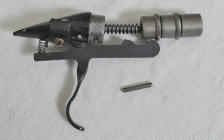

          the valve internals for a KP are the same as all other 12g component sheridan valves. So as long as that PGP is not a cartridge valve it will work in the KP.
          Are we there yet?
            XEMON commented
            Not true. The Sheridan's with wood stock have a longer/bigger hammer than those with pistol grip. Also have longer springs.
            Bolts are also different from version to version.
            Valves are the same.
          • snaparen
            snaparen commented
            I did not say hammer or drive spring, I said valve internals
            XEMON commented
            True, im sorry, didnt read properly.
          Hammer is specific for KP, there is a way to use other component but you probably need to change the trigger plate (Blue streak use a single hook plate thatis shorter than the KP with two hook)
          Also trying to make it as original as I can. At least for the hammer, valve and cupseal could be ise from another sheridan
          • snaparen
            Neophyte of life
            • 57
            If it is a KP-3 and not a KP-2DF, the back block and hammer configuration did change a bit through the production years. The last production of the KP-3 used a different back block and hammer than the one you pictured here.
            The late production ones looked like the trigger block on this example.
            Are we there yet?
            • snaparen
              snaparen commented
              sorry That post may be mostly irrelevant. After looking through the thread again, looks like the one you have posted is a KP-2, so my rambling about a KP-3 back block does not help anything. Did not mean to waist your time.
