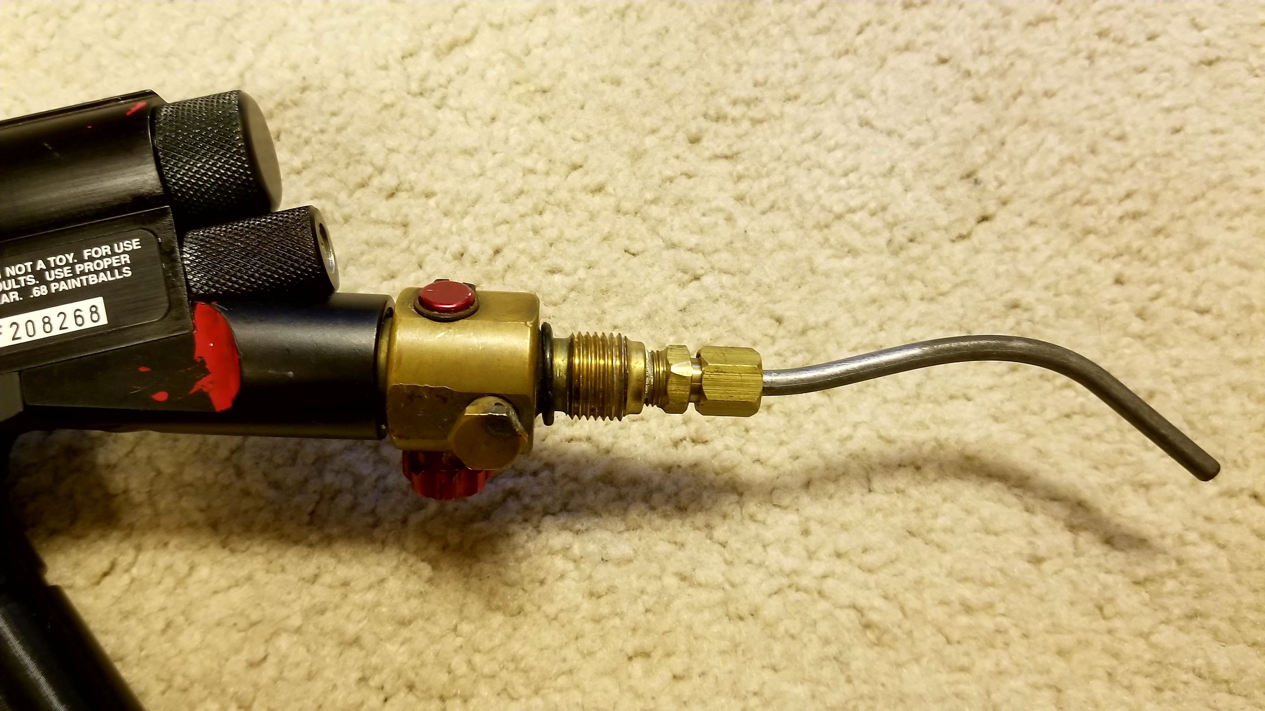

                    Here is a hardline syphon example on a Smart Parts on/off valve that I havent installed yet, for reference. Myrkul has done several like this.

                        In the old days, we would use a compression fitting, some microline (NOT lpr tubing), and another compression fitting at the end to serve as a weight, sometimes we would put an oring around it to minimize the clinking. Some guys would use thin copper tubing, which would flex a little, and clink a little less. I must have made hundreds of these.
                        When vert tanks became the "trend" in the early 90s, many of us switched to a straight pipe. No clinks, and no chance of the microline breaking. I still mostly run vert tanks on my guns with a stock.
                        Like some said, running an inverted anti-siphon is an option. Companies like Palmers used to sell "tank shims", so that you could run anti-siphon in the summer, and siphon in the winter. I actually bought some of those shims when I got the CooperT 45 adapter, and found out that it didnt point the right direction! lol
                        To make your own, you can get the fittings at any hardware store. But I don't know if they would have the suitable 5/32 microline from Nylon 6 or 12. Palmers used to sell it. 3/16" would also work, but I don't see it on the site anymore.
                        Get a pinvalve without the groove. It also needs to have internal threads. Also, you want a Tippmann style valve, not Schcrader. Torque to 40lbs, and NEVER use any locktite.
