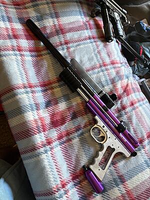

    Looking for a single trigger frame for an MR1 project. No idea what fits what.
    Show me what cha got!

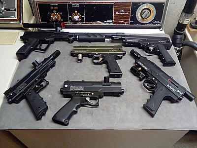

      Since you like to tinker with MR1,(me too) thought i'd show you my little collection. the center and the 2 on the right are BLAST frames. front and center is a kingman/Spyder frame and bottom left is a RAS frame,(a canadian built spyder clone) If you come across a BLAST frame NOS, you'll need to put internals in it. Triggers can be found at I&I Sports if they still have inventory. Also look at the paintball pistols(G1,G2,ZUES...) All Spyder type clones.

        I got my millenium frame and trigger from blast legacy/oregonpaintball

          It’s not a CCM kit but feels good to use. The included 3d printed hammer works great, but I got an Azodin metal slotted hammer for longevity

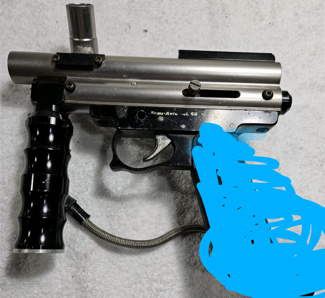

        Want this thing? It's currently in my scrap bin....
          Like... the whole thing or just the frame? I'd be interested. I'll pm ya

            Whole thing
          Duuuuuude. This is awesome. I'm thinking I might make mine a pump. Gotta figure out the mechanics of that. But dang if that image isn't awesome inspiration...

            All this started when i wanted a pistol and couldn't lay my hands on a Zues,so figured i'd build my own, MR1'S were plentiful and cheap,some were free just pay shipping.(Frames wer reasonably priced at the time). finally completed an MR1 in pistol congiration,minus a springfeed tube,but that's a work in project. Since this was started i know have 5 Zues pistols and these.Go figure!,but it's the MCB Way! Good luck with your build.
