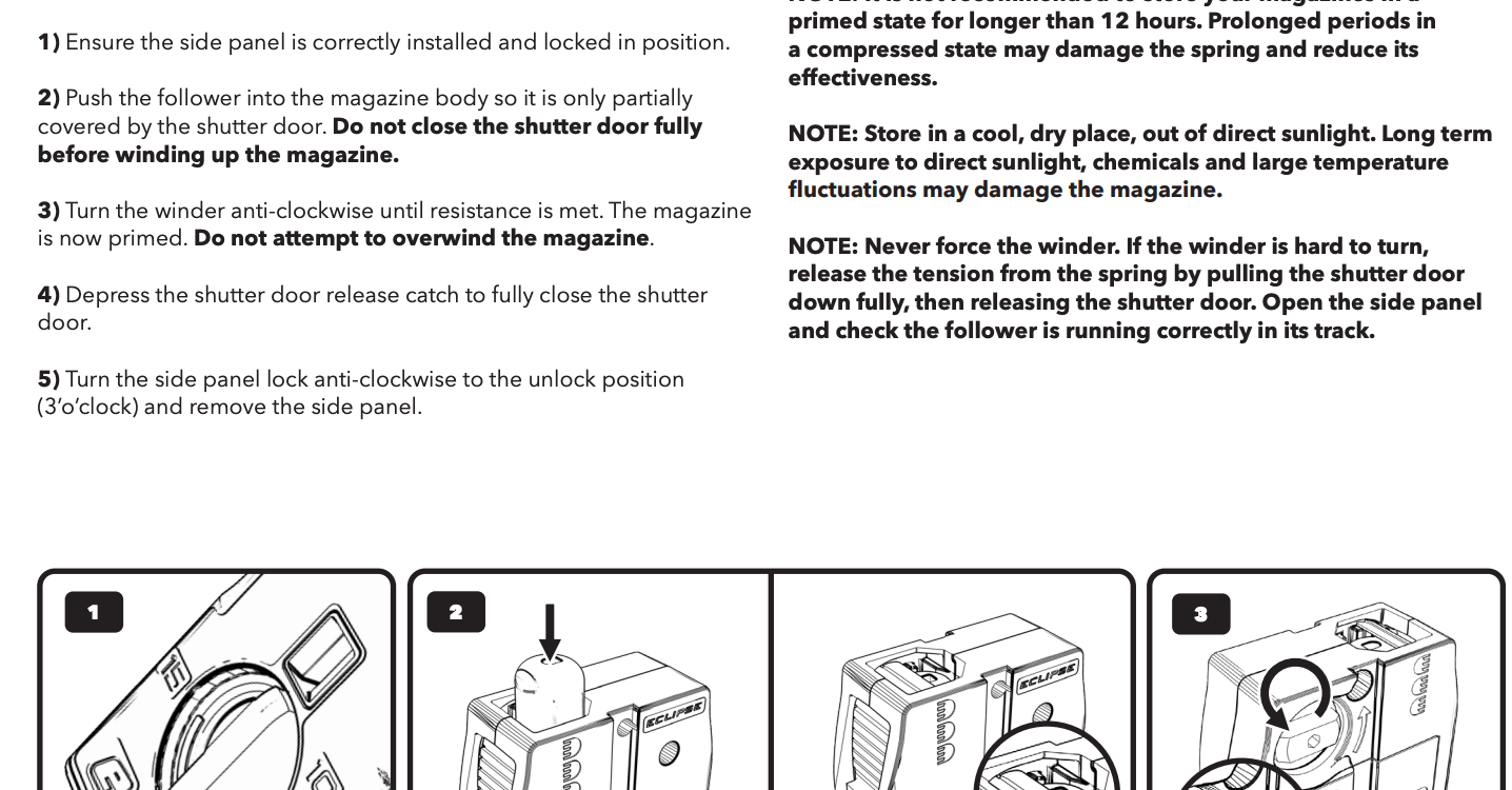

              I realize you said it's "not absolutely necessary", but it's actually better/easier to have the dust cover open with the follower pushed in before you wind. This is because you won't be winding against the spring pressure of the dust cover with the dust cover open.

                Are you winding with your fingers or something? I use an Allen wrench, I can't tell any difference when winding with the door open or closed, the follower is only about a half inch different location, it's not like that generates a ton of spring pressure or anything

                  I use a wrench. It's noticeably different on my CF20 mags. I can still wind it, but it's definitely more resistance. Take a look at the gray follower release on the side of the magazine, and you'll see how it interacts with the dust cover (shutter) when closed. The gray follower release moves more freely with the dust cover open. Here's an excerpt from the manual, specifically in #2.

                    Yeah I've never had any problems. Maybe my followers were not all the way up? Idk. It's never seemed difficult. Not like we are compressing car suspension springs here or anything

                      But it's bold, so that's means it's non-negotiable...
