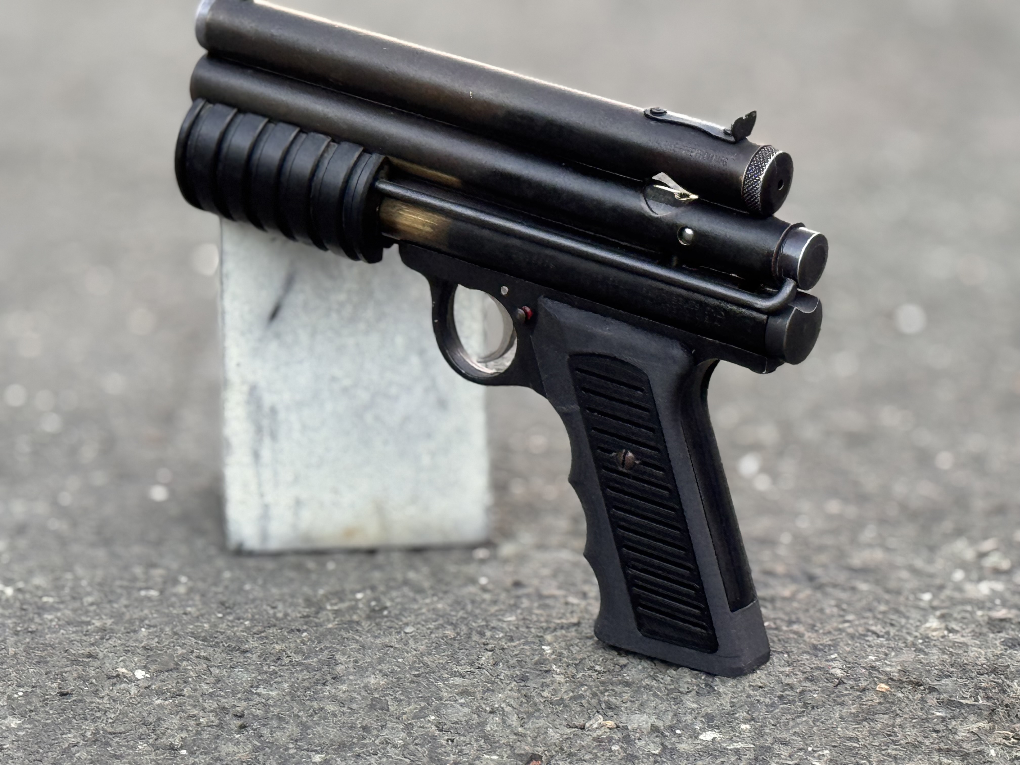

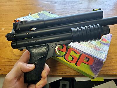

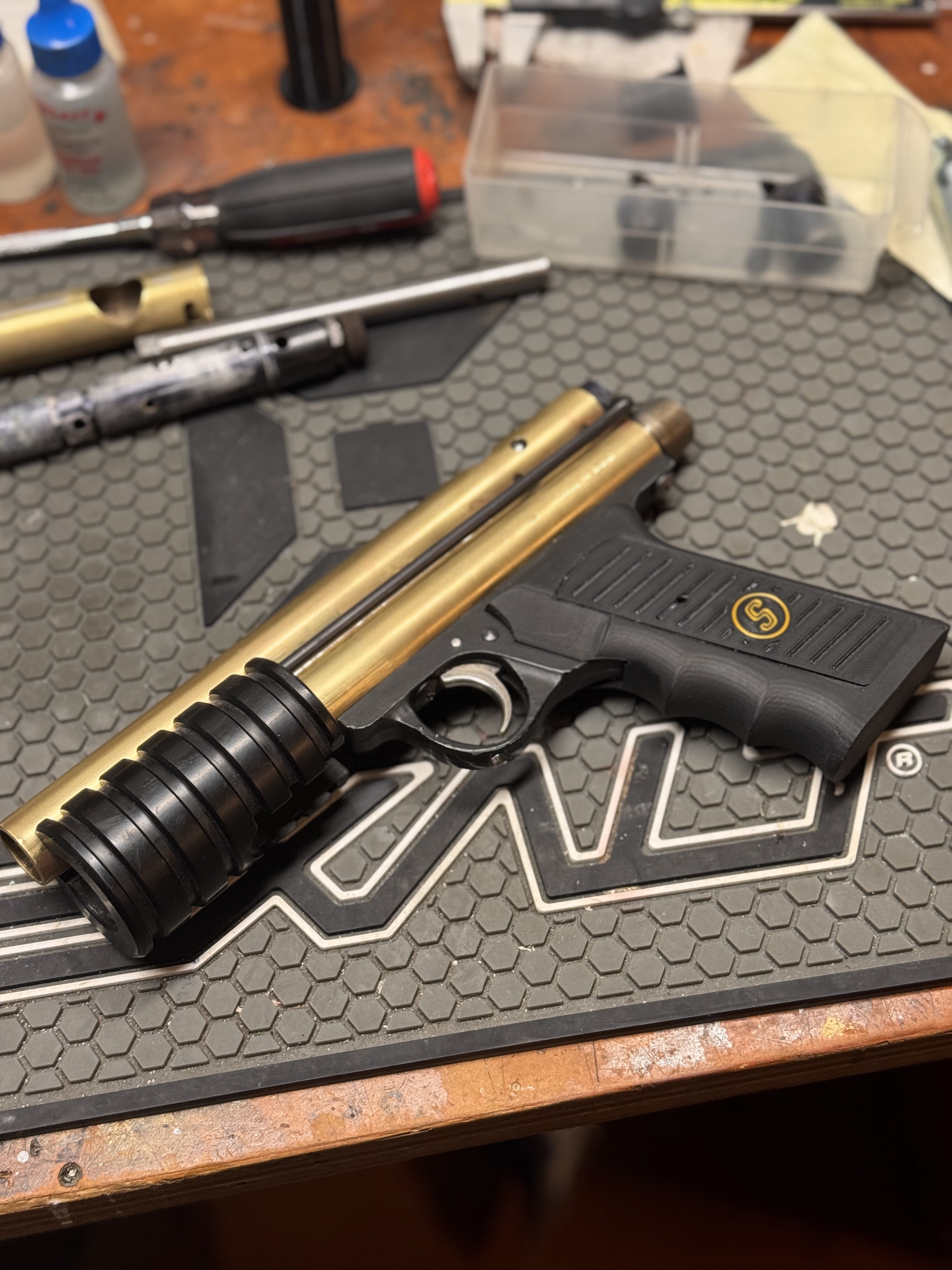

        I'll throw my hat into the ring to do your PGP upgrade. I would not freak bore it - your basically building a new gun and adding a ton of weight. What I can do is wedgits - 2 without de-soldering, 3 if I take it apart. can also do a palmers style valve job to get more consistent velocity above 260 or so, pad the bolt, and provide you with a really comfy 3d printed grip that i sell here. here are couple photos of my work. I can strip the stupid black paint and go brass or patina in a nice Black similar to the earlier PGP's. I Will dig out my more recent one and take pics. It makes the PGP a totally usable and super fun marker to play with instead of a pile of frustration! highly recommend RVA, quick change and spring kit from PGP junkies to really round it all out. PM me for pricing and options.

        • Cal440
          Cal440 commented
          That is a nice looking sleeper right there 👌
        • Swedgin!!
          Swedgin!! commented
          That grip is comfortable for my alien fingers 👍🏼
