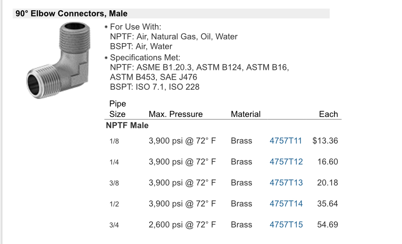

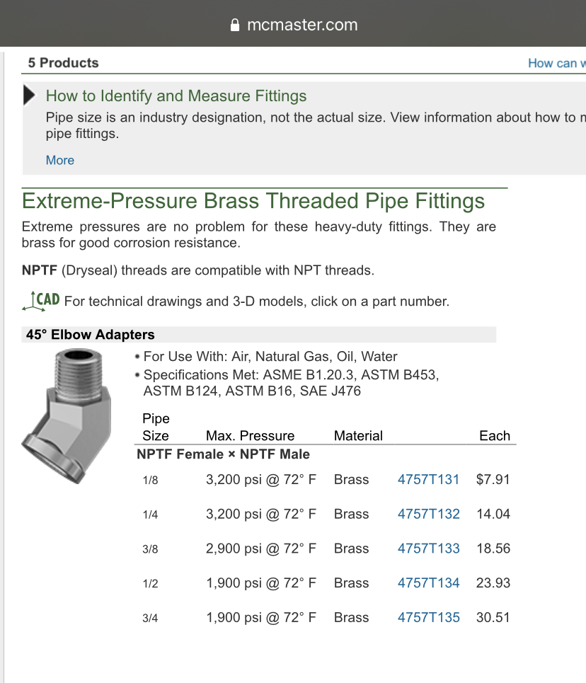

        I would like to see a nice clean 45* and 90* for coated braided line. I want something to replace the Macro and fittings on my Stock Class CCM setup for 12g play. But I don’t want to go with the bulky over sized brass fittings to do it. I thought about cutting some down to clean them up but I don’t know how safe that would be.
        These seem to be the cleanest ones I can find. Maybe if I polish the brass up a bit. But I wish I could find smithing a lil nicer maybe something I could anodize.
        Swivel would be cool but I don’t really see it necessary braided hose isn’t all that flexible and I would not want the braided hose rubbing on anodized surfaces anyway. That’s why I like the coated stuff.
        Found a 45* swivel comes in stainless to.
