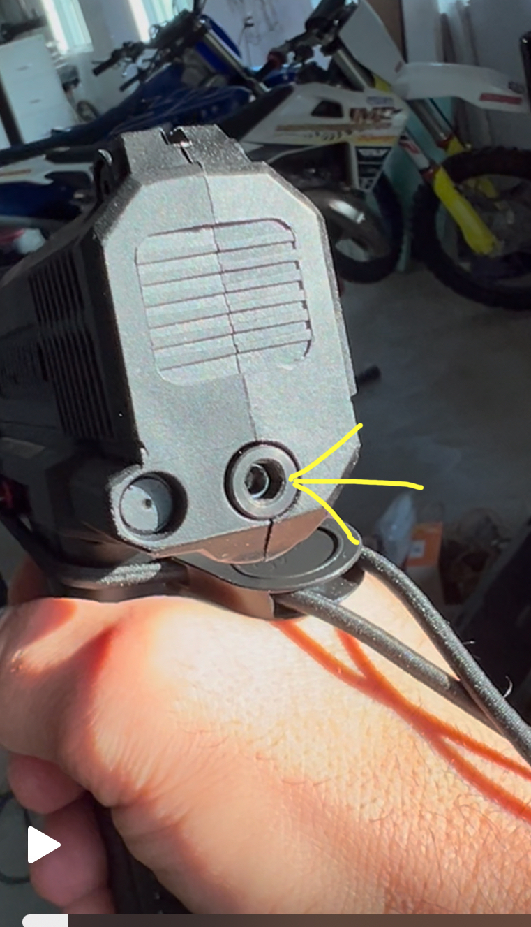

        After the 12g is punctured it vents through the regulator but not if you hold down the trigger. Sorry I couldn’t get a video

          Are there 2 screws in that area or 1? Older markers had 2 (1 inside the other) which let you adjust when it bleeds excess pressure for safety. There are YouTube videos on how to make that adjustment. People were messing it up though, so they went to a fixed pressure relief with one screw.
          • Theeightiesman
            Theeightiesman commented
            There are 2 screws the velocity adj. screw and the regulator screw inside it. Adjustment of the regulator screw does not seem to change it as shown in YouTube vids.
        • NormG
          • Mar 2021
          • 30
          There is a pressure vent inside that adjustment screw. It will vent if the regulator is cranked too high. Depending on what it's chrono'd at, it could be working exactly as intended.

        • nak81783
          Last of the Salzburg Clan
          • 592
          • DeWitt, MI
          Did you get an o-ring kit yet? Order the top two items linked below, and it should cover all the seals in the marker.
          https://tippmannparts.com/collection...pmann-tipx-tpx
          https://tippmannparts.com/collection...ure-valve-seal
          You've got an older regulator. I'd call tippmannparts.com to ensure the linked part below has the newer, fixed pressure relief parts in it. Even the latest manuals still show the adjustable pressure relief; Tippmann never updated the manual. It's a more expensive part, but I don't see the individual bits for sale. Having the fixed pressure relief will take one thing out of the equation.
