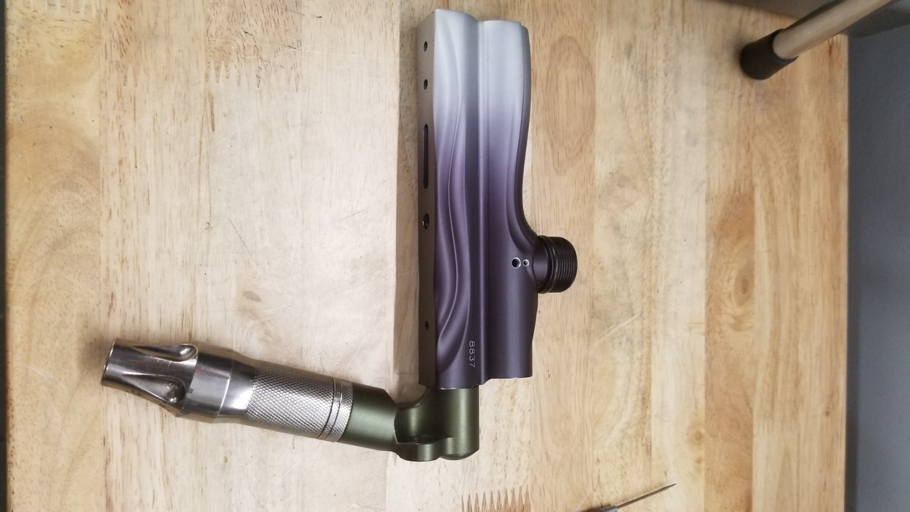

    I sent a drilled mini body to CMN Fabrication and Design on Facebook to make a fitting that locates the front block and uses a standard banjo bolt to attach everything too. Chris over there also does custom brass parts for you sick individuals...
    Brandon Mcall or McCall (sorry Brandon) at BMC Fabrication up in Oregon also on Facebook did the window cuts between the tubes on the body pictured. He also bored a barrel for me.

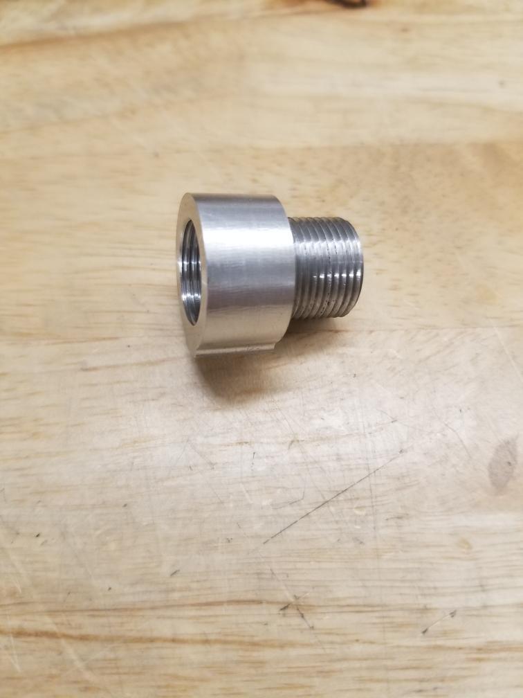

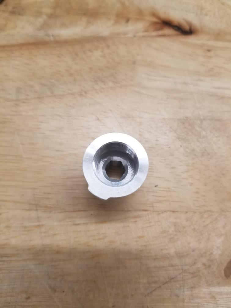

    FINALLY DONE!!! Everything gets shipped back to me this week from CMN!!! Here’s the custom fitting Chris made to interface a Karni front block to a mini Orracle, plus a few minor body and bolt mods. Now I have to make a custom length pump arm and Cerakote everything to make it pretty. Follow up soon!

      I like how the custom adapter is indexed/keyed... don't know if the bodies it is emulating are also indexed like that, and I don't really care... the fact that an index feature is incorporated into the adapter makes me smile. The countersink around the hex is a professional touch, good to see it's there. Spacing/fit to the body looks tight and square/true to the bore... at least as far as it appears in that picture.

        Yes, the stock bodies are indexed. The threads on this fitting were timed so the fitting is clocked. I’ll have to use some thread lock, but from what Chris said it will be a solid hold. There was a good discussion and some ideas passed around in the last forum on how to tackle this. Unanimous decision was to make the fitting, which worked out since I needed some other modifications done to bodies and a couple bolts.

            I’ll do my best. ‘05 Pro/Superstock/BM, Karnis and Resurrections have a different interface for mounting the front blocks, and has an indexing nub to prevent rotating while keeping everything true. I had a machinist make a fitting that replicates the interface needed to adapt a Karni front block to a standard 2k body. The male threads for this fitting had to be specifically cut for this body so when it bottoms out, the indexing nub will be in the proper place so the front block is squared for a secure fit and proper orientation. Without the nub, the front block will freely rotate.
            If that isn’t as clear as mud, I’ll have to resort to pictures. I’m horrible at explaining things through a keyboard. Anyone interested should chime in too. Toss in ideas and criticisms for this project. This isn’t an exclusive build thread. I’m still in the process of brainstorming the next step.

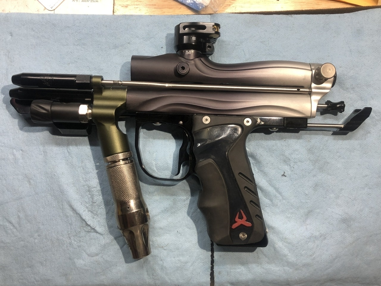

                  Ok folks, got everything back from CMN! Here’s a mock-up or whatever you call it. I may not use the volume chamber, we’ll see if the crooked cocking solenoid will piss me off. If this were mid-blocked it would be a tight setup.

ID:	41706 Now I have to make or cut down a full-size pump arm, then shape the body a little bit to match the Karni block, and then Cerakote.

                    It’s going to look epic once done! You figure out what color your going with?
                    • Knuckle Dragger
                      Necropost enthusiast
                      • 567
                      I’m thinking black to grey fade. Not really sure, I have 5 colors to work with.
