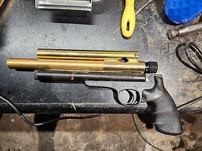

    Originally posted by KMDPB
    Wow that's incredible!!! Does the hammer strike the valve stem or is it decorative with a sear dropped hammer in the tube? Also how will the bolt be reciprocated? Connected to the hammer? Manual? Blowback? Looks great!
    It's basically a broken blow-back. Bolt and hammer are pinned together and actuated by the thumb lever. The whole assembly is held back by a sear and it fires from an open bolt.

      I would put a reverse feed on it so it’s rock back barrel up cowboy style. Like a cool brass cram and jam. You could run cut down 10 rounders like a 6 shooter.
      • Rusty Brass
        Rusty Brass commented
        It'll be a rock back feed... If you take out the follower and spring When you cock the thing the natural tendency, mine anyway, is to let the nose dip when you reach for the hammer. I think the springfeed will be the way to go. I want to make using these things as effortless as possible.

        #20
        Which crosman valve are you using? I've wondered if the valves for the 2240 etc could flow enough to fire a paintball at a useable velocity.
        • Rusty Brass
          Yup, it's a 2240 valve. I bored out the transfer port but it probably wasn't necessary. The valve is about the same size as a standard Sheridan valve, should work fine.

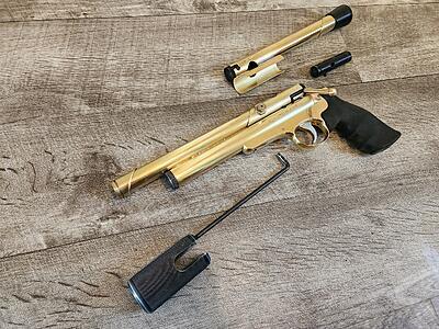

                      I'm still haunted by the siren song of a single action .68
                      JeeperCreeper has a clip-on feed tube that he developed for his single shot brass (see pics and thread https://www.mcarterbrown.com/forum/p...s-brass-thread ) It seems like that could be a solid spring-feed design.

                          JeepDVLZ45 was working on a modified Sergison K frame version similar to this that is looking really promising. But I know he’s been super busy with work lately. Not sure how much progress he has made on it. He’s got a functional prototype though. It’s really cool and looks Sick!
                            JeepDVLZ45 commented
                            I’m trying! Progress is real slow, but it’s getting there. Learning my mistakes as I go 🤣
