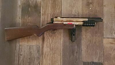

                Well that went in a totally different direction...
                It started as a crusty P68 Magnum, wound up a freak bored carbon fibre Franken-launcher...

                  Looks cool, nice job 👍

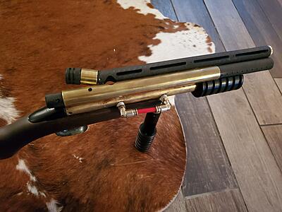

                  Ho, and is that a slam changer?

                    Thanks mate.
                    Yep, the ol' WGP pump changer. (second pic)
                    Was playing Dress-up with different configurations. Works nice with a remote hpa as well.

                      Nice and compact, looks wieldy with the stock

                    Had it out yesterday, very light and flickable. Really dig the left side feed tube, being a lefty, it's a much more natural roll of the wrist to load.
                    The efficiency sucks on 12grams, but there's a fair amount of piping it runs through. I've got banjo bolts en route, those elbows sticking way out the side were all I had on hand.
                    Anybody have any tips on improving efficiency at the valve? I see Palmers does a tuned valve for co2, do they work?
